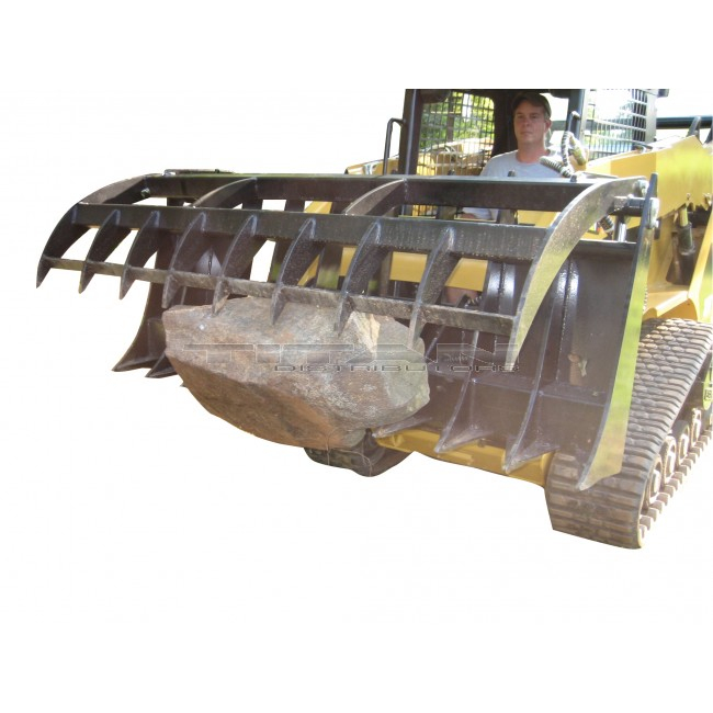

When you say "rake grapple" are you referring to one like this?

The fundamental problem with rake grapples stems from the length of the lower tines in my opinion. If you are going to carry debris with the grapple, you need to get under the load. While the guy in this picture from Titan's website picked up this boulder, it is NOT easy to do. I have that same grapple and an L bottom and the time it takes me to move a pile or grab some wood and haul it does not even compare, the L bottom is much better. On the other hand if I want to tidy up and back rake, the L bottom doesn't compare, the rake is better. Picking up some items with my rake is like trying to cut something with those blunt end kids scissors, it just keeps popping out.
Oosik's rake grapple has somewhat longer lower teeth and is serrated on the tips which would help a lot. The grapple TXDon posted a picture of is sort of a hybrid, more L type.
If I want a pinch of salt, I position my fingers like a rake grapple, if I want to pick up a big sack of salt, I position my fingers like an L grapple and get under the load.
