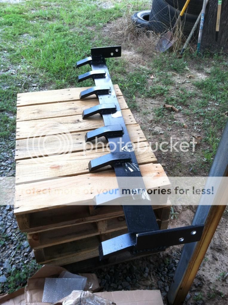

look what came while I was in town.............
weight 66#....3/4" steel teeth.....yankee warehouse....less than $300.....about 8 day turn around, not to bad....these folks seem like real good people....
next week will be fun...

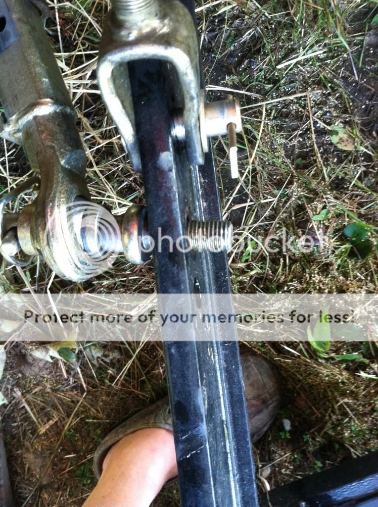

this is what happened yesterday.......
in stock at NAPA....$1.53.....go figure...I didn't check everything....lol....added locktite blue.........so far so good.....

Exact same thing happened to me the first year I had my DongFeng. I was able to find the nut in the yard, the washer was long gone. I put it back together (don't remember if I used loctite or not) and it has not happened since.
Seems like the first year bolts were coming loose all over the tractor and I tightened everything as soon as I got it. After that it seems to have stopped and everything just stays tight.

I put a bottle of loctite in my tool box. Whenever a nut comes loose I put a drop on when I tighten it. Like Cleat, I had a lot of loose nuts at first, now hardly any.
I also have gotten into the habit of using a torque wrench and in my toolbox I keep a chart of recommended maximum torques, available here:
US & Metric Bolt Torque by Grade
Bolts that I have torqued don't seem to rattle off, which leads me to believe they don't torque them at the factory. On a new tractor it might be worth going around with a torque wrench and torquing every bolt you can.

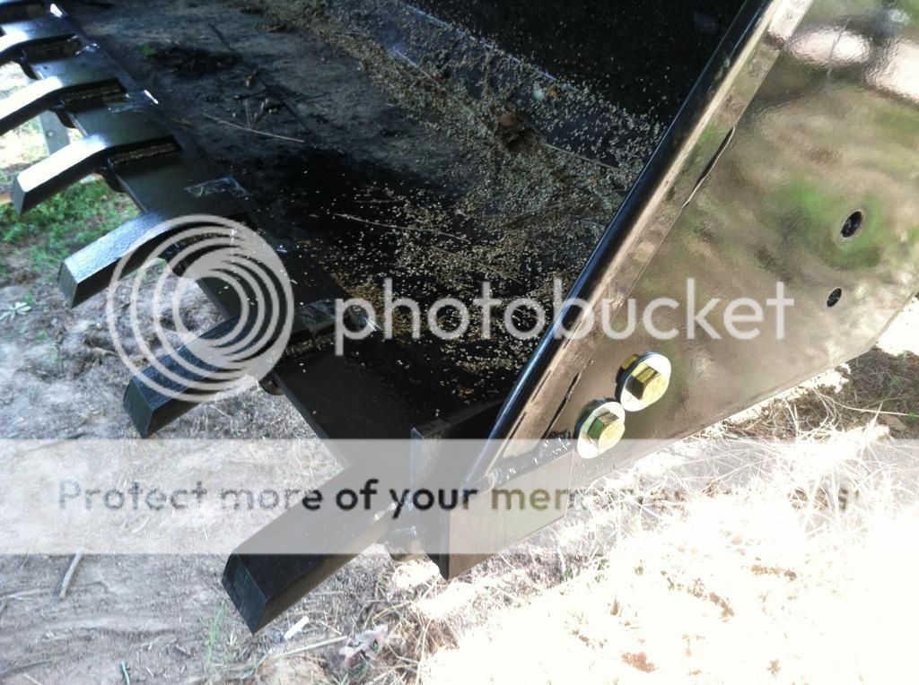

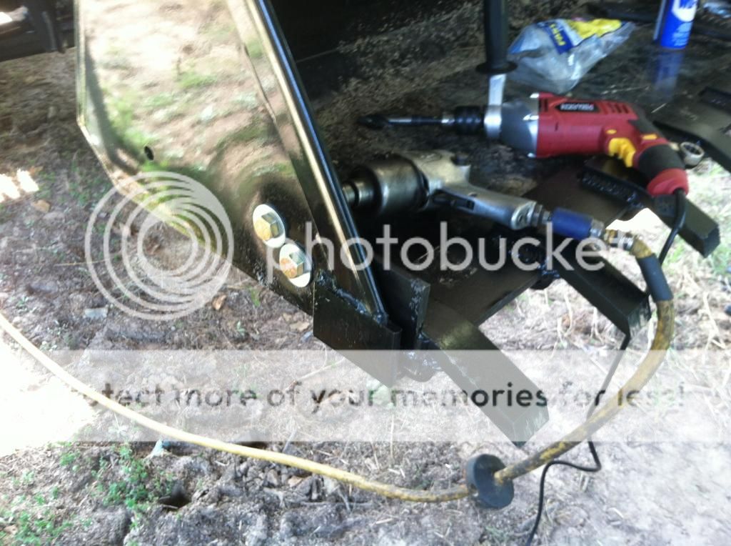

now the tooth bar....about 45 min.....had to work a bit to get the fit I wanted.....grade 8 bolts with Loctite...
RIGHT SIDE......
LEFT SIDE.
COMPLETE.........
