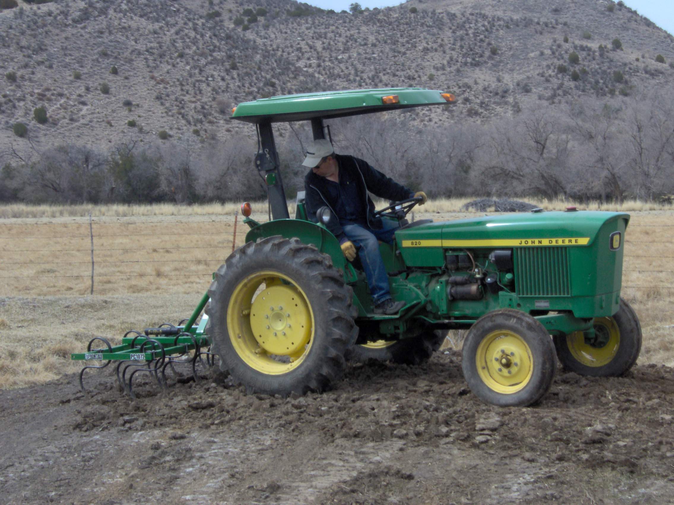

For what you will need I would suggest a larger older tractor. An example would be something similar to my Deere 820, it has around 1700 hours on it, 31 pto hp 3cyl diesel and two wheel drive. No issues with the pto either. I have seen these priced from $4000 to $8000 and think one such as mine is worth about $6000. So that would leave some change for a few attachments in your budget.
