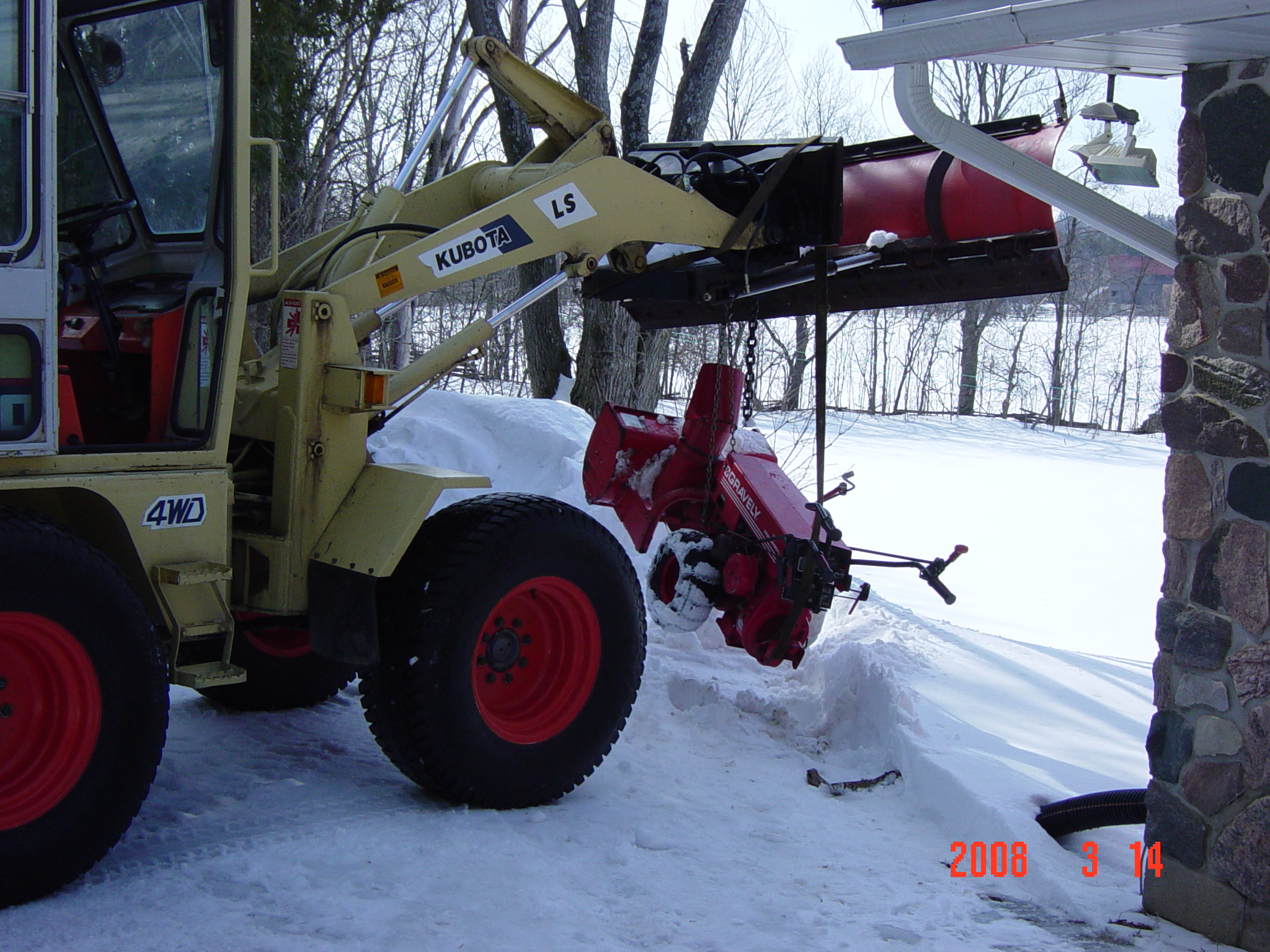

   / Non differential walk behinds? #7
At times like this, I would have loved a solid axle, better yet, def lock!
