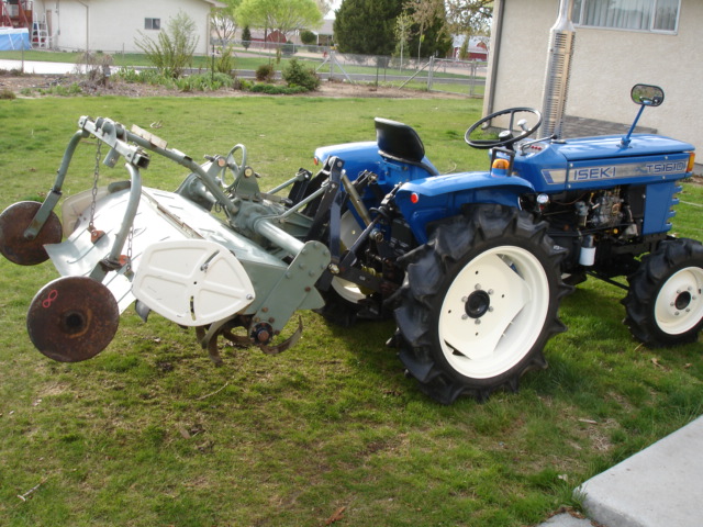

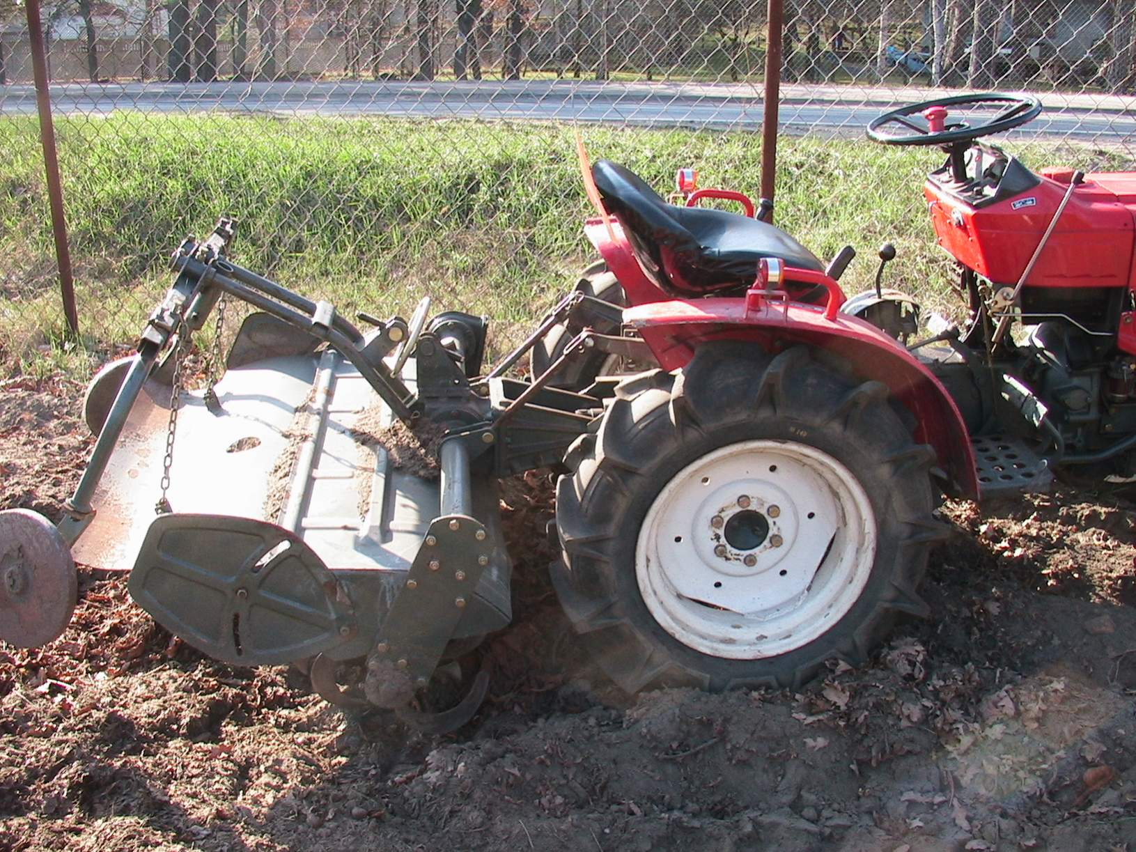

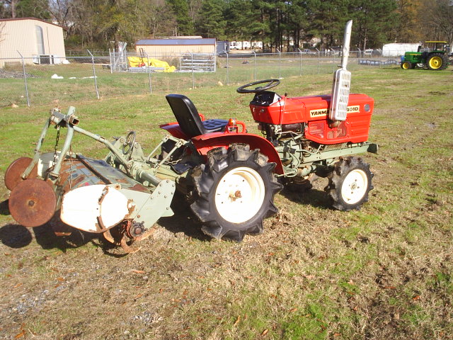

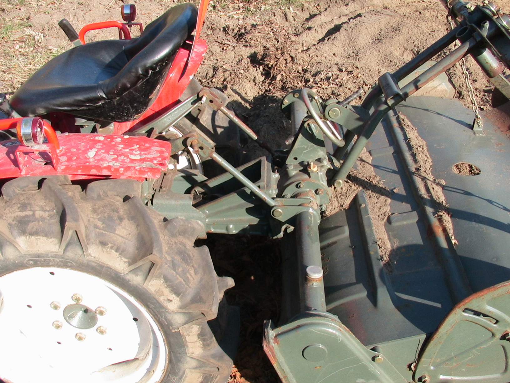

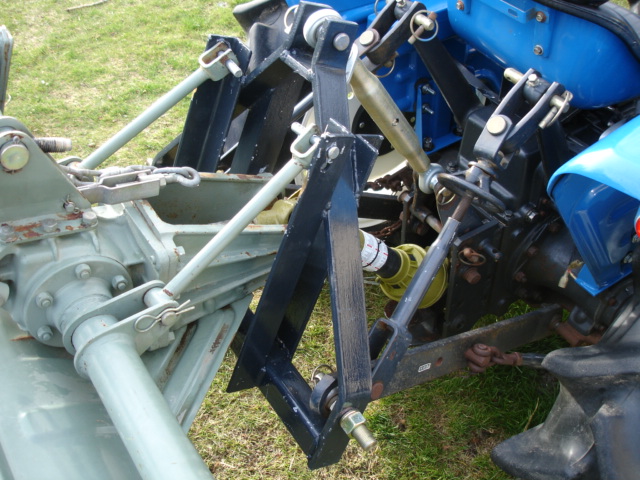

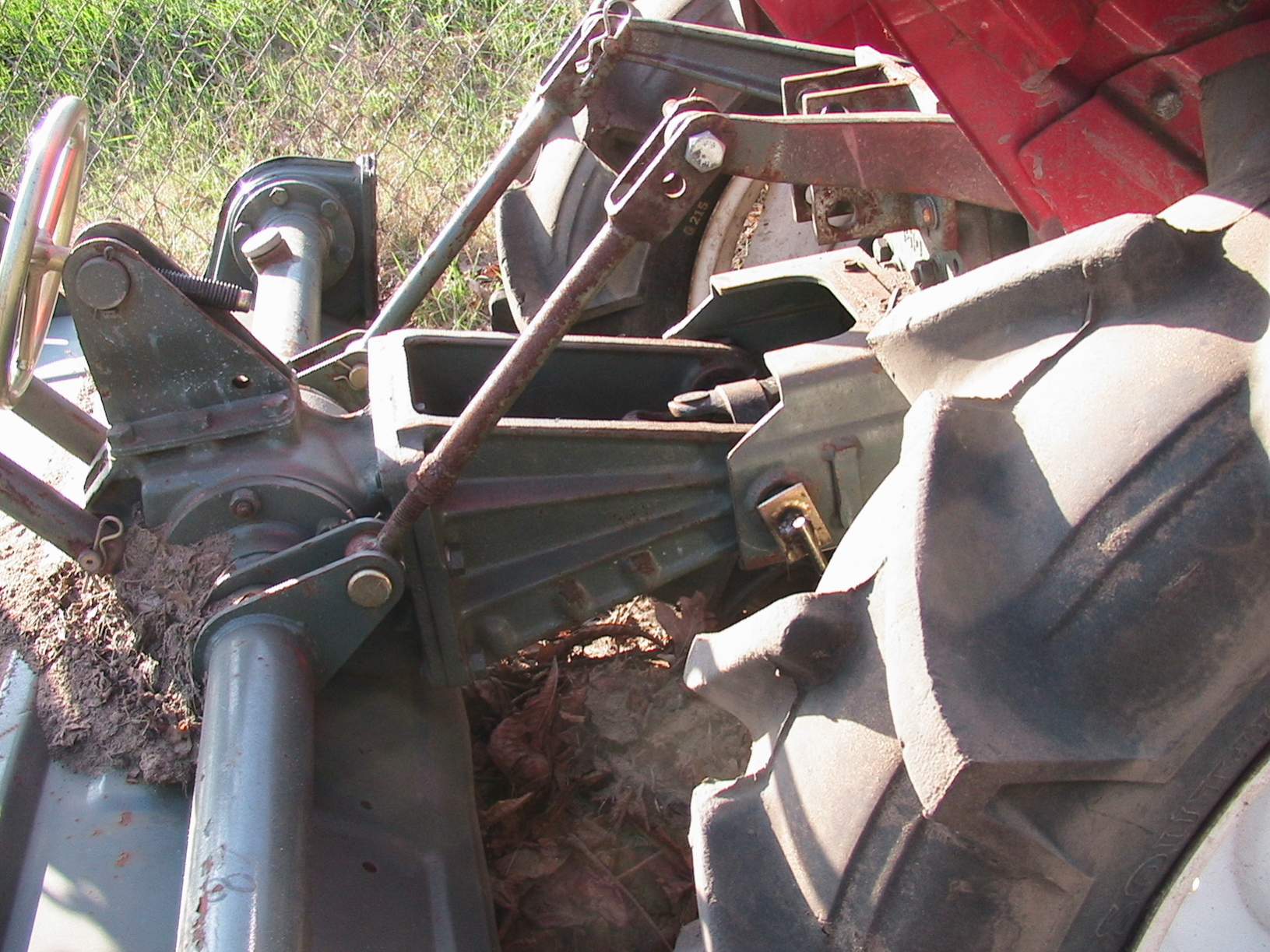

Here's a couple pics I had on hand showing a small Yanmar W/ 2-pt tiller. Maybe you can see it pivots on the main pins on each side of the drive shaft, which is always at the same height above the ground surface. A 3-pt moves the whole tiller in an arc up and down relative to the tractor. I also attach my method of converting a 2-pt to 3-pt tiller on my tractor that I've shown here before. No modifying the tiller, just adding in a triangle adapter. Maybe the only issue I have with this is it puts the tiller back away from the tractor a couple more inches than I like but it does the job. Just takes up a little more room in my over-crowded storage shed.:D

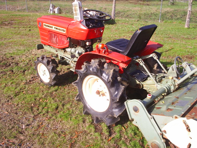

On my YM 1510D the YM1202 mount linkage keeps the tiller very close to the rear wheels. I have seen conversions that use a very short non-adjustable top link and an extended connection point for the top link so that the tiller swings up in an arc similar to the original. The result is that the drive line does maintains a more reasonable angle. I included some pics of my tiller and linkage.

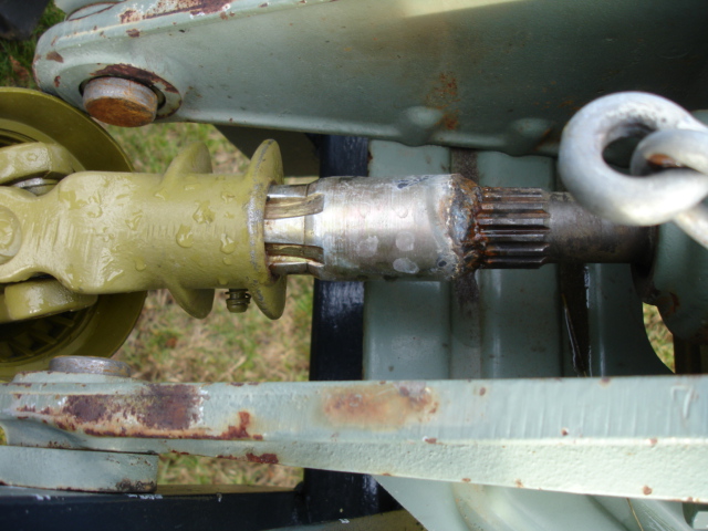

lars your conversion is very interesting. What did you do for the drive shaft connection on the tiller?

On the driveshaft connection, of course the tractor has a std. 1-3/8" 6-spline connection, and in this case the tiller had a smaller metric, approx. 30MM 16-spline connection. So, I bought a PTO slip-on adapter, 1-3/8" 6-spline x 1-1/8" (can't remember the splines, same as on an 8N?), and had our machine shop bore it to 30MM I.D., then had it welded on the tiller shaft. Here's a pic.
Any concerns about having to service the input shaft seal or bearings with the larger shaft welded on the end?
   / Non 3pt tiller to 3pt mount conversion #16
LOL! I suppose if it starts leaking I'll definitely have some concerns. :eek: I guess I would have my welder guy blow off the weld and remove the adapter, then grind off the rough remnants to slip a new seal over when and if that happens. I could have modified the matching stub drive shaft end (that came with the tiller) and weld it onto the drive shaft somehow. The problem is there's no detent in the tiller's 16-spline input shaft end to keep the drive shaft from slipping off the tiller as it's lowered. That of course is because the shaft doesn't lengthen or collapse with a 2-pt setup, being that it pivots at one point, so it's not needed in that case. I'll admit it's not a perfect world when adapting the two types together and some compromise has to be made, but I bought the tiller for $250 plus about $60 shipping from OK to CO, so I'm willing to deal with the small stuff for the difference in cost of a newer one. This Yanmar 1200 tiller is designed for lighter rice paddy type work but it's still well made. I use it in my garden area and a neighbor's big garden, as well as along the front of the house by the road where it gets hard packed with plenty of rocks/gravel buried in it. So far haven't broke a tine...keeping my fingers crossed. Here's a video showing it jumping around a bit by the road...you can hear some of the rocks in there.
