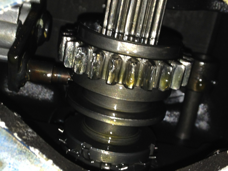

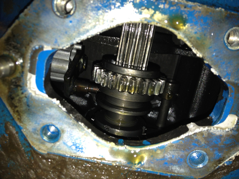

Hello everyone. New to the forum.
I have a ford 1720 SSS and when I pull up the lever to engage the four wheel drive I get a lot of trans noise - very loud in 4th gear-high range and not normal. The noise gets louder the faster I go. Full speed the trans sound like it screaming at me.
When I switch to medium or low range the noise seems to stop - or maybe its there but not noticeable.
When I switch back to 2wd it goes away and sounds normal.
Any idea where the problem might be?

Did anyone look at the front driveshaft cover? They sometimes get bent and contact the driveshaft. The shaft still turns in 2wd but might flex differently when not driving the wheels? Swag

UPDATE: Discovered that the slide gear on the pinion was damaged. Replacing the slide gear Fixed the problem. No more noise when in 4wd.
   / Noisy Transmission ford 1720 SSS #8
Fantastic! I was also going to comment on the fluid. Looks rather thick - not supposed to be gear oil!
