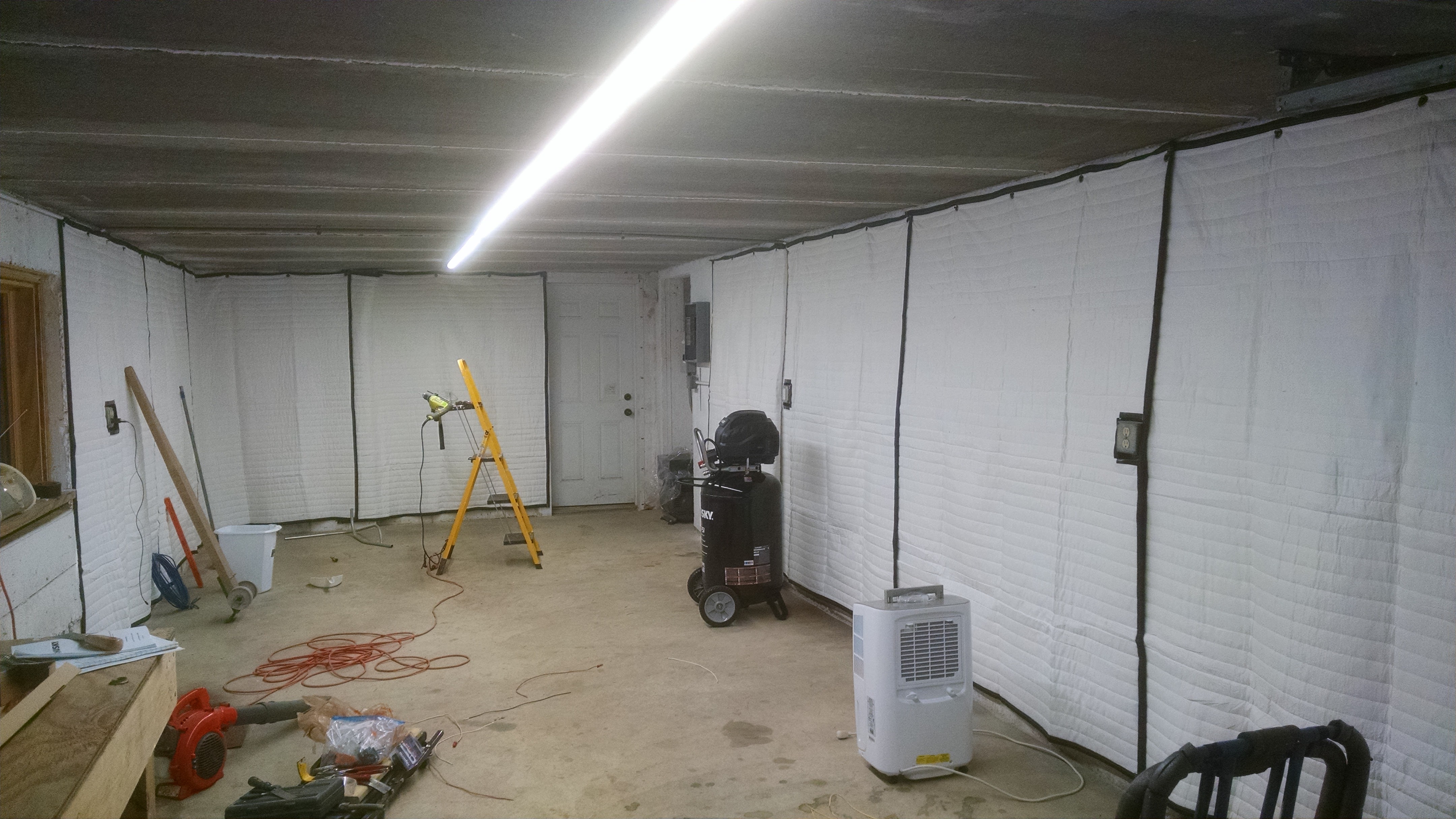

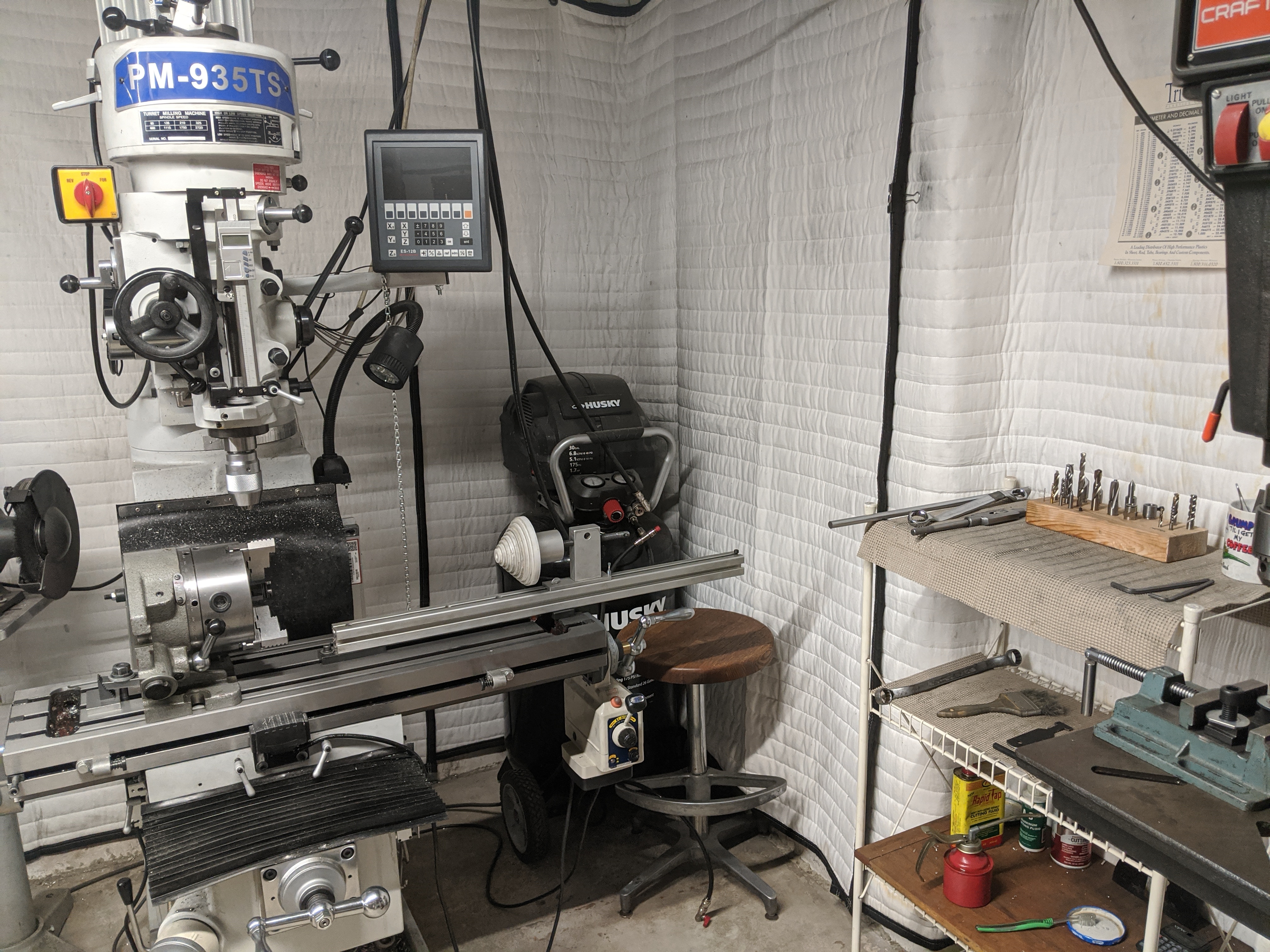

Dragoneggs, like I was telling you in the other thread, the acoustic blankets. Here's the ones I bought: Acoustic Sound Blankets Producer's Choice: Size 8" x 8" - VocalBoothToGo.com
My shop is a long 1-car garage, concrete everything including ceiling. Before I put my shop in there, it was a virtual echo chamber, so I knew running machinery in there would be ridiculously annoying. So I looked up what people where doing, and somebody mentioned these blankets.
Here's me hanging them and installing the overhead led lights:
I have a husky 30 gallon compressor tucked away in the corner.
It gets a little loud, but not too bad...the blankets absorb a whole lot of noise. If the compressor bothered me more, I would just build a quick frame around it, and line it with the same blankets.

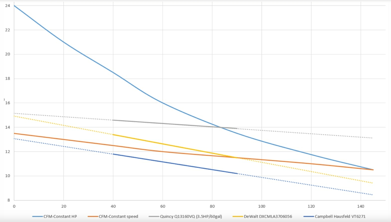

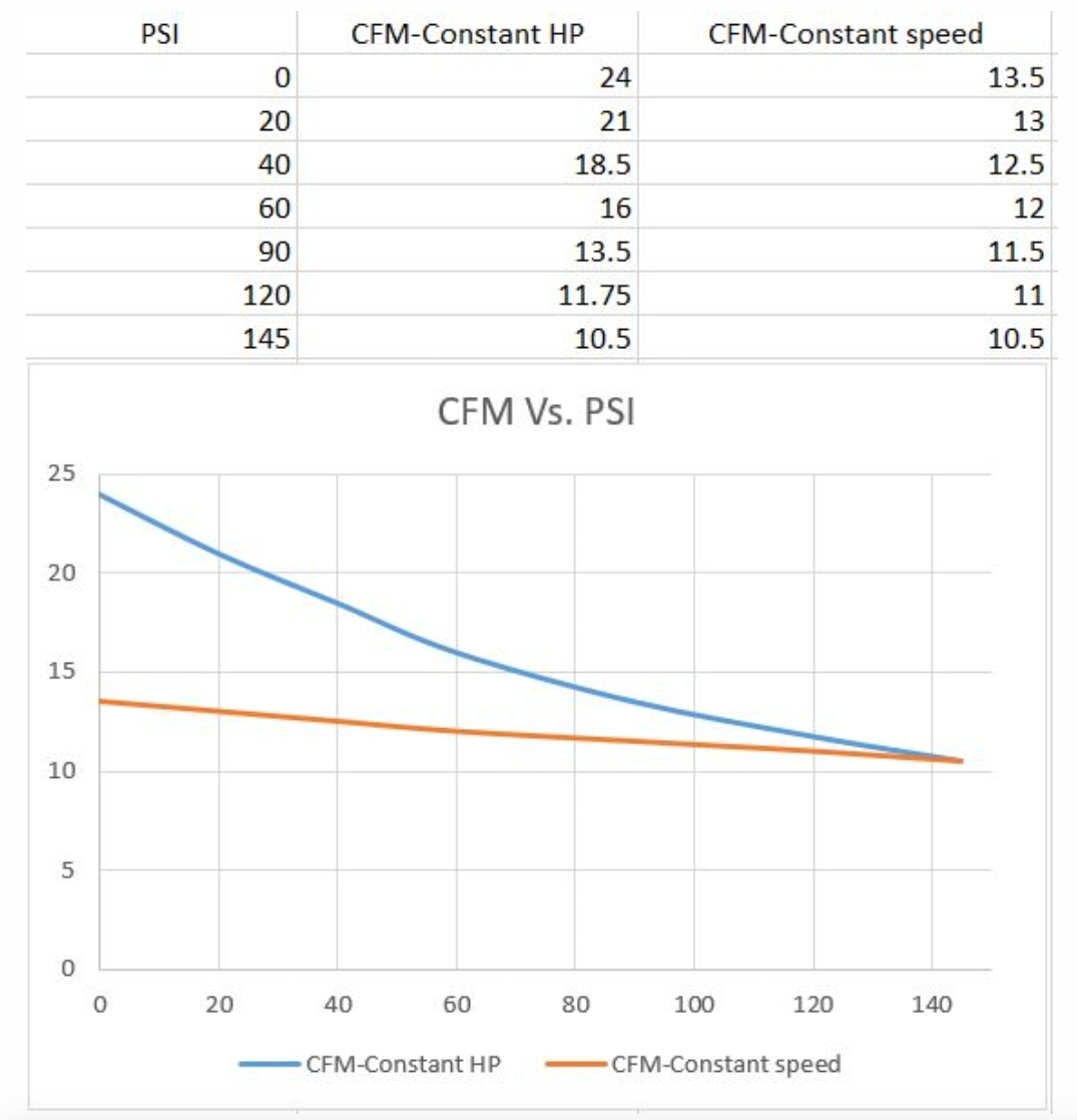

I started reading this thread, got to page 8 and saw I have 10 more to go. I'm on a lunch break and don't have time to get caught up, but I thought I would share my work. I'm in the middle of building a custom compressor because I couldn't find anything on the market that met my wants. I want: very quiet, very fast charge-up, clean & dry air, and good efficiency.
This isn't within the scope of quieting the compressor but it's my main feature and worth talking about. My compressor (at startup) runs in constant horsepower mode, rather than constant speed mode. A typical compressor runs at a fixed speed, and as horsepower is a function of speed (RPM/CFM) and torque (FT*LBS/PSI) doesn't reach its nameplate horsepower spec until right before it shuts off from the pressure switch. Mine when you switch it on goes to double speed and stays there until pressure climbs enough that it reaches the 3HP mark. Then it gradually slows as pressure builds, and right before the pressure switch trips is when the RPMs finally come down to normal 3HP motor speeds. So in the 0-40psi range my 3HP compressor is moving more air than a typical 7.5HP compressor. This allows me to charge my tank much faster than I should be able to. Here's the graph of my compressor in constant HP mode vs constant speed mode (like a typical compressor).
And here's a graph of it against a handful of comparable 3HP and 5HP compressors.
I achieve this using a 5HP harbor freight compressor head, a 3HP 3-phase motor, and a VFD.
