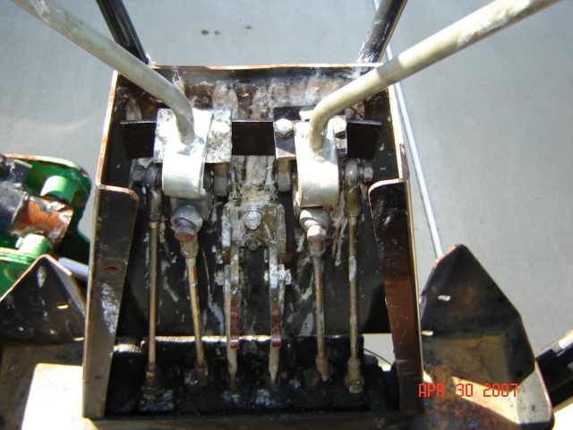

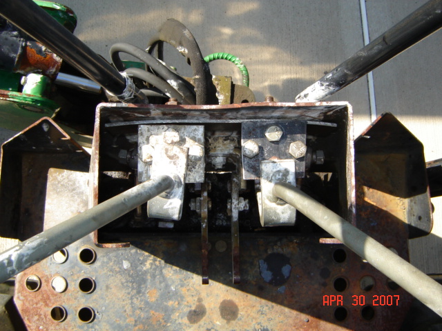

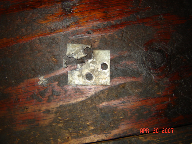

Digging 6 holes today for trees being delivered tomorrow. As the digging progressed, control of the far end of the back hoe & bucket became more difficult. I finally looked at the lever controls & found this (first pic), supposed to look like this (second pic). After removal (3rd pic). :eek:

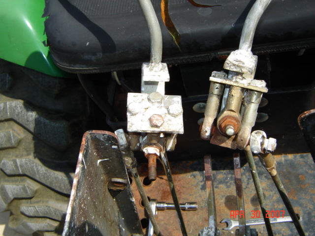

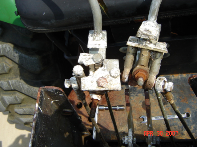

Being that scrap steel is pretty slim pickings here, I ended up cutting up a short piece of 2.25" square tube from an engine hoist leg I replaced a couple years ago. Used more of the same to reinforce the plate the grab handle & controls mount to.
After cutting & drilling the control plate & installing the stiffener plate behind the grab handle (4th & 5th pic), all was well again! I LOVE digging in the dirt! :D
