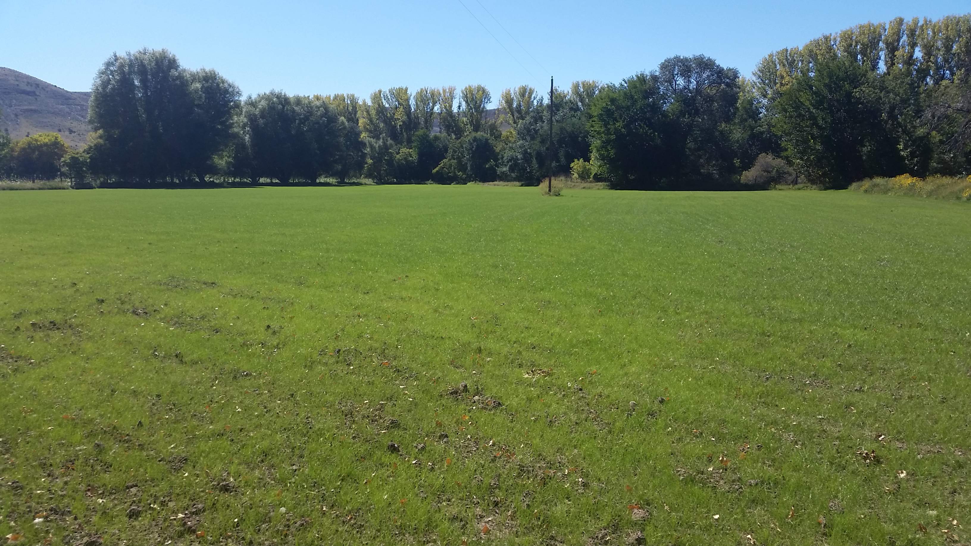

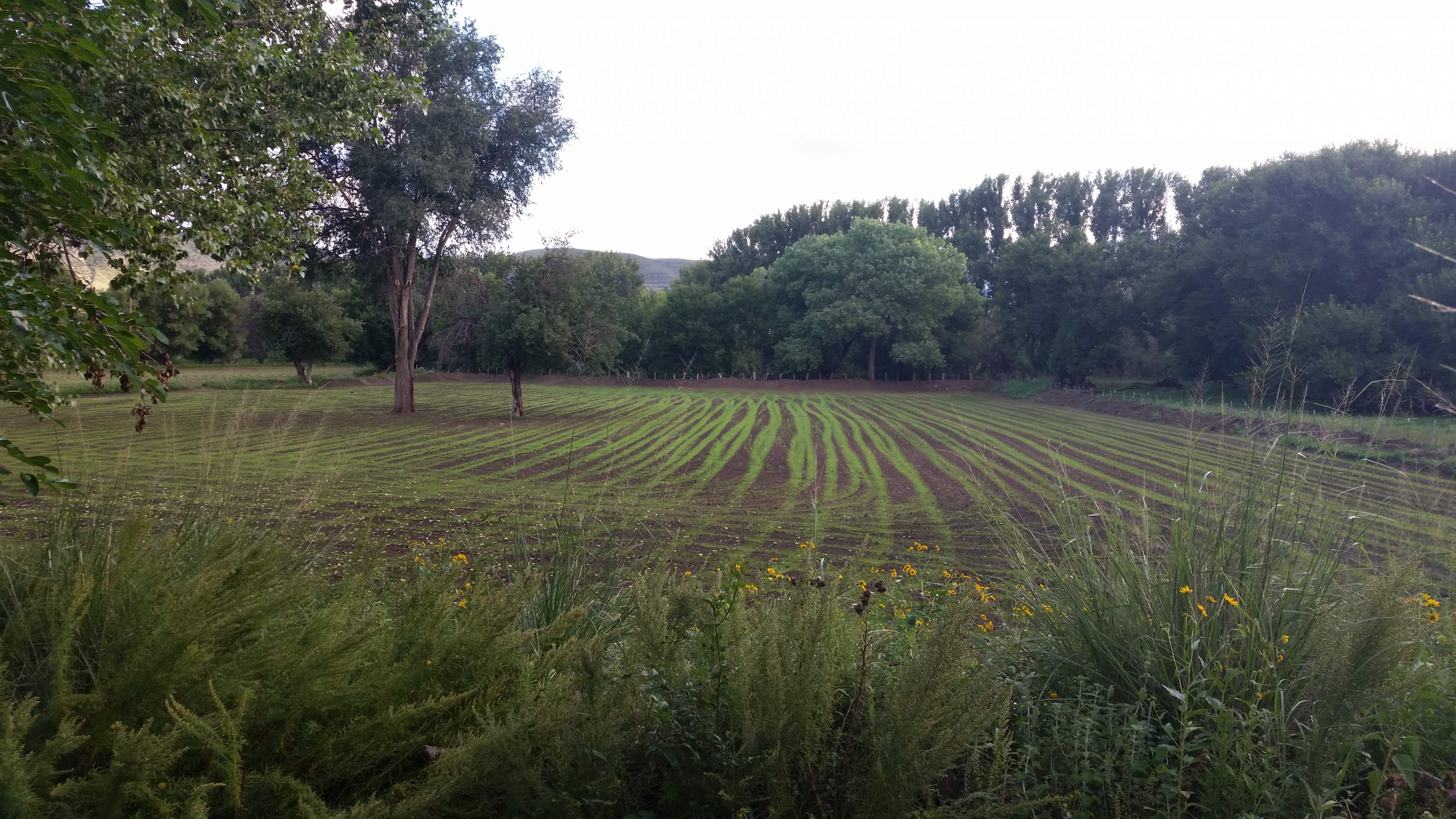

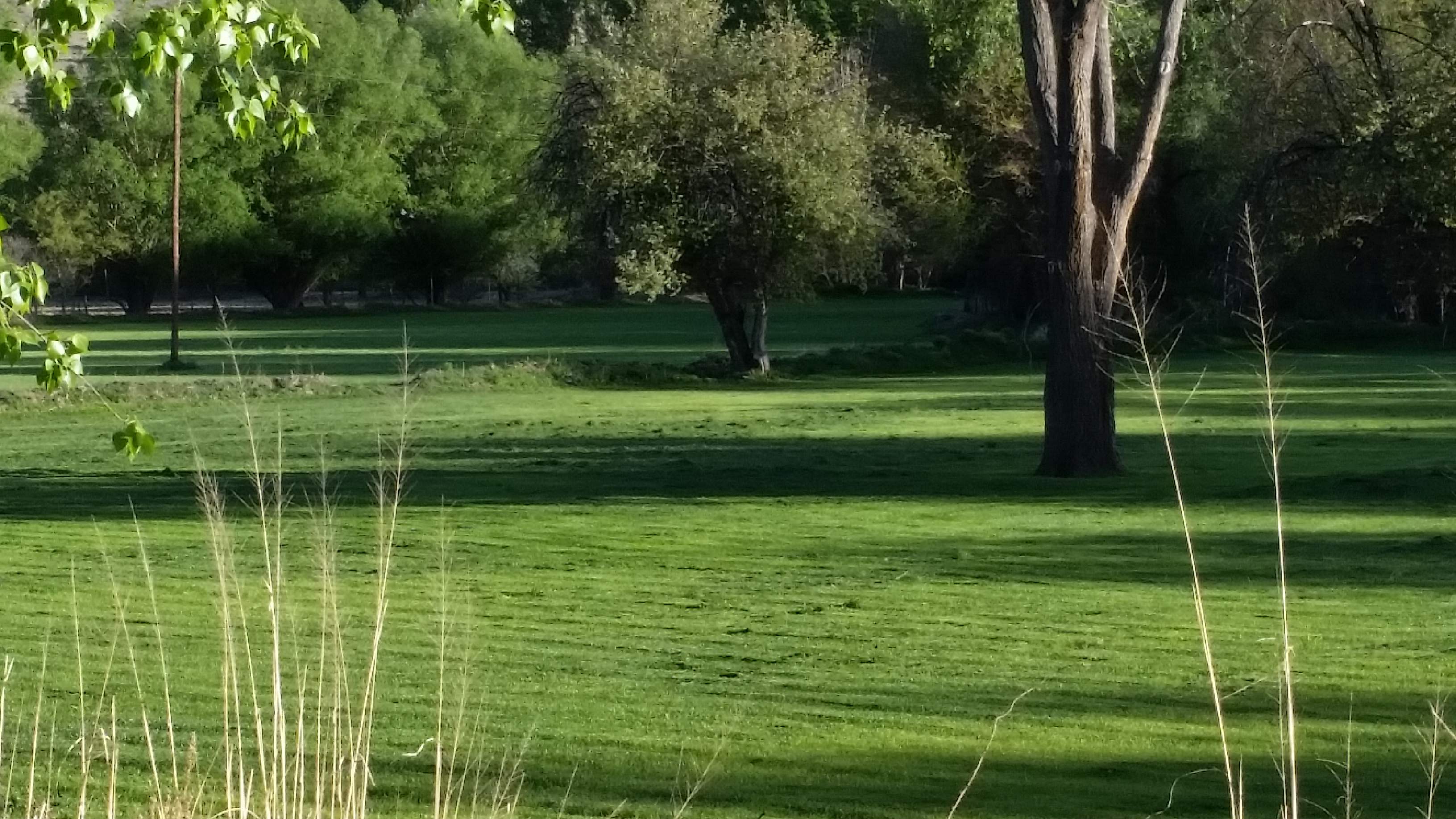

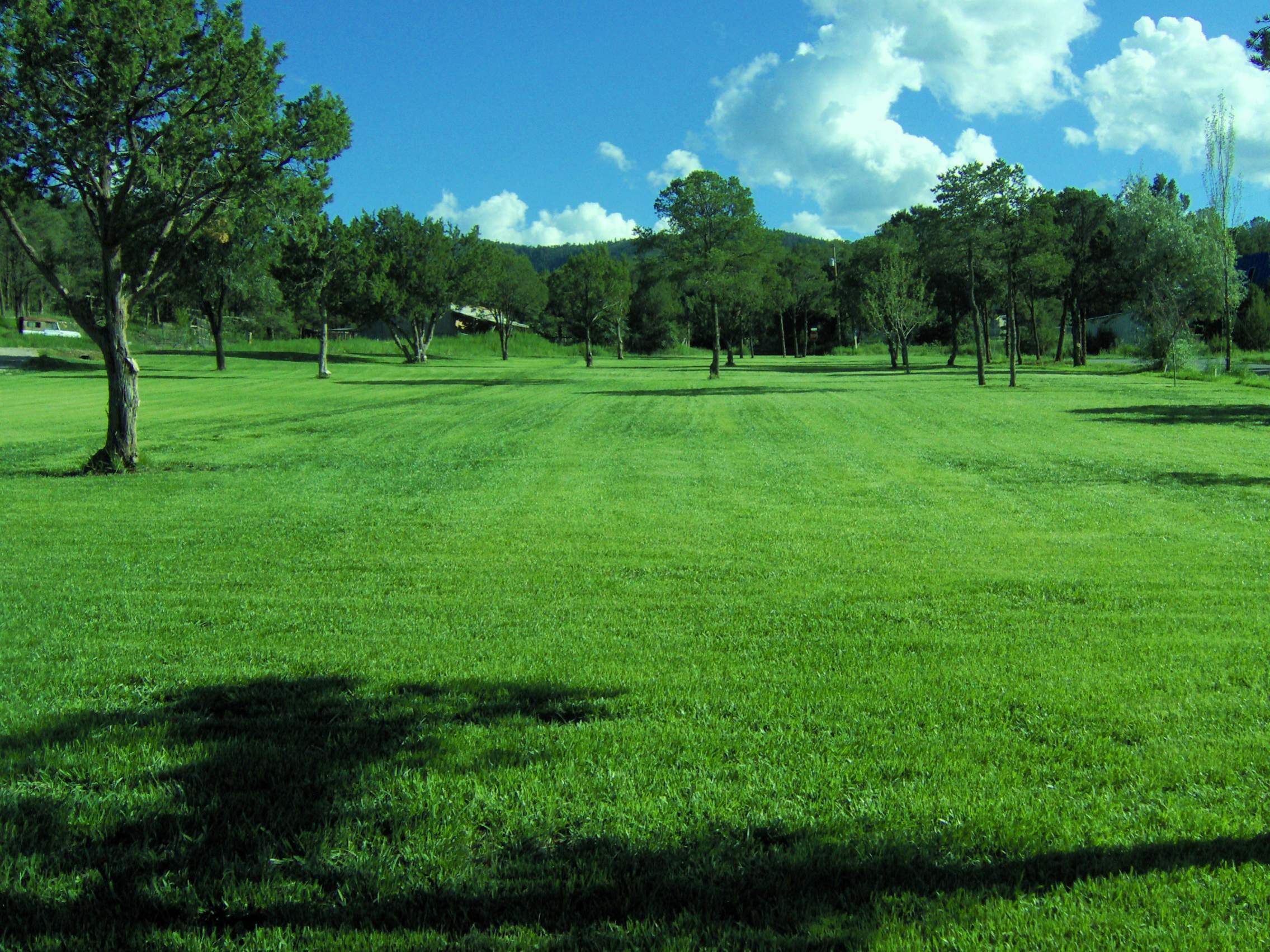

Drills are nice to have but they are not cheap. For your use I suggested tilling and broadcasting seed and fertilizer because I felt your cost would be less these tools. I would not broadcast seed on untilled ground with the exception of annual rye.
I don't have a drill yet because of cost, I like them and have used them on a few occasions. If you look at all the pictures below and know that all of these were broadcasted with a simple spin spreader you can draw your own conclusions.
The third picture is about 8 days after planting, you can see the results after a month in the first picture (same field).

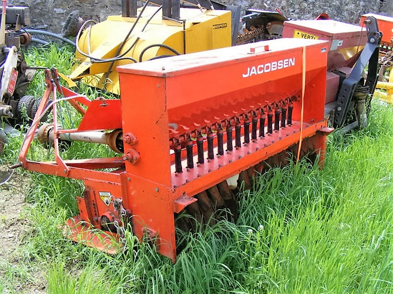

If you can find a Jacobsen 548 seeder this would work great for you. I borrowed one from my local golf course. They use to over seed the tees in the fall with winter rye. I have 10 acres, 5 in grass and I had great results without breaking the ground up. I would like to fine one for myself.
Eddie
   / No-tlll drill vs other attachments for seeding #17
Eddie
Do a search online, I found this one in a few seconds in PA for $650 don't know how recent the ad is though. Looks good and would be a good way to go. If it was closer to me I would check it out.
