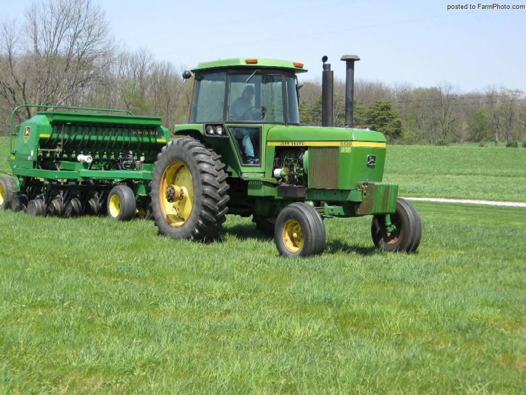

I rented this 10ft no till drill twice and it done a dandy job. I no-tilled alfalfa/orchard grass in soybean stubble and then the next year in sod. I did burn down the sod and used oats as a cover crop. It helps keep weeds at bay to let the grass and alfalfa get going. The oats grows fast providing a cover and I was able to cut it in late June/early July for hay.
