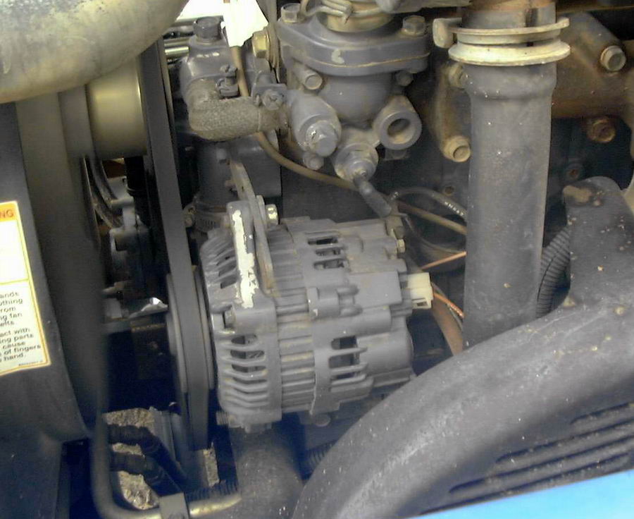

Here's a photo of my alternator you can see the two-wire plug and the single pink wire is in the back that goes to the tach. This is the one I couldn't get to without removing the alternator. On mine, the two wires going into the white connector are brown and orange. The orange is faded a bit and looks almost identical to the pink one for the tach, but they are easily different to the naked eye.

Here is a photo of the alternator labelled correctly. This photo is from a vendor's site and is not mine. I just copied it here, but my alternator looks like this one.
EDIT: It might be a mirror image of the real alternator. They easily could have this image reversed, but there is a lot of separation between the two connectors on my alternator and not close like yours.
Well, here's the problem: I don't have a wire going to that post and I was wondering why it was empty! Now, all I need to do is crawl around looking for the wire and when (I hope) locate the thing, just attach it. Sounds easy enough. Your last picture cleared things up for me. Will report back when it is located (could be tomorrow).

William, my tachometer is analog, but the input should be the same for either analog or digital. The difference would be that the digital gage will have a counter and display driver. The innards of the panel are not serviceable normally.
   / No tachee, no dirty! #14

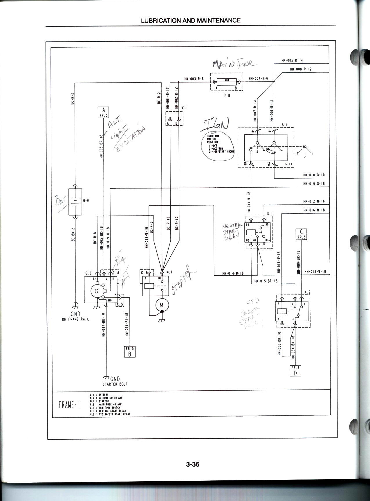

William, I just read that you said your alternator has nothing connected to the tach output. There's a chance that the digital gage is mechanized differently. They could have a pickup/transducer installed directly on the flywheel somewhere. That's why it's so important to find your manual and look at the schematic. I could be totally taking you on a wild goose chase because your machine could be different.
The schematic would clear that up right away. I've attached an illustration of my schematic (one page only) that shows my alternator. The wire going from the P terminal to the box labelled "FR 5, B" is the tachometer wire and it goes into the instrument panel on Frame 5 and to the tach circuit. If you had something similar it would ensure that your search for the missing wire would not be a wild goose chase.

I feel obligated to come down to Texas and help you with that project after all the help you have given me! I hear what you're saying - maybe that's why there is no wire on the spade plug. I will look for my manual and hopefully together with all of your info be able to get it working. Not before Sunday, however. I'll report whatever I find, and if you need some help, just ask. Thank you so very much for all your help and assistance. It is indeed greatly appreciated.
