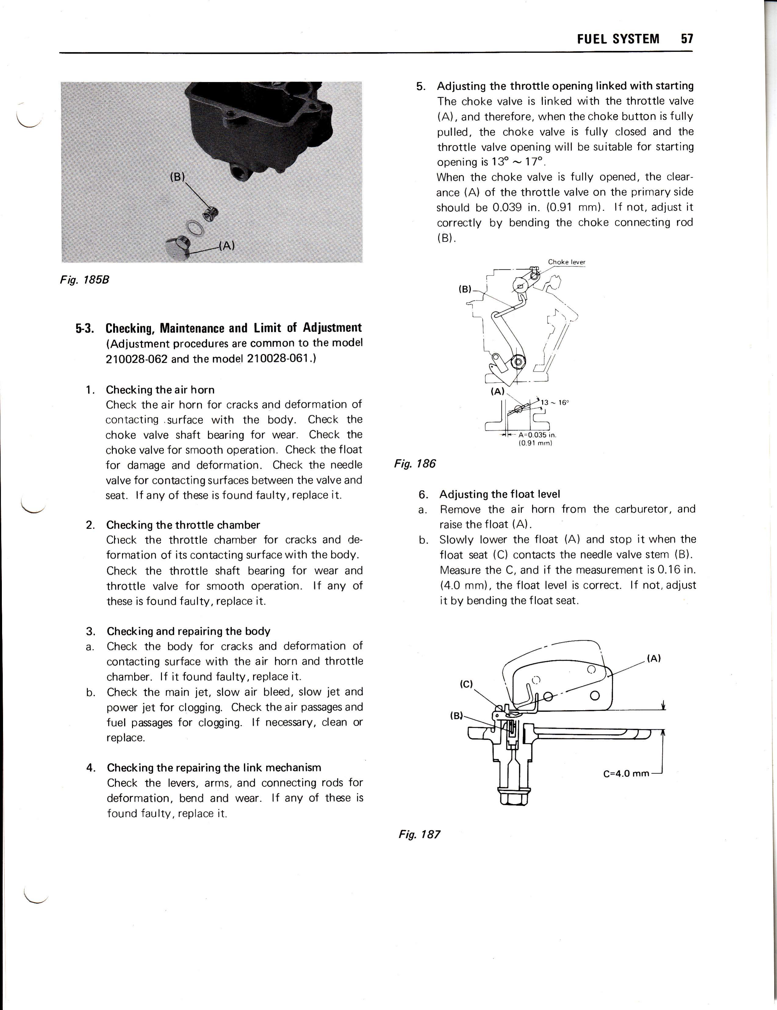

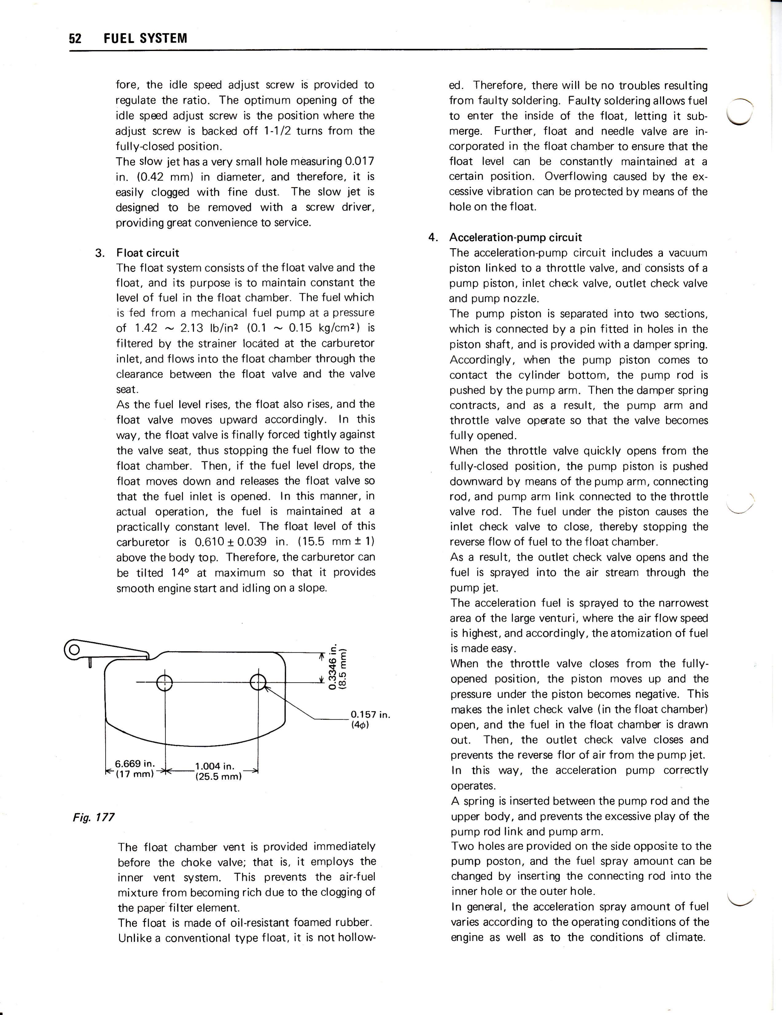

have a satou 650 that wont start..think its the float in the carb..anybody know how to set one..gas is pouring out the tube on top of the carb and the float isnt stuck..think its called air tube for fuel bowl...also having problem with intermitting fire..sometimes it has it and some times it doesnt..think its in the voltage regulator..think im going to put a gm alternator on it and bypass everything else...also starter is getting weak..does anybody know what starter will fit
/ no start #2
These copies from the book have some helpful information in regards to setting the float. Intermittent spark sounds like bad ground, plug/coil wires, condenser, points, or cap but not so much like regulator/alternator unless your system isn't charging at all. Numbers for alt/reg are as follows:

I don't have a starter number but you might look into having yours rebuilt. carb float 1.jpgcarb float 2.jpg
/ no start #3
I'd suggest its uncommon for a float to be so far out of whack that fuel pours out the overflow. Assuming the float is OK and its been installed the correctly, its more likely that the problem is the needle and seat. It could be worn or theres some grit thats preventing the needle from sealing properly.
