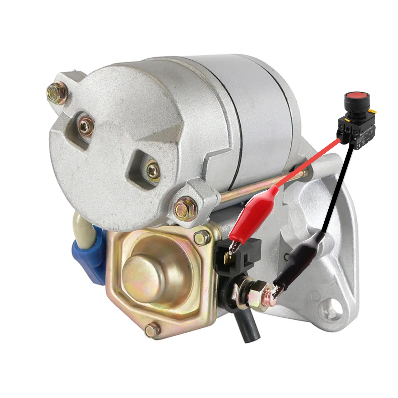

I am gong directly from the positive battery terminal to the "plug in" wire above the battery cable lug on the starter. I leave the key on, touch the plug with the charged jumper wire, and the tractor starts.
By directly energizing solenoid, it indicates there is either a bad connection or bad relay or safety switch between terminal on starter and ignition switch....
Also battery light on would probably indicate the generator/alternator is not putting out a charge voltage to battery....

   / No start condition Massey Ferguson 1260 #14
Does it start when you jump across here? This is where I mentioned that I temporarily added a momentary contact switch with long leads while waiting for the new ignition switch. This will test your battery connections and grounds. This will also test the starter solenoid where jumping straight from battery to starter lug will not. I've used this switched jumper setup as a remote start when working on fuel injection issues when I didn't have someone that could sit on the tractor and hit the key. This is not a permanent solution since it can be dangerous because the tractor is no longer "thinking" for you.
This bypasses all safety switches,
make sure it is in neutral, PTO disengaged etc before pushing the button.
#15
Yes it starts jumping that way. It has to be a relay or something at this point. Testing all of that is above my skill level however. I guess it's off to the shop unfortunately
