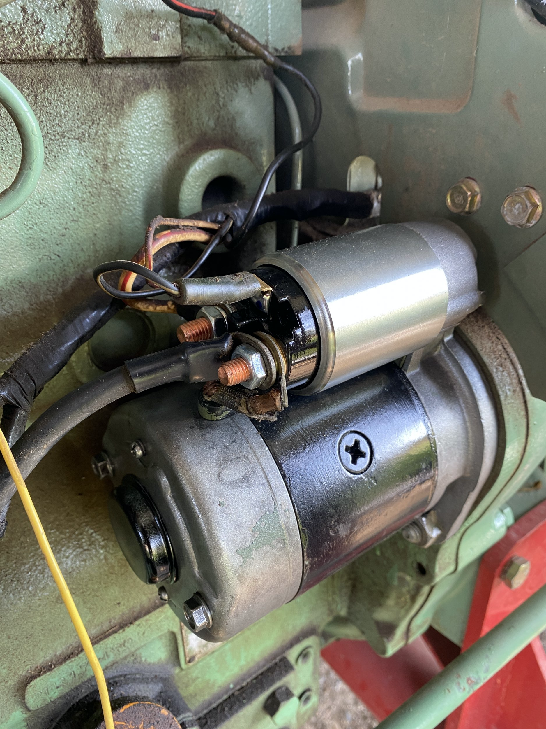

this is the rebuilt starter. There is a guy in a town nearby that is amazing at rebuilding auto/tractor electronics.
Is that starter wired correctly? It looks to me as though the hot from the battery is connected to the solenoid terminal that goes to the starter. If so, it would start cranking - but in the correct direction - the moment the battery is connected.
If that fat wire that is connected to the nearest solenoid post is the hot from the battery then the solenoid is being bypassed. What is connected to the other solenoid post?
rScotty
Yeah, that was hooked up wrong. I left the wires in the position I took them off, when the starter fried.
However that was almost 4 months ago. And just trusted they hadn’t moved. That’s when it got exciting when I hooked the battery up. The wires are switched now.
As for the wire on the other post, I’m not positive. Tracing that today.
Through this process I’m learning to take pictures before I remove anything, so I can put it back correctly.
   / No power at dash/ignition #16
Excellent pictures and enable us to make wiring comments from the photos alone.
YES, that's a pretty common wiring mistake. I'll bet it was real exciting when you hooked the battery up. My guess looking at the wiring is that it started cranking immediately and didn't even need a key!
Both the large black battery wire and your two white or yellow with a red stripe wires are hooked to the other large terminal. Of the two white with a red stripe...generally one will go to the voltage regulator and then on to the fuse box. The other may go to the fuse box on its way to the ignition switch. The only thing hooked to the nearer large terminal is the two inch heavy wire that goes into the starter itself.
If you had it hooked up like that you did no damage as long as you got the battery unhooked before the starter got too hot. It would be turning the correct direction, but the motor would almost start but may not be able to do so since the pinion gear of the starter could not disengage from the flywheel.
The other wire to the solenoid - the black with the white or yellow stripe - should be the one that is powered by the ignition switch to cause the starter to turn.

Getting both wires correctly hooked to the correct post was the trick. Thank you for taking the time to respond to this thread. Very much appreciated.
Side note, it still wouldn’t start after I got it hooked up correctly, but I had power everywhere I should.
I cleaned the fuel filter and in the process I had let air into the fuel system. Once I bled the air out the tractor fired right up.
