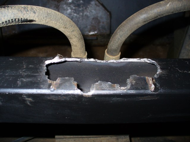

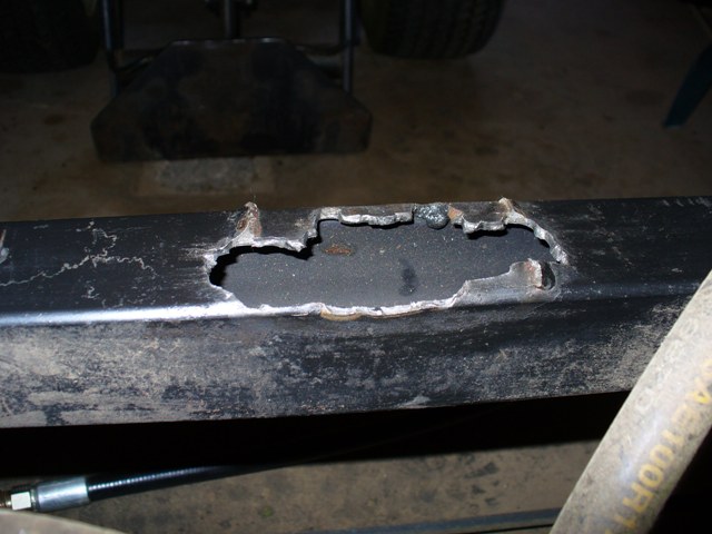

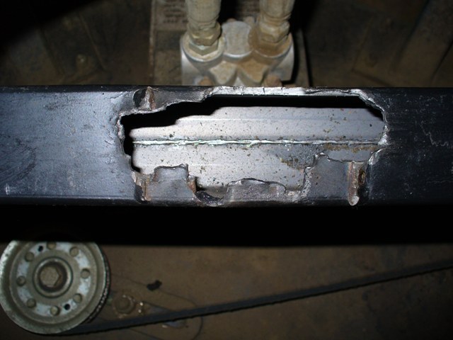

Finished up a full day of grass cutting and went to lift the deck for the usual cleaning before heading into the garage. Arms went up but the mower didn't! Does it look fixable? It's times like this that I wish I knew how to weld!

That will be easily fixable. Be sure to have the weldor reinforce it rather than just welding it back together.

It should be an easy fix with some 1/4" plate, a torch, a grinder and a welder. Sounds like an excuse to buy all of those things. (at least, that's what I'd try with the boss). :D
/ No mowing for a bit #4
Very fixable but you should look at how the 1850 mower works. I bent my top bar, found out it was just thin square tubing and replaced it with a heavier 1/4" tubing. I would replace your top bar as well (15 minutes with a chop saw, 1 hr to weld and .5 hr to drill new hole).

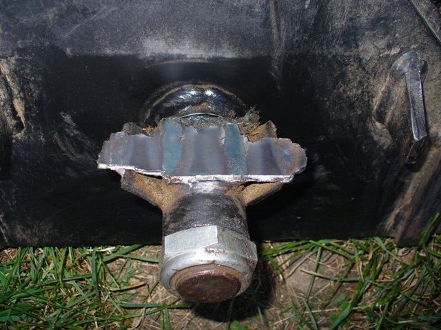

Just happened to mine. welded a 3/16" patch over the hole, disassembled the bearing and welded it back on the 3/16" steel seems like a good repair. This has happened to another person on this board and WILL happen to others. Check your assembly carefully for cracks.

Had a welder come by last night, going to weld angle iron the full length of the bar and then weld the collar onto that. Will post pics when done.
I take care of my equipment, mower was not abused but did have apprx. 375 hours on it. If that cross bar would have been as heavy gauge metal as the rest of the mower I doubt this would have happened.

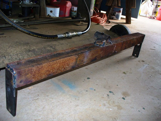

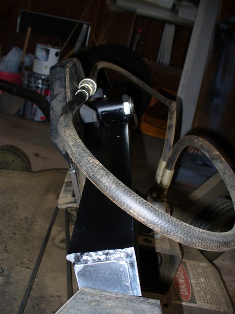

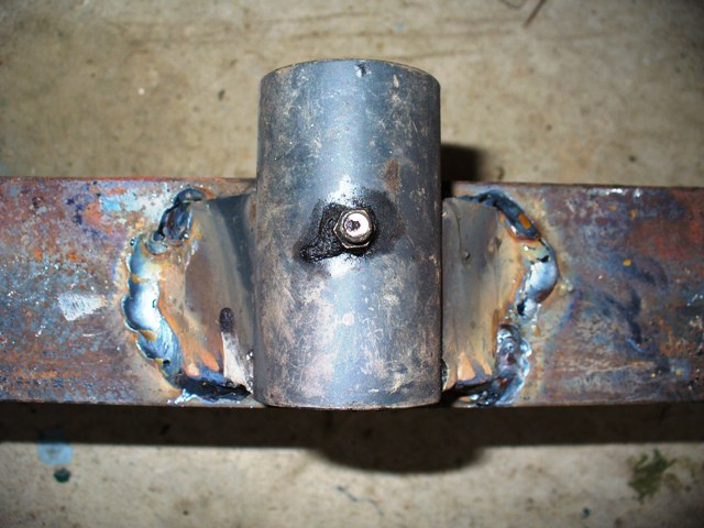

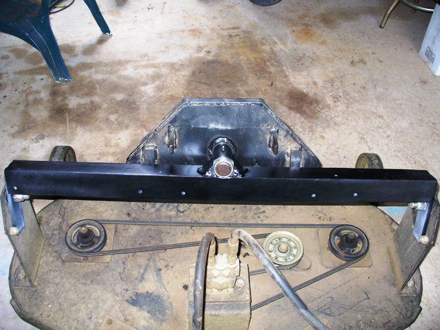

Got it welded and installed. Ground out the rust on the angle iron, 2 coats primer, 3 coats paint and ready to cut again. $45 including paint and I doubt/hope I'll not have this problem again.

I think the mowers get the most stress when the front of the tractor is lifted by them. This is easy to do.

Yep, I agree. While I never did it on purpose there was a few times that I lifted the front end with the mower. I thought about having the cross member cut out and completely replaced with heavier steel but I was told this will probably do fine and save me some $$.
