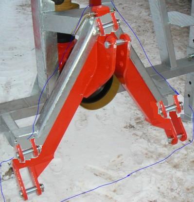

Here is another idea, probably to late for this a-frame if thousands have already been sold and a 'new standard' has already been established...
Make the a-frame with hitch pins that meet the ASTM standard. This would allow new tractors (assuming they were sold with the a-frame) to use is it but older machines can use the pins. This would allow the a-frame design to become popular without limiting compatability.
Here is a hacked pic of what I mean.
Nice attempt, Mwb. Actually, you can also weld the Pat's quick hitch to lower section of this A-frame. But, all these unnecessary. Just cut the pins on older implements and weld the gray u-female on this picture to older implements. That's it. This A-frame is sold as set, female and male together. You don't have to think about cat 0, 1, 2, etc and Astm standards. Astm does not help, we help them. If we cancel 3-pt pins, etc., they will have to remove the 3-pt pin stds from their heavy books.
