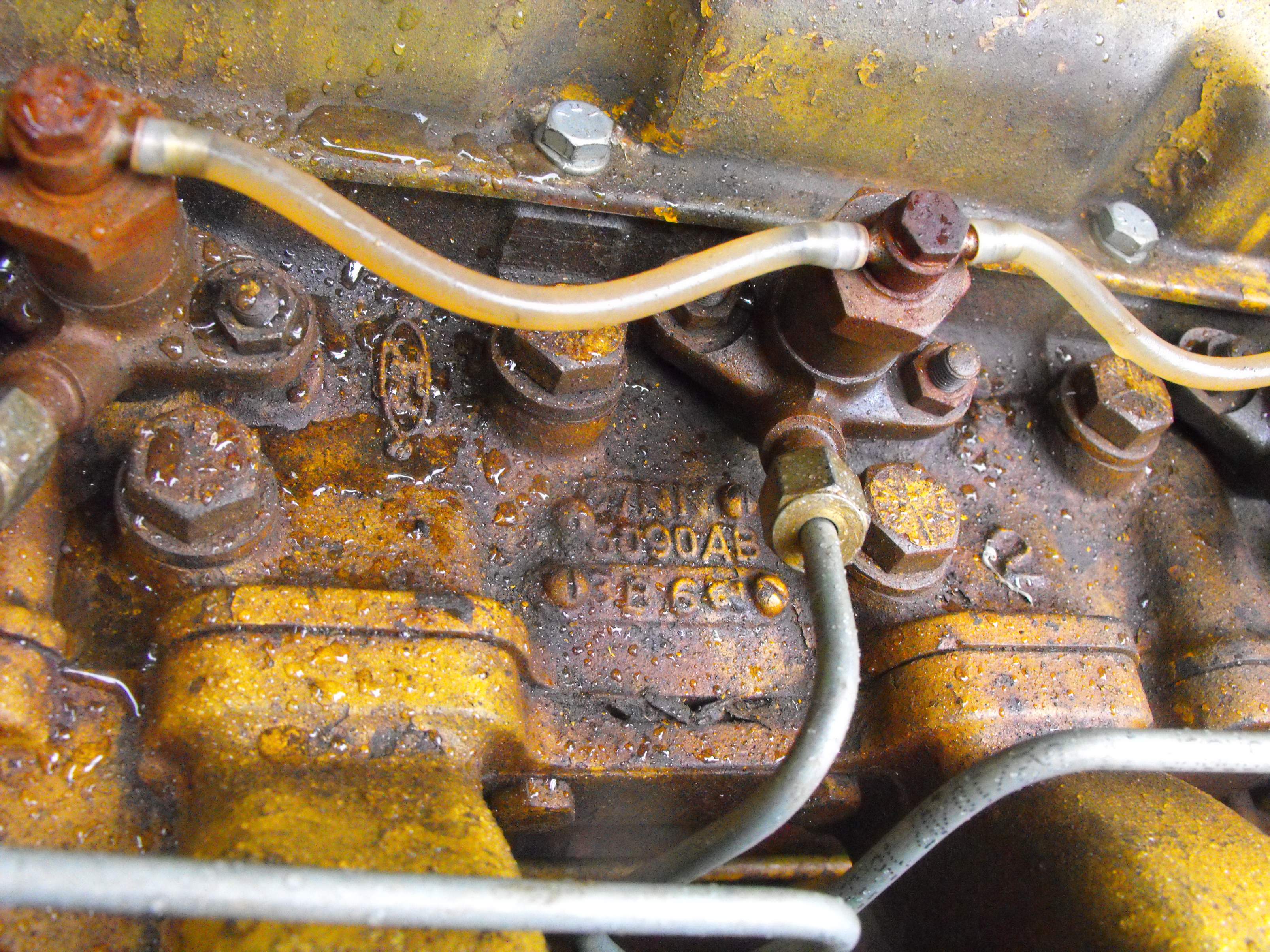

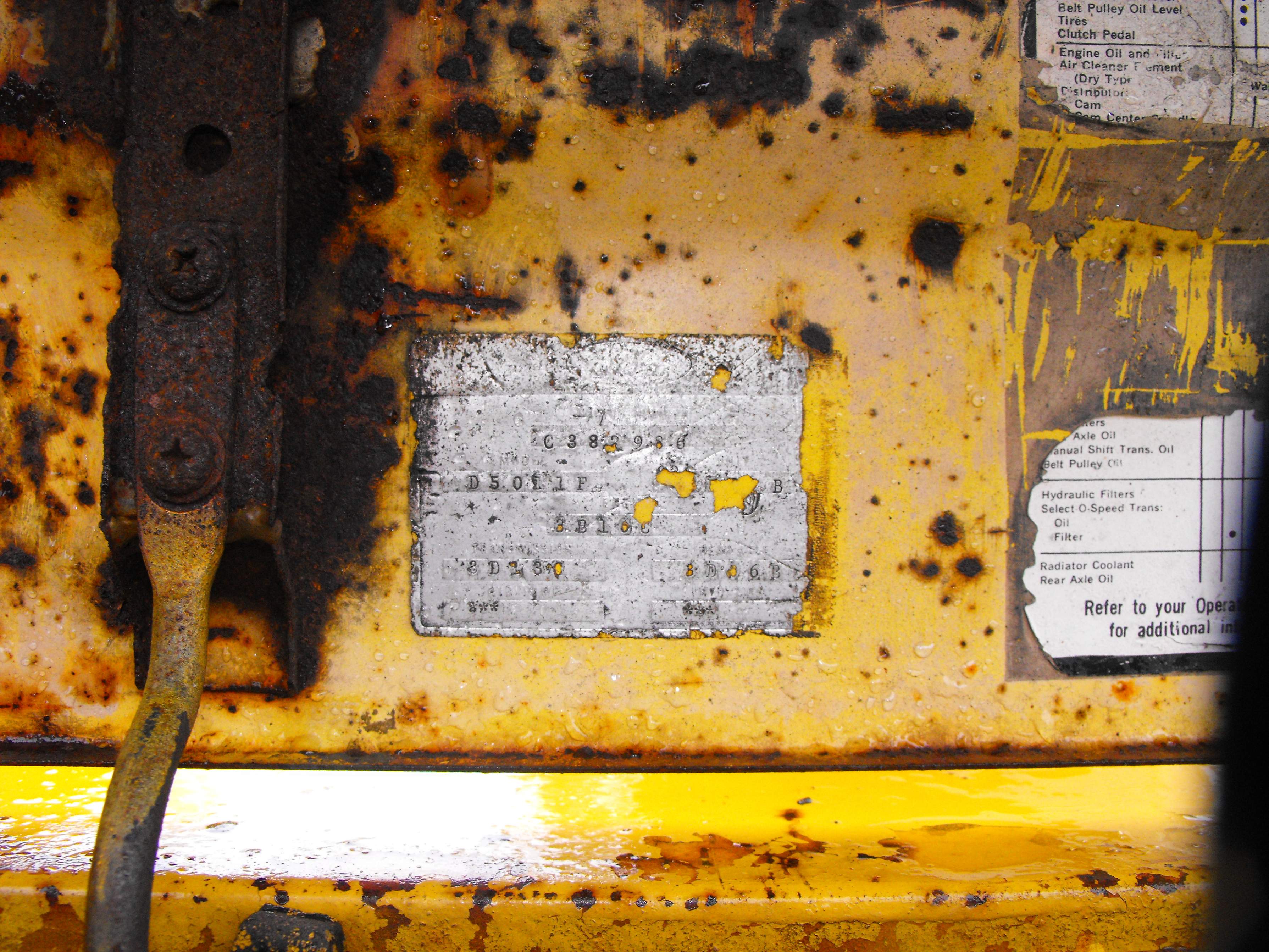

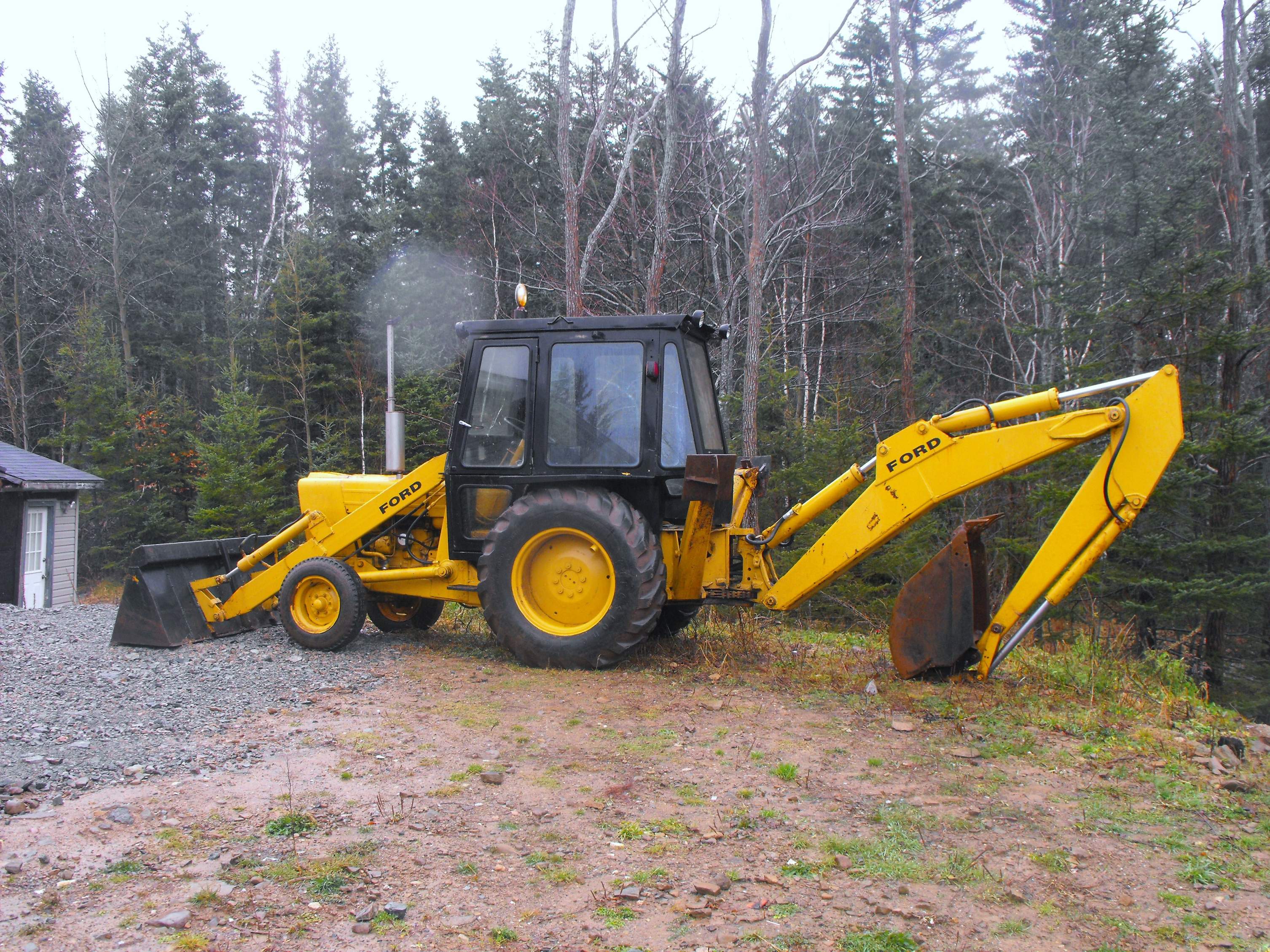

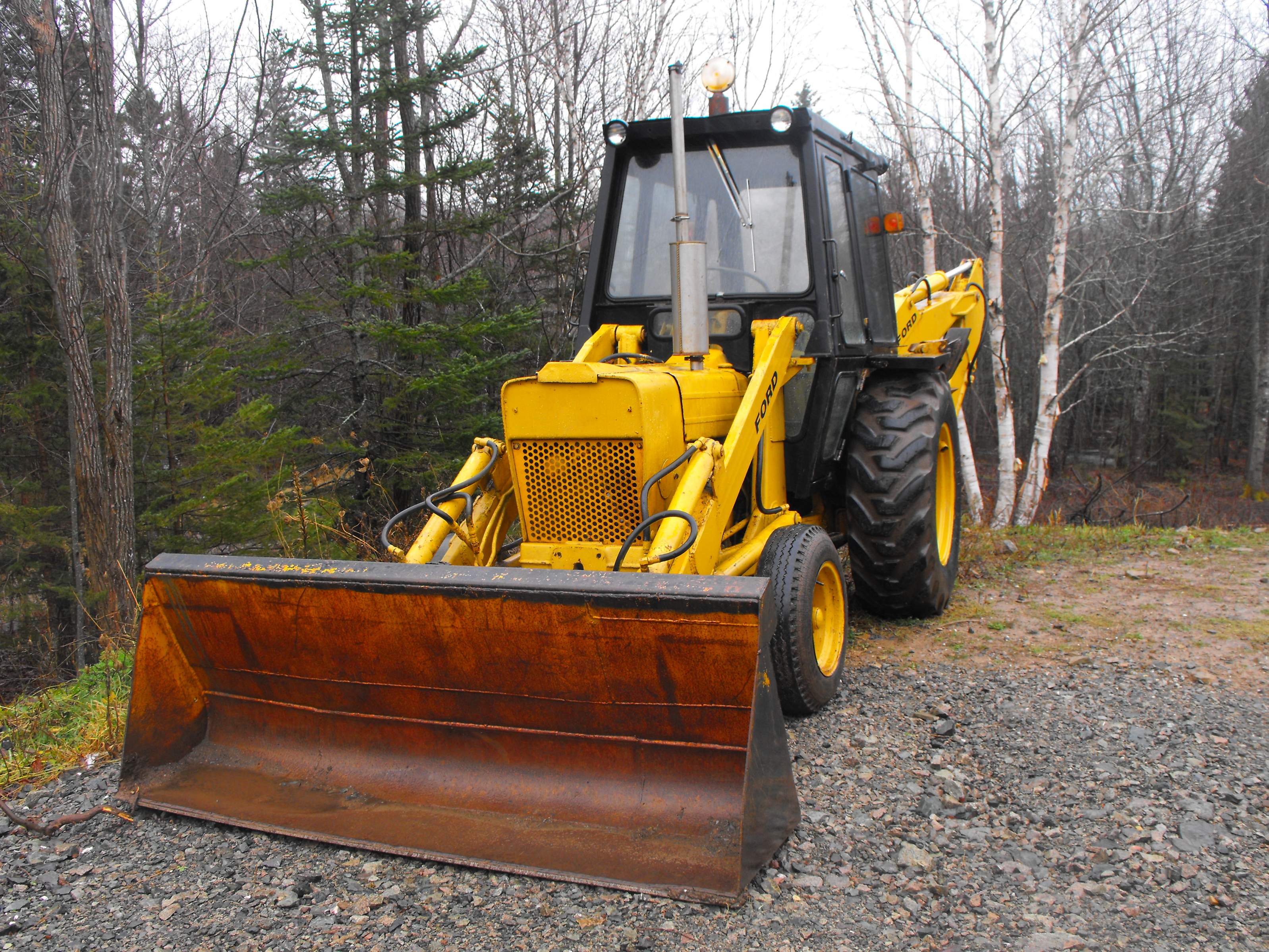

Sorry Guys, I took the pics from my Iphone I thought the pics could be enlarged when opened, I will get better pics, ASAP! I'm curious to see what year this is wiring is a mess couple of cylinders are leaking tires are in bad condition, e was starting it with ether in the morning he said it didn't have glow plugs. But I see it has a block heater. I don't understand people not taken care of something this expensive.
Thanks for the help :)

So I got it right with the ford 4500 Industrial
Good guess since I have one:laughing:

I hope you didn't pay too much, because that unit was rode hard at some point. Front loader has scabs and other repairs. The bucket cylinder was broken off the hoe. Those things are signs of long hard use, possibly abuse.
Have you inspected the entire machine for other signs of repairs? Especially for signs of current un-repaired cracks. It looks like the machine was given a slathering of paint, that can hide cracks for a while.
Then check the front spindles for wear, then each pin/bushing for wear. Each bushing on that machine is at least $50 for the press in bushings + the removal and installation cost. Pins are probably 2-3x that (each). It's very easy to spend more in pins and bushings than the entire used machine cost. And that is the reason that an expensive tool can get neglected. Cost to repair gets to be way high. At some point, it's cheaper to buy a new one than repair the old one, so it gets beat on until it's ready to drop and sold.

That is a clean/straight looking BH to be going on 40 years old. Most are more beat up and glassless if they have an enclosed cab.
Someone has put new injectors from the look of it some maybe it has been keep up other wise as well. Tires look like have a lot of tread for personal use.

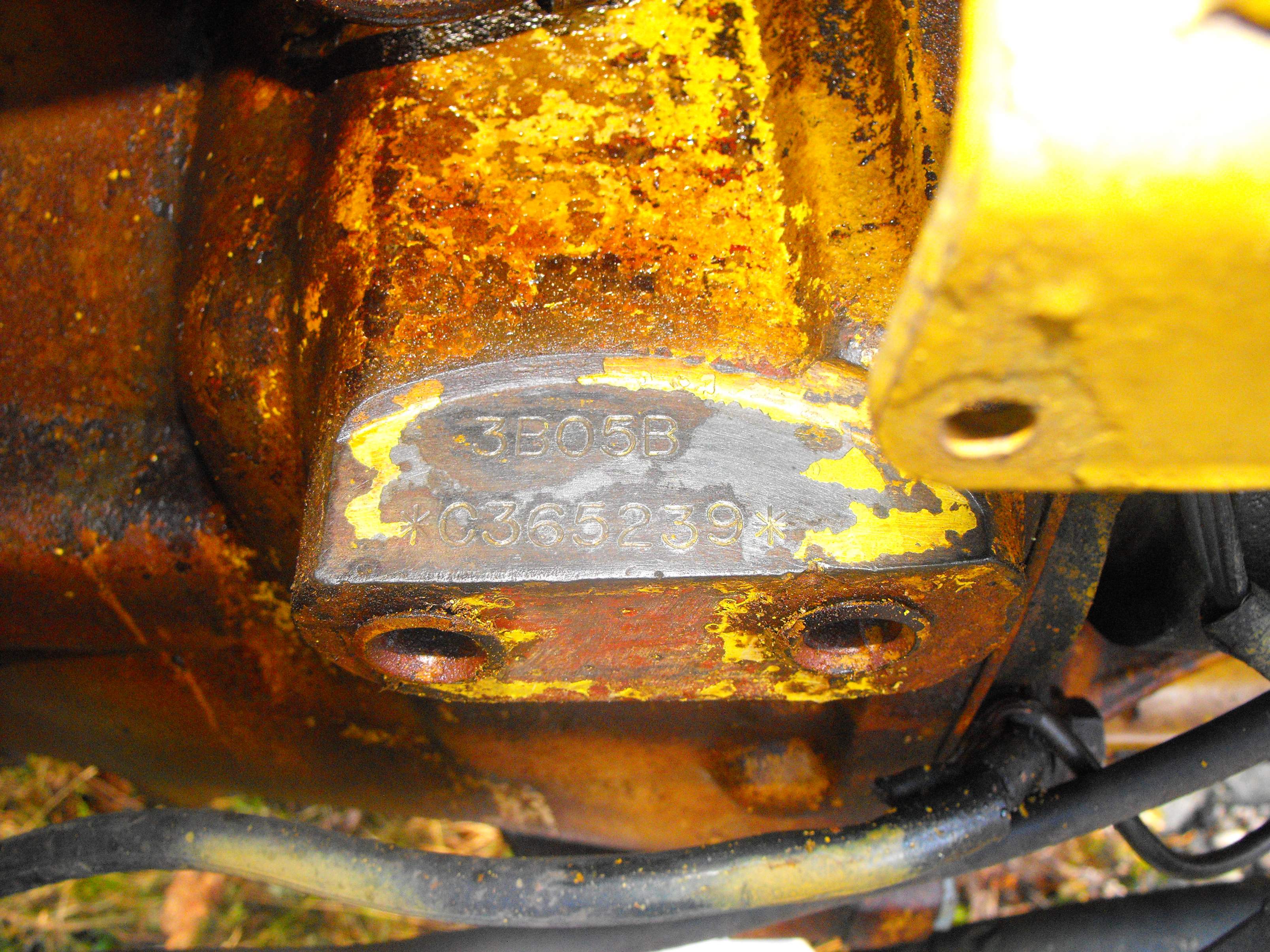

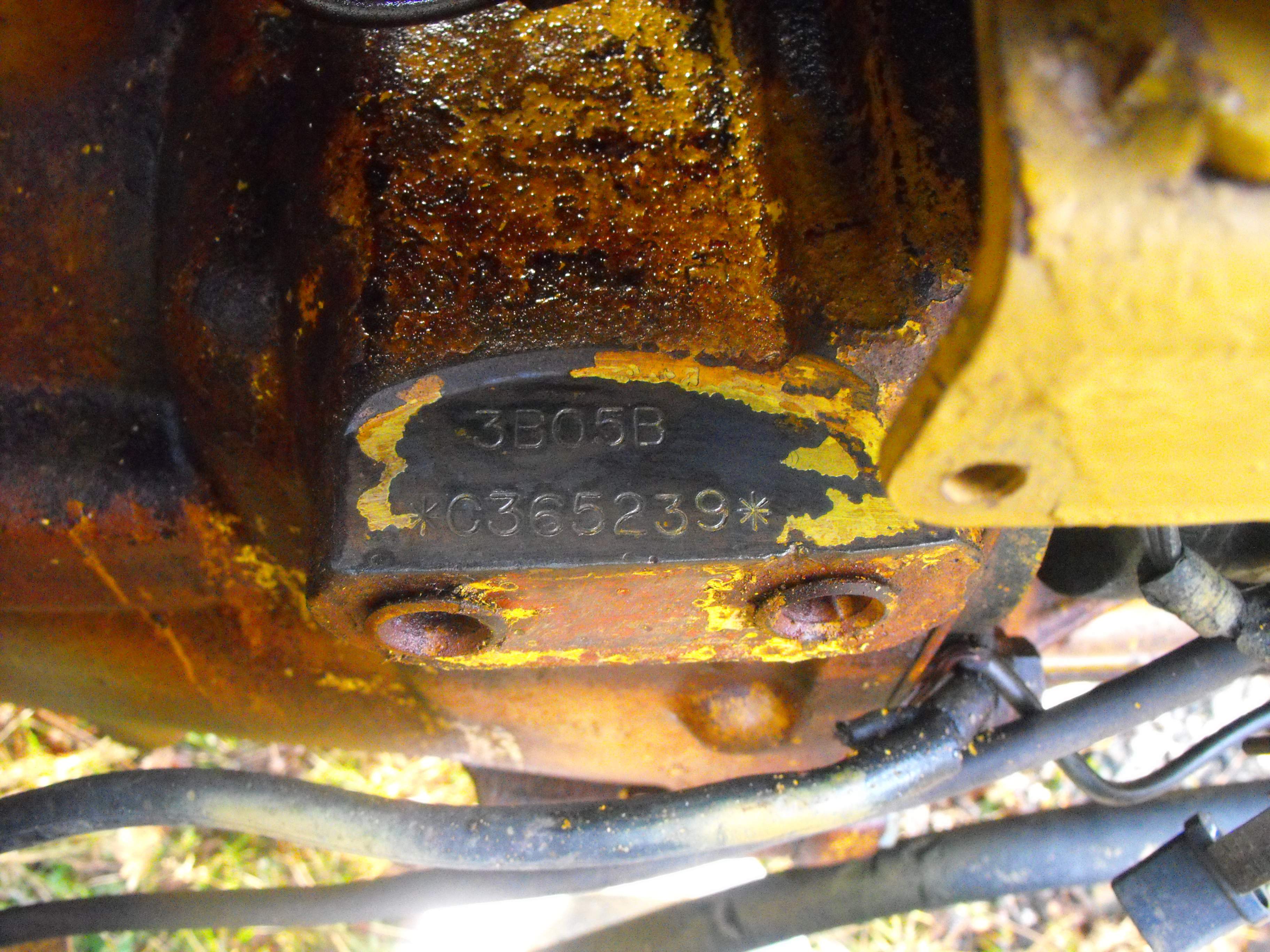

I got pics from the starter side, this unit is in rough shape hyd lines need to be replaced the out shielding falls off when you tough it. pins on the loader look like it needs to be done. cyl are pitted, power steering not working, found the block header needs to be replaced leaking a bit just wondering if a universal would work.

It is a 1973 Ford 4500 TLB. Built May 10 1973. Block heater is a 1-1/2" frostplug style. Parts and service available at any New Holland dealer.
