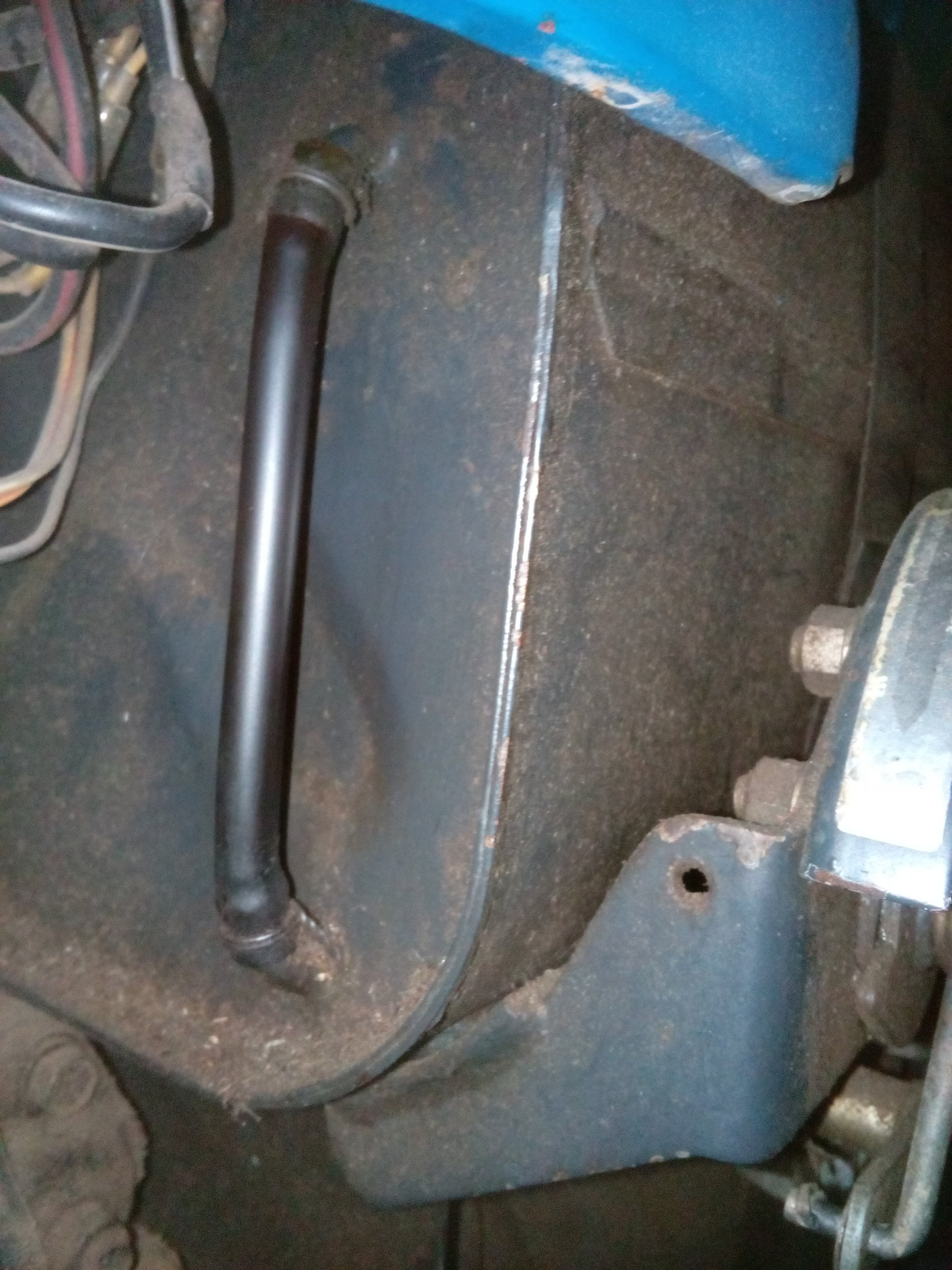

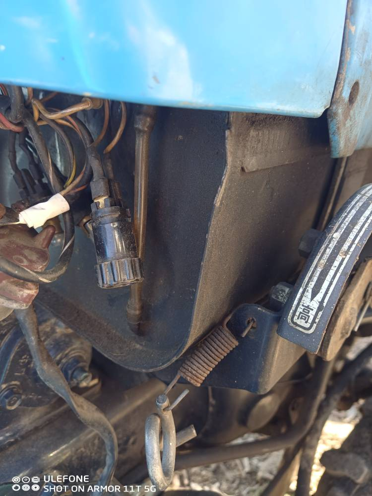

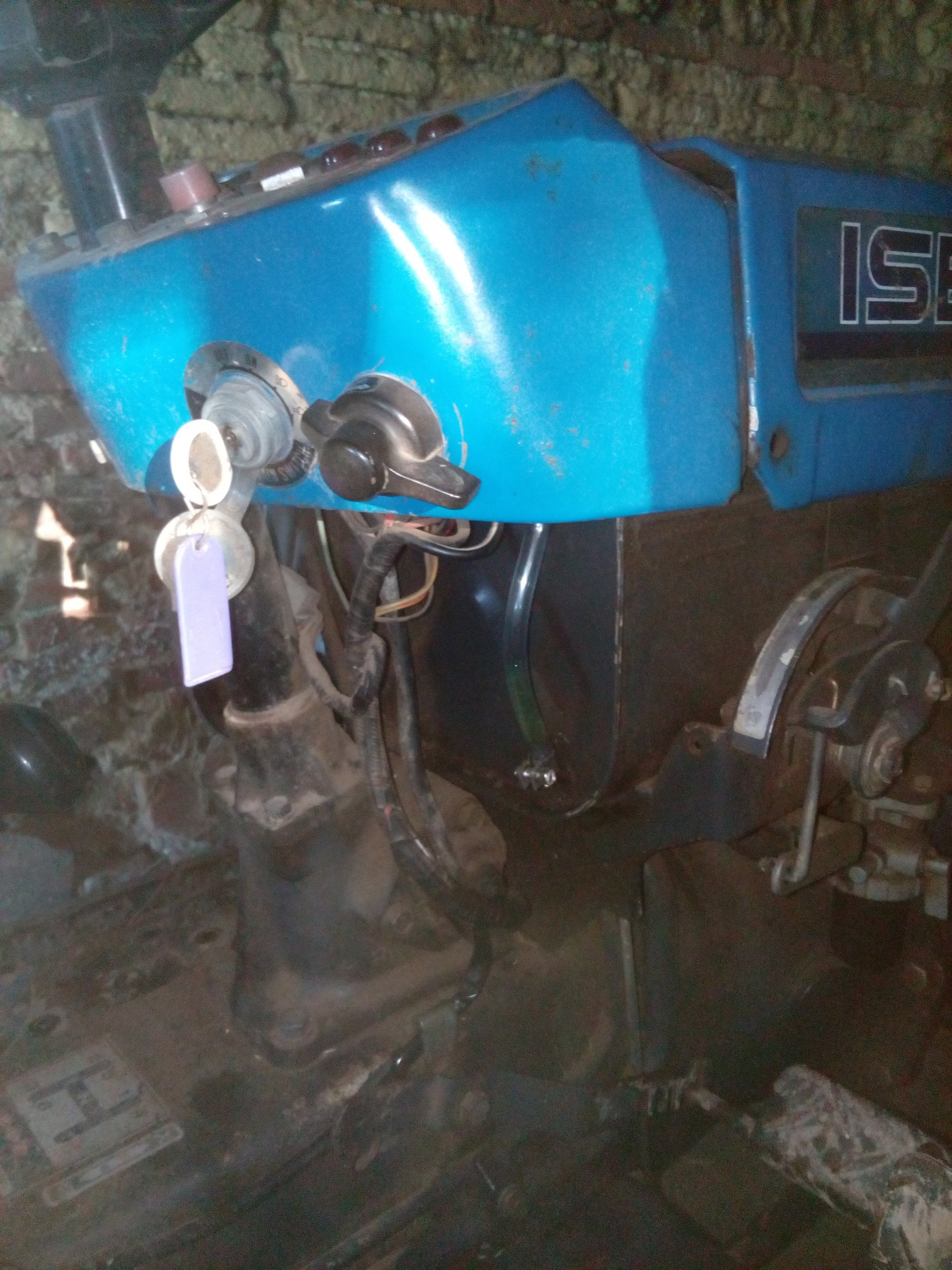

My TX1510 like many others does not have a fuel gauge fitted as standard..has anyone done anything to solve this 'problem' I guess just continually checking the level is the obvious answer but its still a pain having to bleed the fuel lines when you run out down the field even more so when you've forgotten the Jerry can with the spare Diesel in LOL!!
   / No Fuel Gauge Iseki Tx1510 #2
Does the TX 1510 not have a clear pipe fitted on the tank beside the throttle to view the level like the TX 2160?
   / No Fuel Gauge Iseki Tx1510 #3
It should have. Both my tx1500 and tx1300 have it.
   / No Fuel Gauge Iseki Tx1510 #5
It was no trouble. The reason that you see these wires and cables is that i am working on the electric ****. Business as usual... :)
Thanks guys and yes you're absolutely right I've never really noticed it before, bit dark so may consider replacing with a new section to make it more 'readable'..apologies for the delay in replying!!
   / No Fuel Gauge Iseki Tx1510 #7
Thanks to MarcelPL I found it on my TX1510F too. It was so darkened by red diesel, but now it's great again to have an indicator !
(do not like I did: think half the level in the tube is half the tank... It's ¼ left, about 2½L to go)
