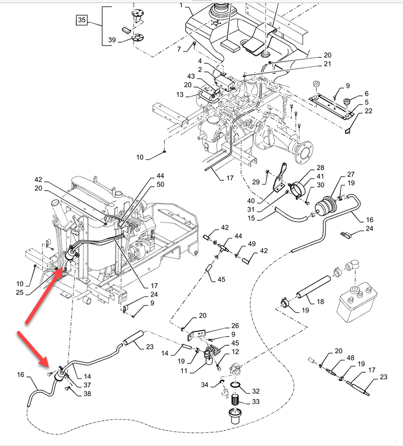

Apr 30, 2025 / no fuel coming out of fuel tank #1 tz24da2 New member Joined Apr 30, 2025 Messages 1 Tractor tz24da does the tz24d have a pusher pump or is it gravity
Apr 30, 2025 / no fuel coming out of fuel tank #2 H Harry in Ky Veteran Member Joined Jan 27, 2012 Messages 2,118 Location Winchester Ky Tractor Allis Chalmers ED 40 Fuel Tank & Related Parts | New Holland Agriculture | MyCNH US Store Find schematics, manuals, specifications and diagrams for FUEL TANK & RELATED PARTS. Find genuine OEM parts for your needs. www.mycnhstore.com Most TZ series have a filter in the back. Usually need to remove the rear tire to get in and change it. At least that's been my experience.
Apr 30, 2025 / no fuel coming out of fuel tank #3 WM75Guy Elite Member Joined Jan 15, 2011 Messages 2,862 Location East Texas Tractor NH Workmaster 75, NH TC40DA, NH 25S It looks to be gravity fed, #17, to a fuel pump, #37. Messick's shows to have them in stock. See the attached PDF for details. Attachments tz24da.pdf 1.4 MB · Views: 25
Apr 30, 2025 / no fuel coming out of fuel tank #4 WM75Guy Elite Member Joined Jan 15, 2011 Messages 2,862 Location East Texas Tractor NH Workmaster 75, NH TC40DA, NH 25S And welcome to TBN. Let us know the outcome of your situation.
