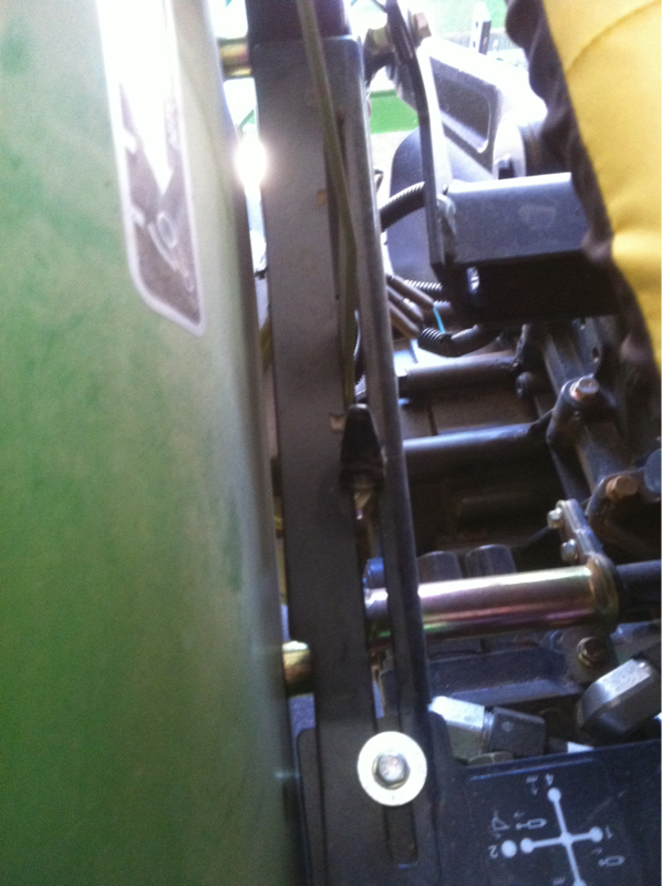

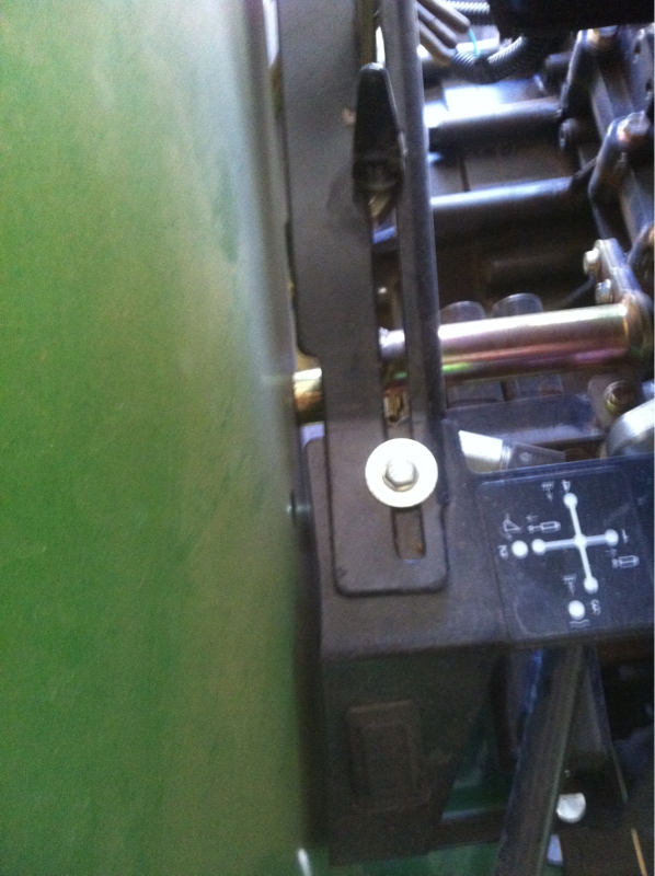

While shredding with my 4105 had trouble
setting it back down in same place.
So I went and looked at some other tractors and found one that might fit.
I believe it was a 3320 .It bolted right up
only had to lengthen the slide slot a little
Hardest part was getting rubber handle off

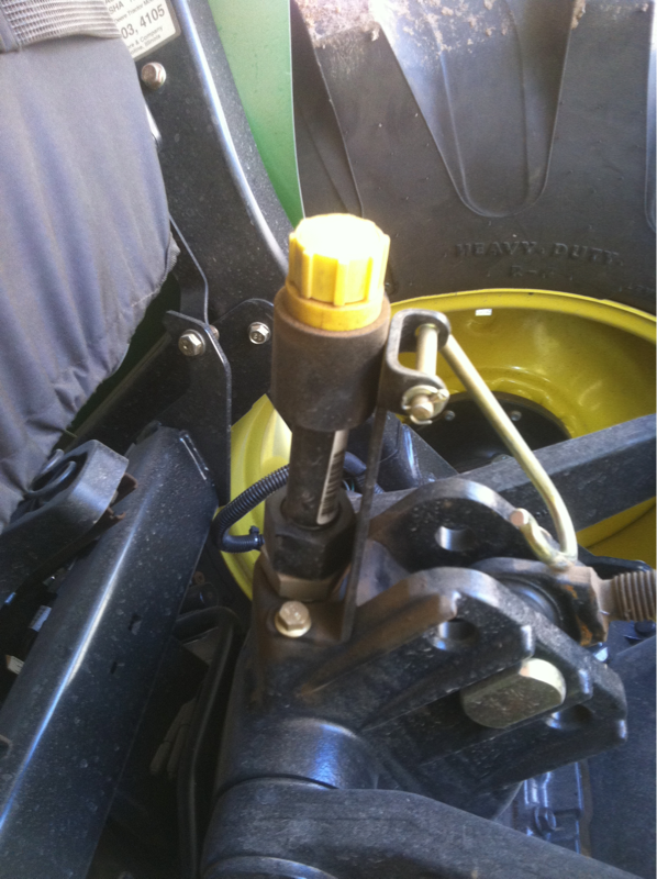

Here's a pic of tube extension used to stop leak from fill vent cap. I read that from another forum.
