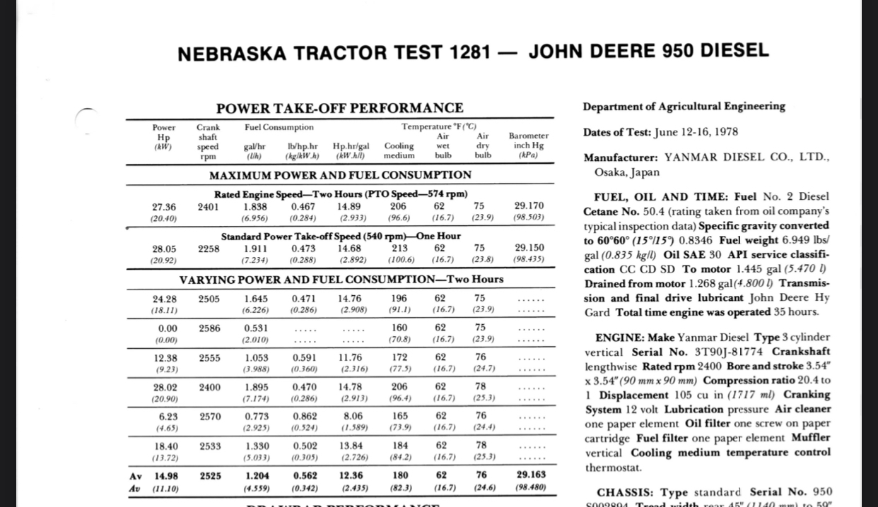

If you have better numbers let me know but for comparison I found my diesel
Is about 1.75gph under load. My personal experience and based on forums for a 35-40hp carberated gas is about 2gph hitting the governor the whole time. I hear the newer efi are a bit better.
Let’s run the numbers for 1000hrs giving the diesel 1.5gph and the gas 2gph
Diesel:
1000hrs x 1.5gph x 5$/gal = 7500$
Gas
1000hrs x 2.0gph x 4$/gal = 8000$
I don’t know those numbers to be exact. My CUT has probably 10-15% of its hours at idle where a diesel will beat a gas at idle. Different warm up protocols.
Another data point based on zero turns again (only application where the exact same machine has the 25hp diesel and 35-40hp gas) diesel guys claim .5gph and gas guys claim 1.5gph if that ratio true it would be the gas would be 3500 more than diesel.
There are alotnof factors but based on rough numbers I don’t think saying paying an extra 5000$ for a diesel to save 500$ of fuel makes sense. If it’s closer to the second example of 3500 maybe.

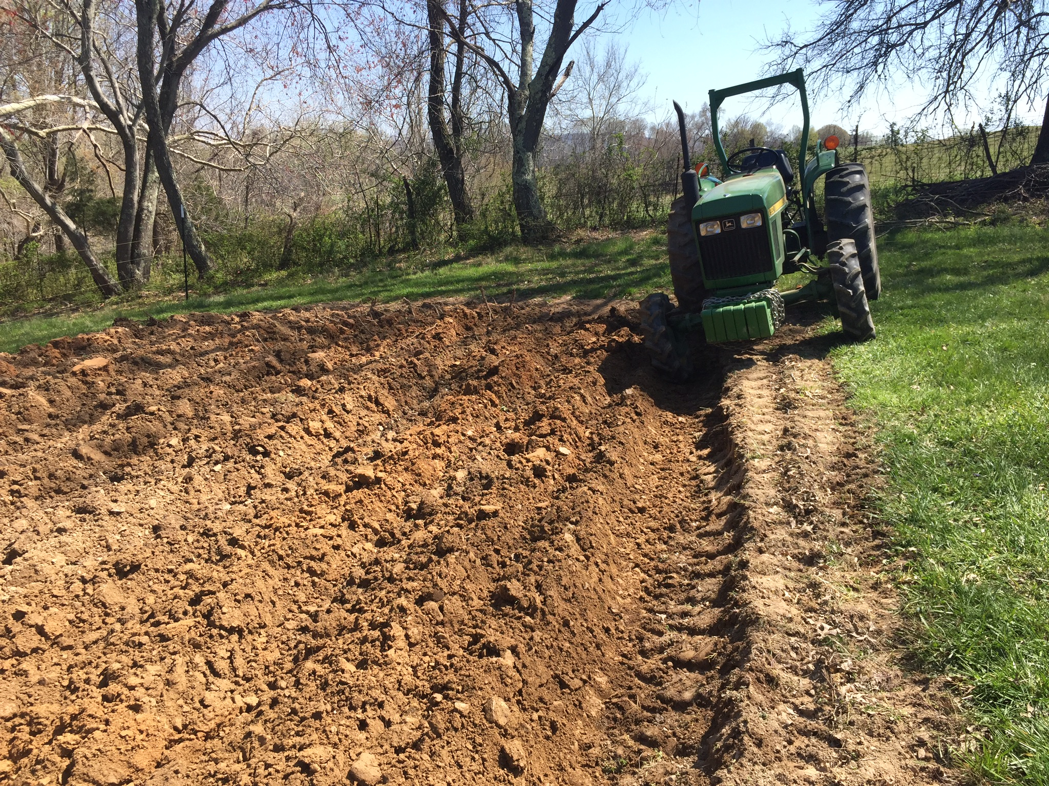

I just mentioned the 950 for reference to show I’m not a diesel hater. I already have a zero turn to keep the hours off the tractor.
I was making the thread thinking about how many people are priced out of the market now and will be shortly with the price increases. Me personally I have the 950 Mfwd but no loader. I rent a skid steer or mini-ex about once a year for my vacation and get by. If I wanted to buy something new I’d be looking slightly bigger than the 950 to run some larger implements and a strong loader, probably a 4052 but a 45k tractor isn’t in the cards for me. My plan is to do careful maintenance and keep the 950 forever

That JD950 just might be a contender for the most reliable long-lived basic small tractor ever made. Sliding gear transmission and not a single convenience frill - other than about the best MFWD ever. Even the PTO is a simple two stage mechanical clutch. Hydraulic flow is decent.
But that's not to say it can't be dressed up. JD also had just the right accessories for anyone who wanted to make additions to the basic tractor. Every attachment was an owner-bolt on....
Add-on power steering that is simple and works, a really solid loader, a big mid-mount mower, an umbrella!, and even a backhoe with a decent mounting system.
It's a really decent 30 hp tractor from a bygone era. Sure wish the market had something like it today.

I agree. Mine would need about 3000$ to be “good as new” mostly brakes. I’m on the lookout for a loader and if I find one I would do power steering as well. Without a loader it isn’t needed at all.
