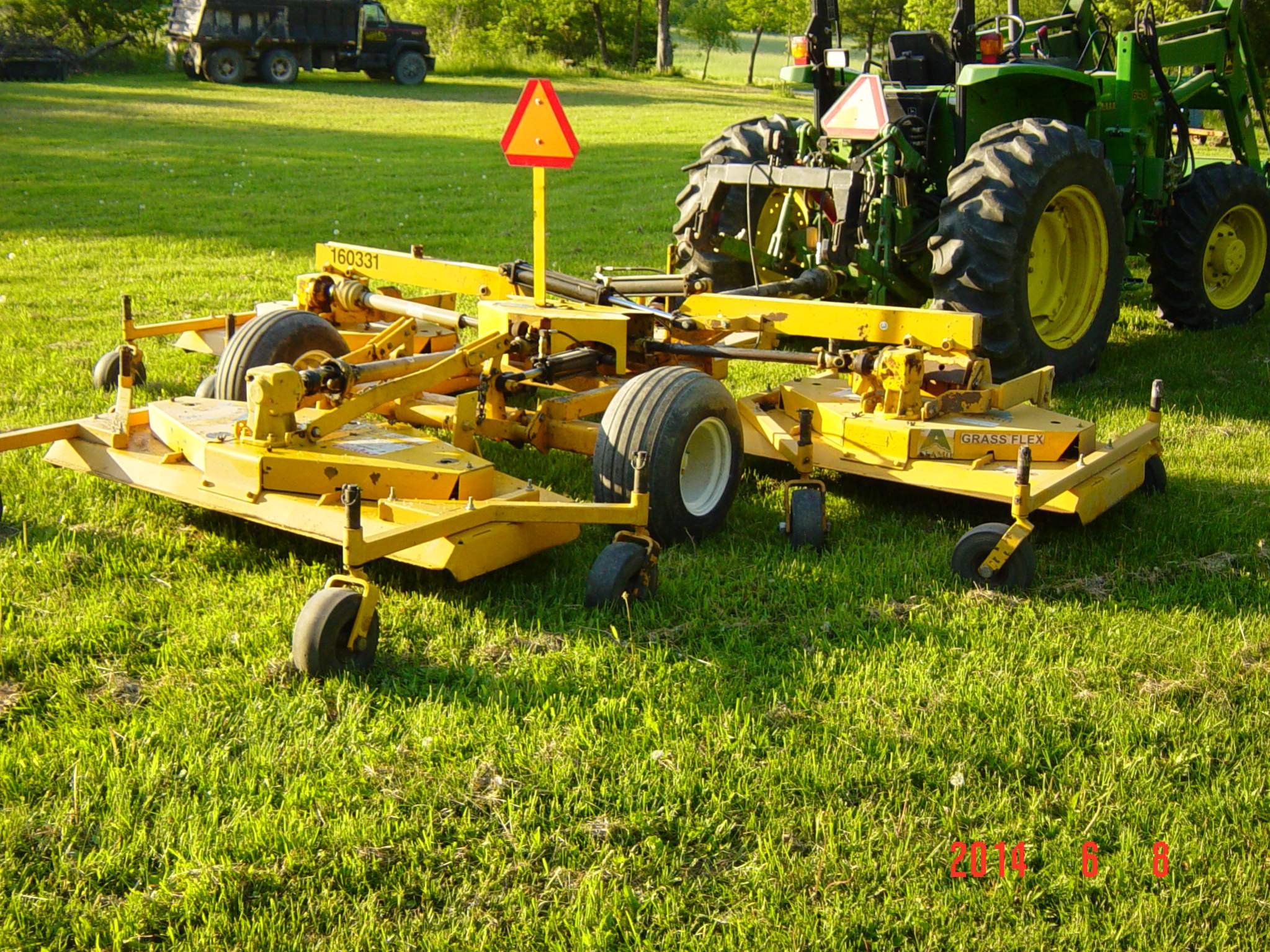

I bought the Alamo, well, just because (at auction) and used it to cut about 35 acres of fields that farmers did not want at that time, plus a little custom work. I left my fields to the fall when the vegetation was dried out. So the grass was high, but not hard to cut. It would have been a challenge to cut foot high lush grass. If it worked, it would leave a heck of a mess. That much cut material doesn't just disappear.
I had new frames made to raise the decks for cutting fields. The originals had upward bends in them.
I was surprised at the little demand for such a mower when I tried to sell it. Years ago, I found out that the main gear box on this thing was six grand, a lot more then I got for the machine. It was a real rush to use it, but I was glad to get rid of it.
Looks like a nice mower and a nice cut in the picture. Why were you glad to be rid of it? What do you use now?
Another question: I see what I assume is your JD 6200 in the photo. Multiple people have told me get a smaller tractor (45 PTO) for finishing mower work. They said too much weight on the grass is a problem, and limited maneuverability, etc. Any problems using your bigger tractor for this work?

I used the Alamo with the JD 6200. Since I did field work, compaction didn't matter. The 6200 is very, very hard on turf, just chews it to bits! It was also nice to be up high, away from the dust and action.
I got rid of the Alamo, because it took up room and I really had no further need for it. The cash croppers want every last inch of land now.
