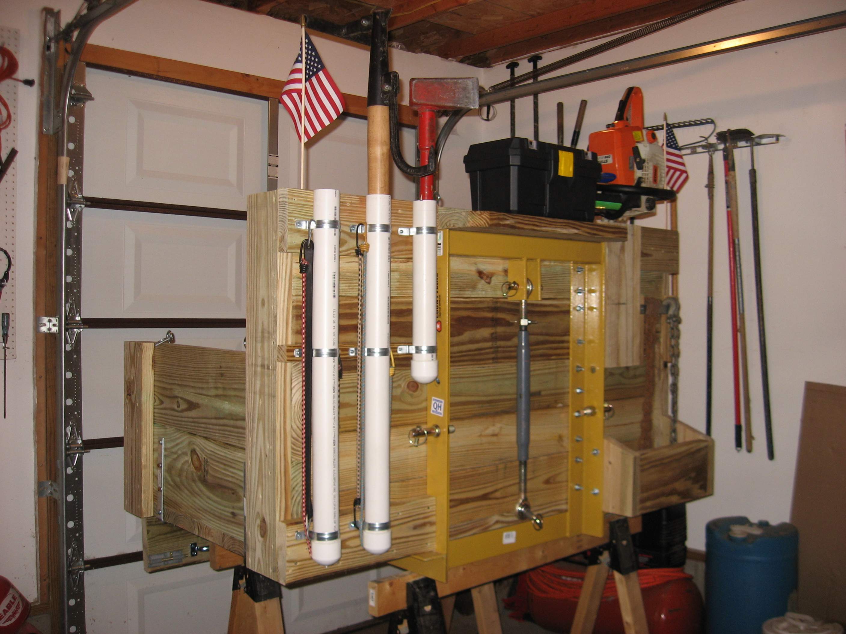

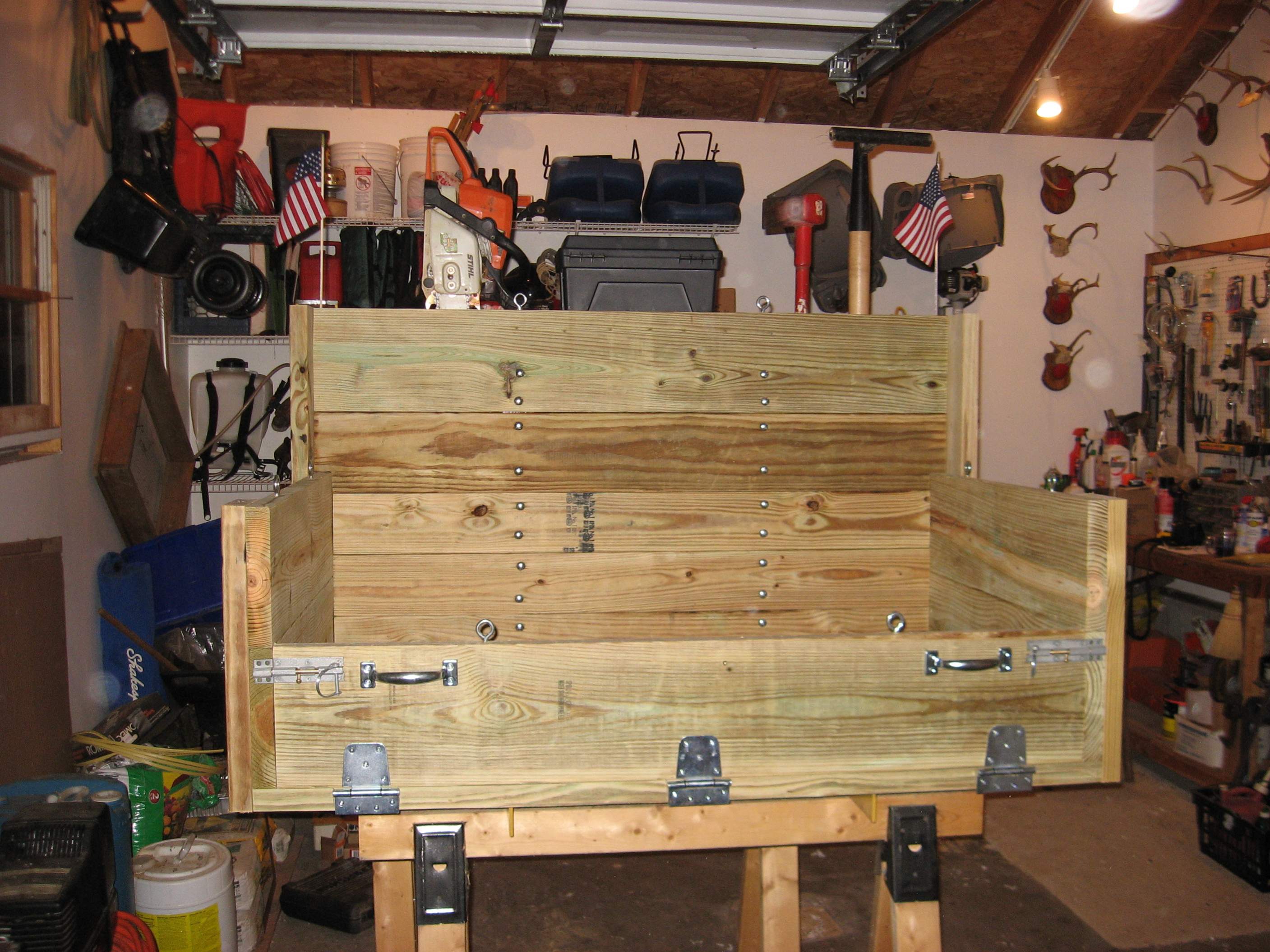

Thanks to those who have posted their own projects and especially Wilson Outdoors for a few great videos on the subject. I finally decided to build my own carry-all for my Kioti CK30. I wanted to have fixed side boards so that they would take the weight/abuse of firewood and rocks bouncing around since I live in some pretty rugged country.

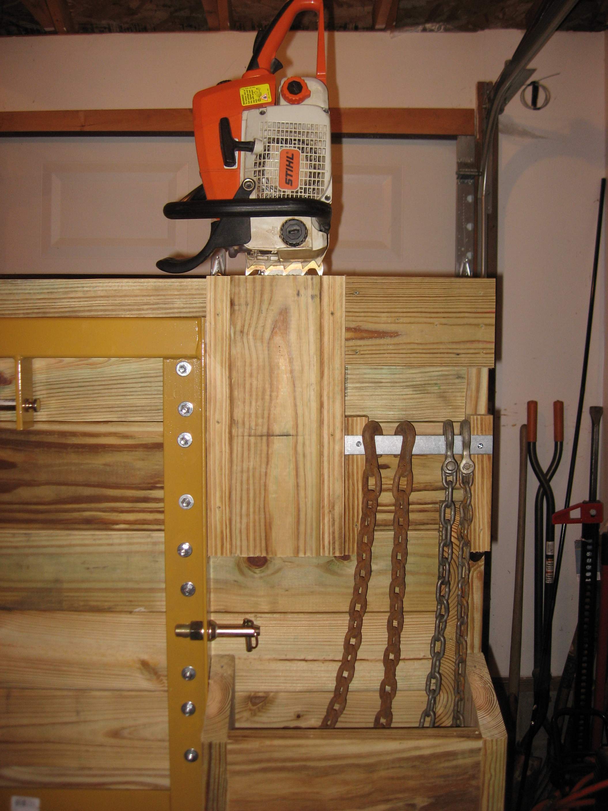

I installed a drop away tailgate that I hope will allow easy dumping, and installed a few of the ideas that I've seen others do such as chain storage, tool storage, chainsaw scabbard, and eyelet bolts for lots of tie down points. Have not added up the expenses yet but I think that I spent around $250-300.
Hope that this helps some who may be planning a similar project,

Go to youtube and search for "Wilson Outdoors". They have a really nice 6 part video series on building this carry-all. Each clip is less than 2-3 minutes long and I used their ideas as a starting point for this project. Can't wait to try it out this weekend!
Please let me know if anyone has any questions on this project as it was a blast to build. Took me about 8 hours over the last two mornings before work.

Nice job -- the one thing I found to be a great addition on mine was a set of HF casters mounted to the bottom so I can roll it around full or empty -- just a thought:thumbsup:
/ Nice Carry-All Project Completed
#9
Will those casters work on dirt? I dont have a garage floor available for long term storage. Was going to store on a pallet and cover with a tarp....
/ Nice Carry-All Project Completed #10
They don't work great on dirt but they do work enough to help move it around. I use my carry all as storage in the winter - it goes in the outbuilding and holds a whole bunch of logging and gardening tools:eek:

Put the carry-all on the tractor yesterday and it worked great! May replace the toolbox with a few eyebolts so I can carry a small cooler in place of the tool box. I did find a problem with the angle of the wood on the chain holder. At some point, as you raise the 3 pt. it contacts the box on the top edge. I'll remove the box and make the taper of the sidea a little more steep. This should allow plenty of pivot room.
Loaded it FULL of hardwoos logs and it was great. Only thing that I can think of to add is a double action hyraulic ram in place of the top link that would allow it to fully dump!

It was so convenient to have the chainsaw, chains, and other tools with me as I drove around the property. I'd stop and load the bucket with item #4 for filling potholes, grab the gravel rake from the carry-all, notice a nice tree leaning over the driveway, cut some firewood......you get the picture.
