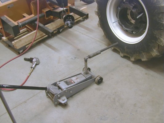

I have question for PineRidge about adding wheel weights to a NH tractor. I believe you had a link to a picture or picture of something that was put on a floor jack to lift and position them so they could be bolted on the wheels. Is that correct? I would appreciate if you could provide that link or info since I can't find it now.
I would like to put a set on weights on each of the rear wheels on a TC-45D.
Thanks.
   / NH Wheel Weights . #4
This is a standard floor jack. The lift pad was removed (simply lifted off) and the welded solid steel rod substituted. It makes easy work of installing/removing weights and the floor jack will revert back to stock as well.
