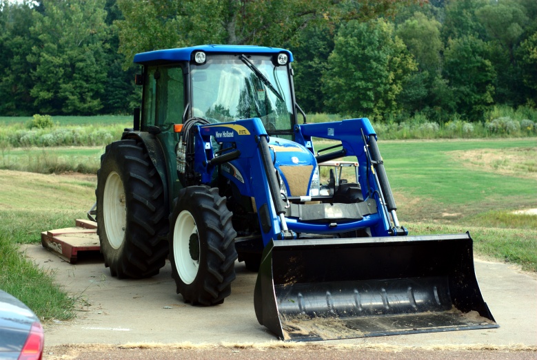

The tractor was delivered Friday evening, all set except for one minor problem they let me know about before delivery- the fuel level sender seems to have an intermittent fault and does not show any fuel is in the tank. They let me know they had already ordered parts and would set up a pick-up date to fix this problem in the weeks to come. That was fine with me.
The is a great tractor! I've been using it every day putting it through it's paces. Spent a lot of time bush-hogging, which is a novel experience for me in an air conditioned cab. Used the loader some, and did some finish mowing. I've been trying to chase down the right point to hit with silicone spray on the clutch pedal, since it squeaks really loud when pressed down. I'm also going to ask if there's a way to decrease the speed hat the loader lowers, which seems too fast to me. Minor issues.
I'm trying to attach an image of the tractor, taken after bush-hogging. If it comes through, you'll notice the brown material sucked up against the air intake screens- it's pollen and seeds. Not a speck on me, however.
By the way, does anyone know why the manual tells me to idle the engine at 1000 rpm for three minutes prior to shutdown? I think it has something to do with the turbo, but I don't understand it.

I'm thinking it's to allow the turbo to cool down.
/ NH ???? to replace Ford 5600 #18
turbo would be a good choice.. same with allowing to warm up for hyd components.. my nh7610s has a sticker on the dash telling you to warm at idle, and cool at idle before/after work for hydro and turbo health.. etc.
soundguy

Mind if I ask how much that thing set you back? Even ball park would be nice?
Wedge

#20
