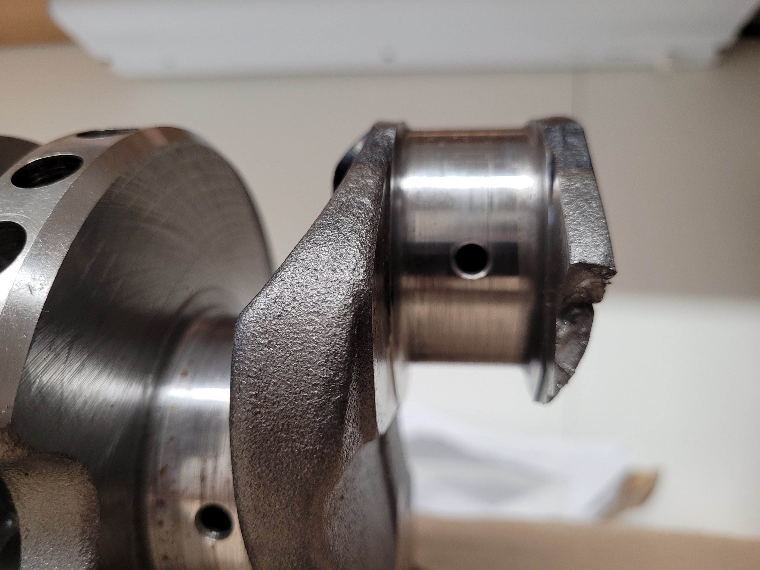

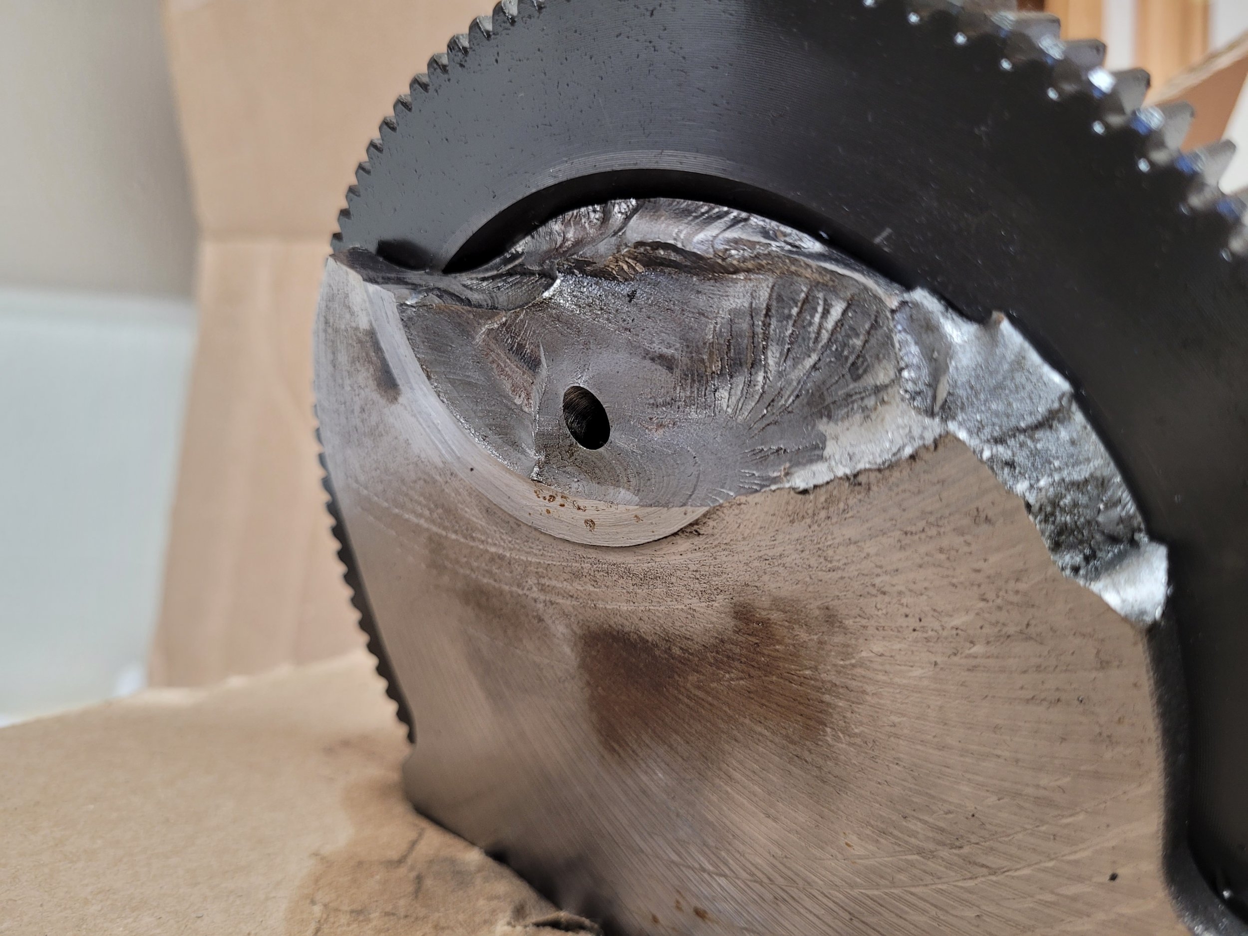

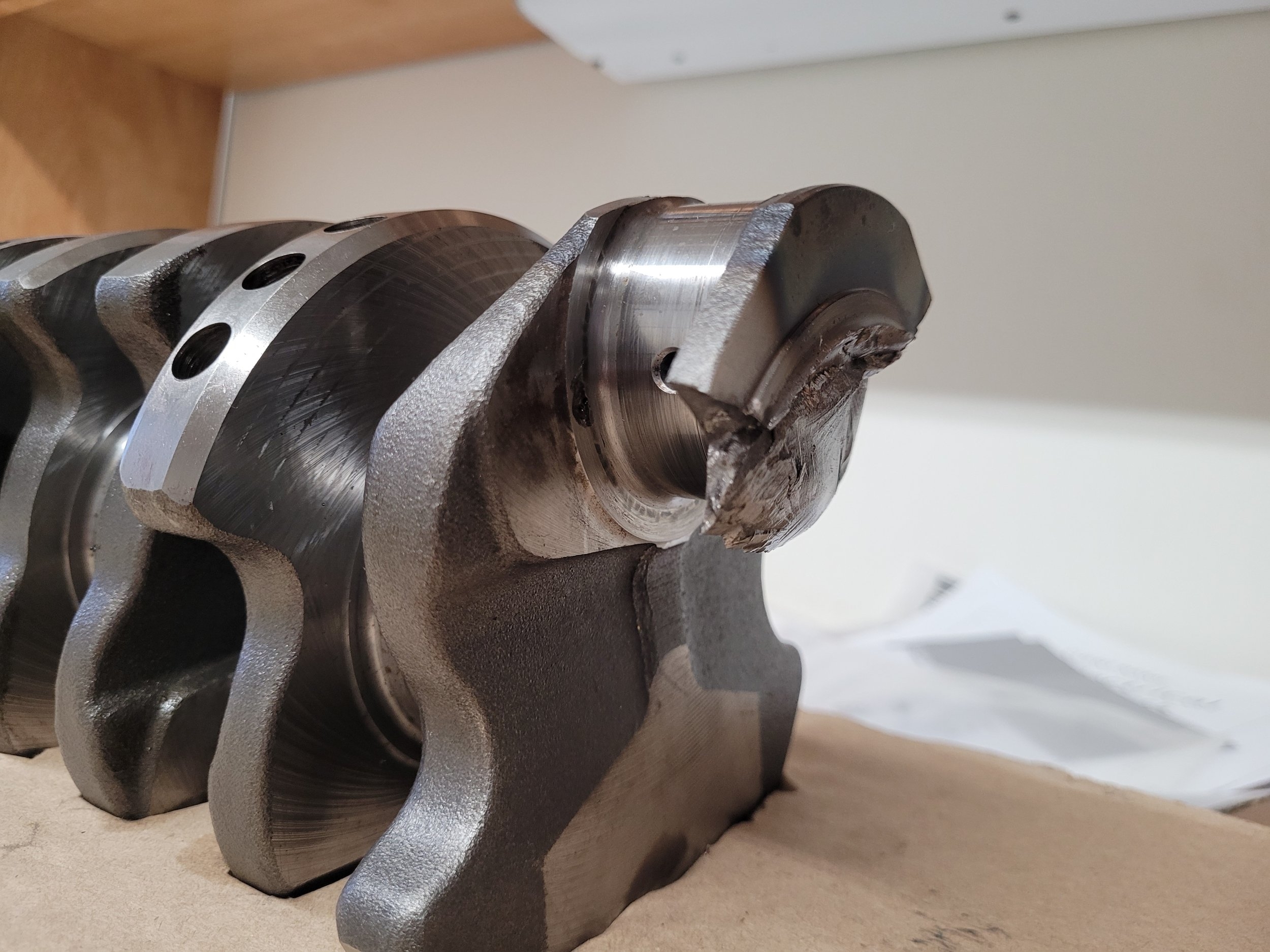

Gotcha, here are some more pics. You can see the discoloration in the area next to where it snapped.
Spoke with the shop this morning. Hopefully should have the engine back next week.
