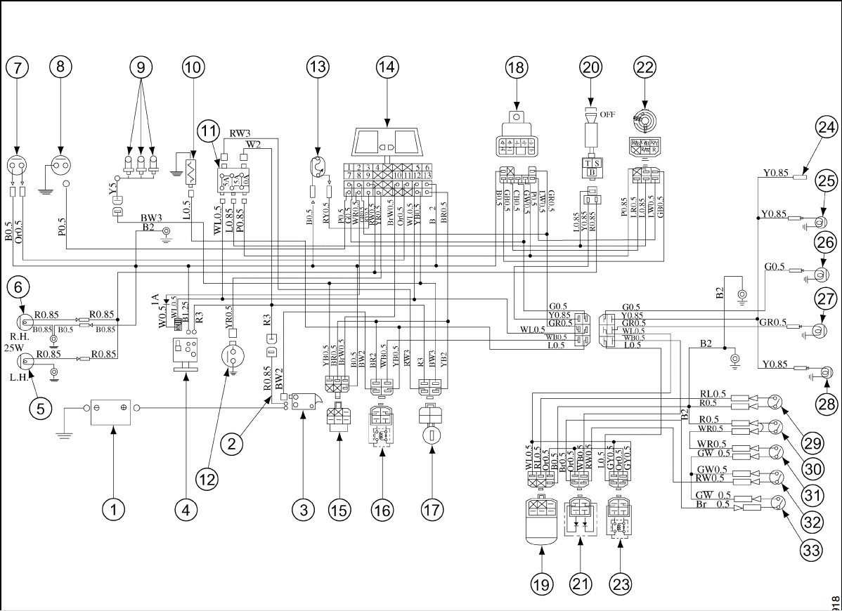

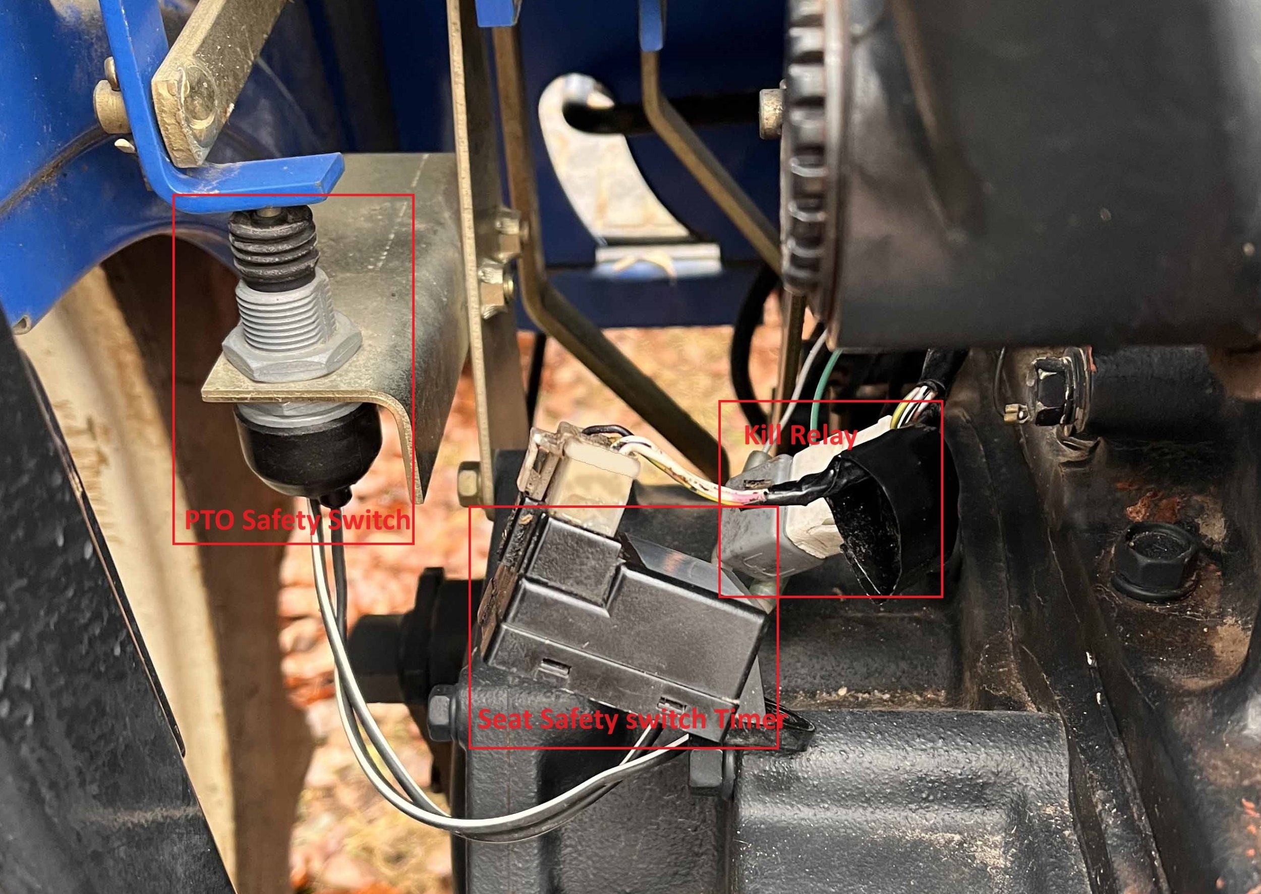

I have, what appears to be, a common issue. However, following all other's previous recommended fixes, I still have my issue.
Background: I have a 2004 New Holland TC30. HST. Starts and runs great. I can move the bucket. It will run all day long as long as I don't take off parking brake or take it out of neutral.
Issue: NH TC30 stalls as soon as I take off parking brake or take it out of Neutral (move it to Low, Medium or High).

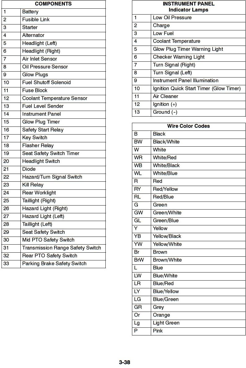

Fixes tried to date: It appears to part of the safety system, so I jumpered out the seat safety switch, jumpered PTO safety switch and jumpered parking brake safety switch. I have also replaced the Seat Safety Switch Timer. I have also checked all fuses. Note: All jumpers are done temporarily for troubleshooting and will connect all safety switches back up once I get it working.
Request: Before I throw parts at it, I am wondering where is a next place to look? For example: Ignition switch, Kill relay, wiring, etc.

Does it die as soon as you put it in gear, even without letting the clutch out? If so, its probably the weight sensor under the seat, that prevents you from starting it without sitting in the seat.
   / NH TC30 Stalls When removing Parking Brake or taking it out of Neutral #3
This is my guess, while you have "jumpered" the seat switch I'm thinking there is still a issue possibly with its wiring as its acting like your not in the seat.

Per the operating manual the issues possible and my thoughts:
1. Defective parking brake or seat safety switch - I jumpered both out and got the same results.
2. Defective key switch - I don't believe it is this since it starts and runs great. But I am not sure. I will test this next.
3. Defective neutral or mid PTO safety switch - Both tested and they are ok
4. Malfunctioning fuel shutoff solenoid - I don't believe it is this since it runs.
5. Blown 5-amp fuse - Tested OK
6. Open wiring in safe operation circuit - This is above my paygrade and will require a technician.
Am I missing anything else?

Even though you have jumpered out the switch it's wiring might not be sending (cut/open) that signal to it's relay or it's relay is defective. A number of the relays are the same so you can swap them around to see it the problem moves with the defective one.

I also recall that these relays require a full 12V feed to them before they will make good contact. You might want to double check the wiring and harness connections on the relays.
