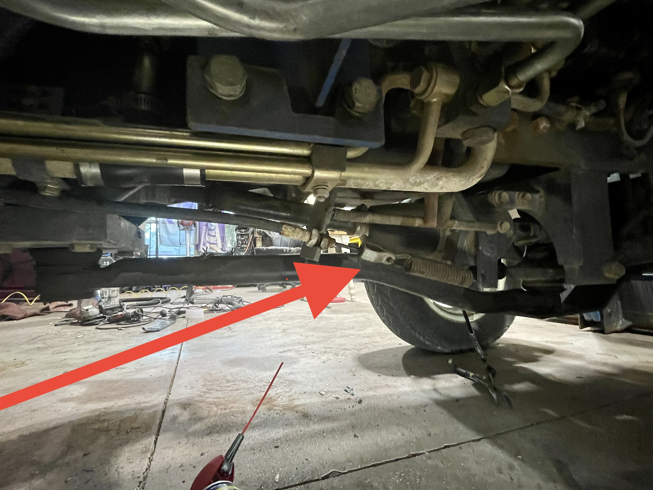

I bought this yesterday, so I’m servicing it. It’s been sitting for the last 15 years.
This is my first NH and I’m learning what pieces are what and what they’re.
What are the pieces in the pictures for? What is the function of this piece? And how on earth do you get to this grease zerk?? I can’t get a wrench in there to turn it 1/4-1/2 so I can.

The linkage in the 1st photo is the associated to your "super steer" model of tractor. It is the bottom pivot point of the super steer front axle. Your front axle's pivot point is actually behind the axle and this arrangement allows the axle to pivot horizontally and vertically with the top pivot point stationary and the bottom pivot at the end the long linkage. To understand this better, jack the front of the tractor at the front bumper and see how the axle moves horizontally and vertically.
The grease zerk is in the wrong position and should be rotated to a 4 o'clock position, how, I don't
know. It is important (top pivot point) and neglect leads to a difficult replacement.

Thank you for answering. This is going to be a learning experience lol. I did get the zerk turned with a little more cussing.

I asked about the loader because with the loader on a super steer model, the loader puts a lot of stress on those two pivot points for the front axle. Use the loader to lift the front end off the ground. Watch for play in the front axle as it leaves the ground. Hopefully it is tight and no play. If not, consider disassembly and hope it is only the top spherical bearing and not more. I bring this up due to that bearing not having been greased since new.
