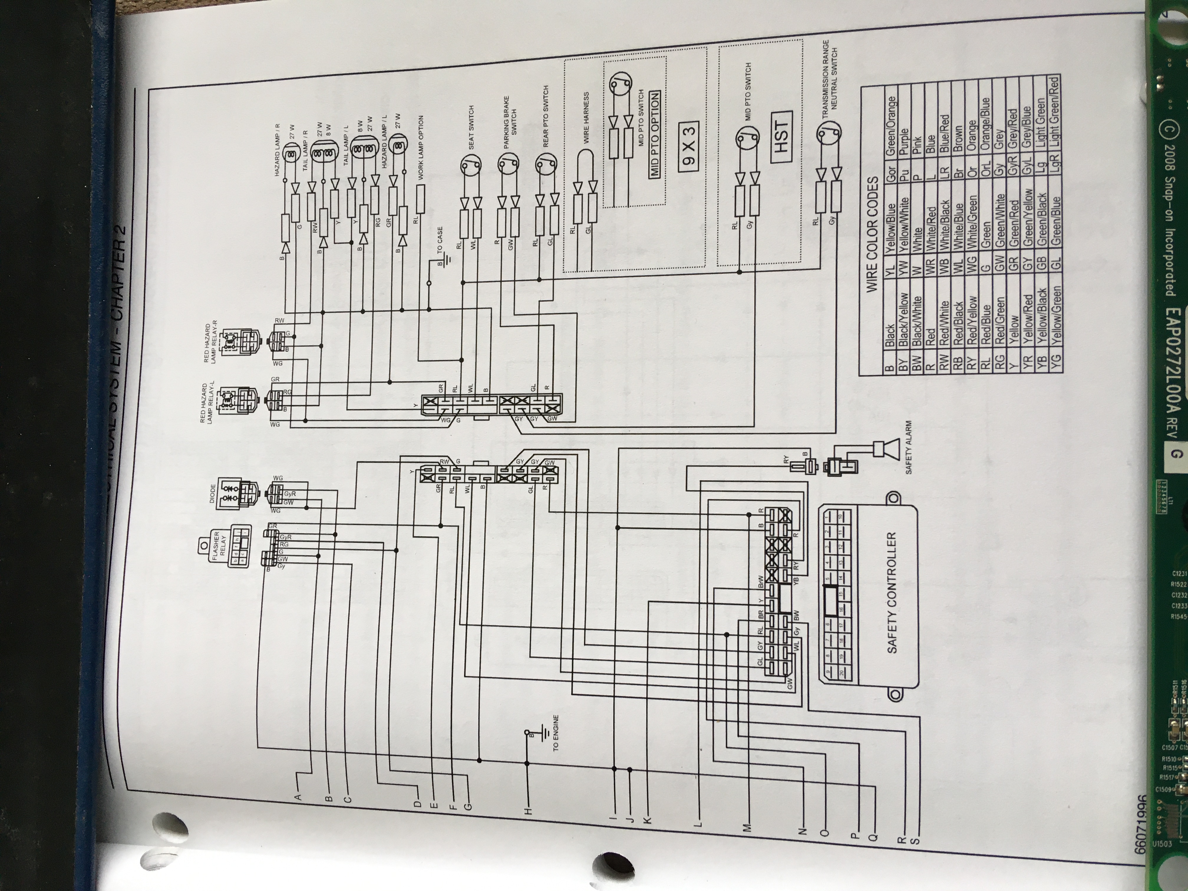

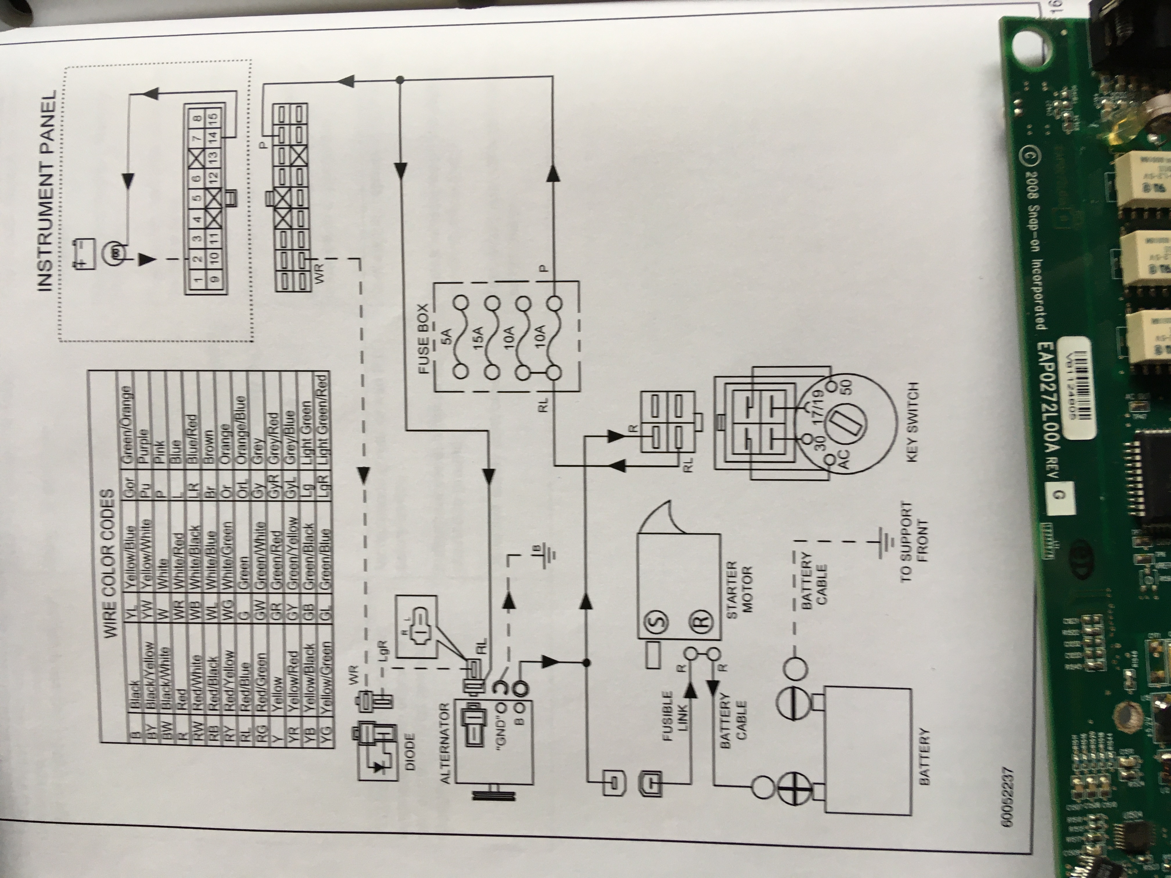

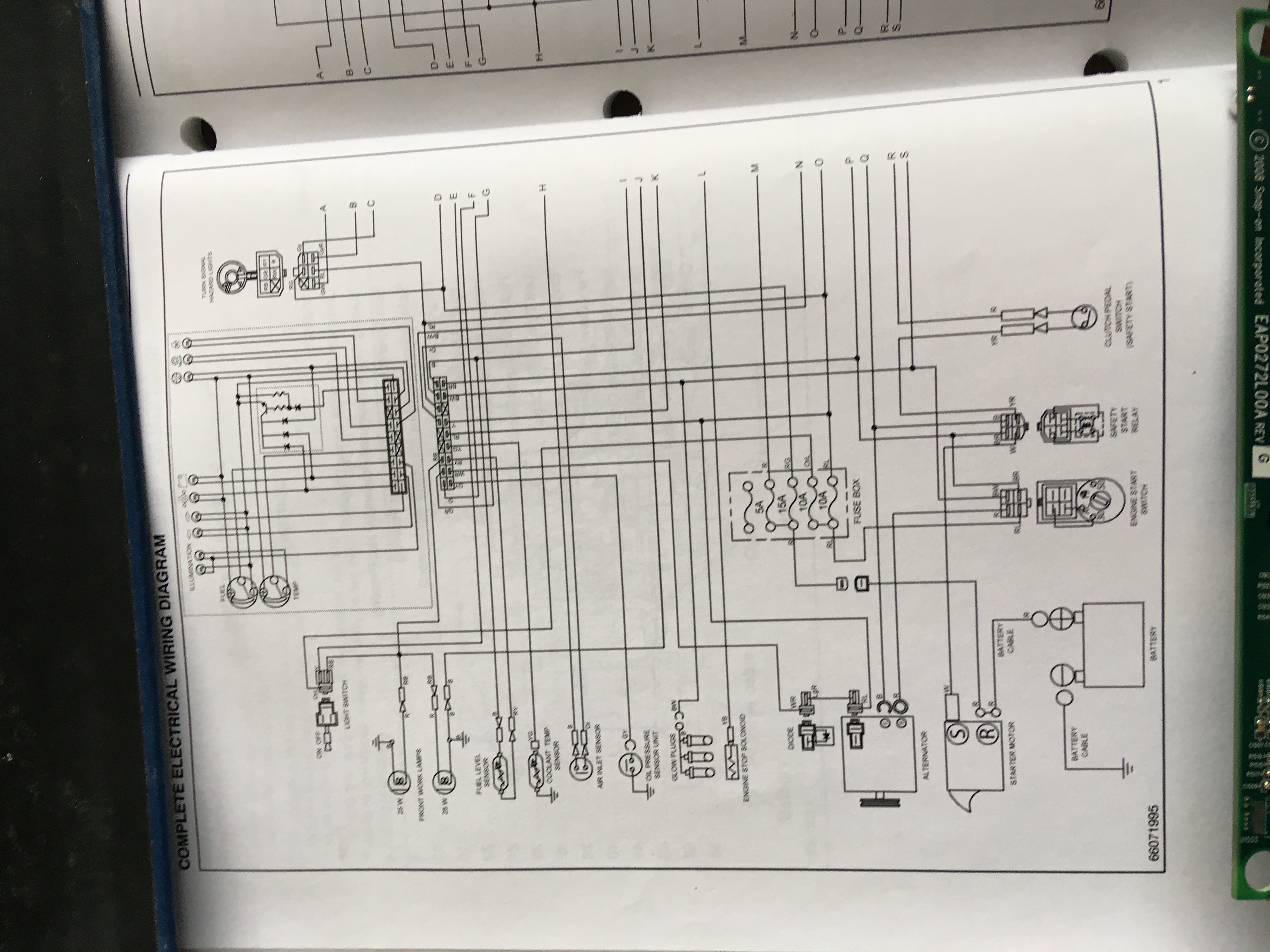

There are many pages for lighting, glow, safety controller, etc. Of ~80 page there are 15 whole or partial circuit diagrams. Here's 'complete' and 'charging circuit'.
View attachment 648299 View attachment 648300 View attachment 648327
There's a diode dangling behind the alternator that's there to prevent voltage from back-feeding to the IP and to use fewer wires o'all in the harness. It can be tested for volts going in one direction and not in the other with a $5 HFT volt-ohmeter. (Failure of such can cause wild gauge readings, and/or battery drain when parked).
Ask for more pics or pages if these aren't enough. The book has much info on component location and testing. Windows, and AT&T will do their best to makes sharing info an entertaining challenge for me. :laughing: I hope this much slips through the typical recent confonundrificationment and bit-rate bottlenecks of digital bliss. :rolleyes:

Lotta questions, Ted. Upload from phone didn't work so well. Worked fine in advanced/preview. How's this from the desktop?
I'm not sure you have a diode problems. Real 'shorts' burn fuses or melt wires, 'opens' and no signs of life. Mysterious behavior is typically bad components, or loose or corroded connections. The diode is easy to test and can cause havoc if shorted, may be like a TIA if 'open' and certain bits shut down. I'm thinking battery drain on that is a possible symptom without actually looking. :eek:
