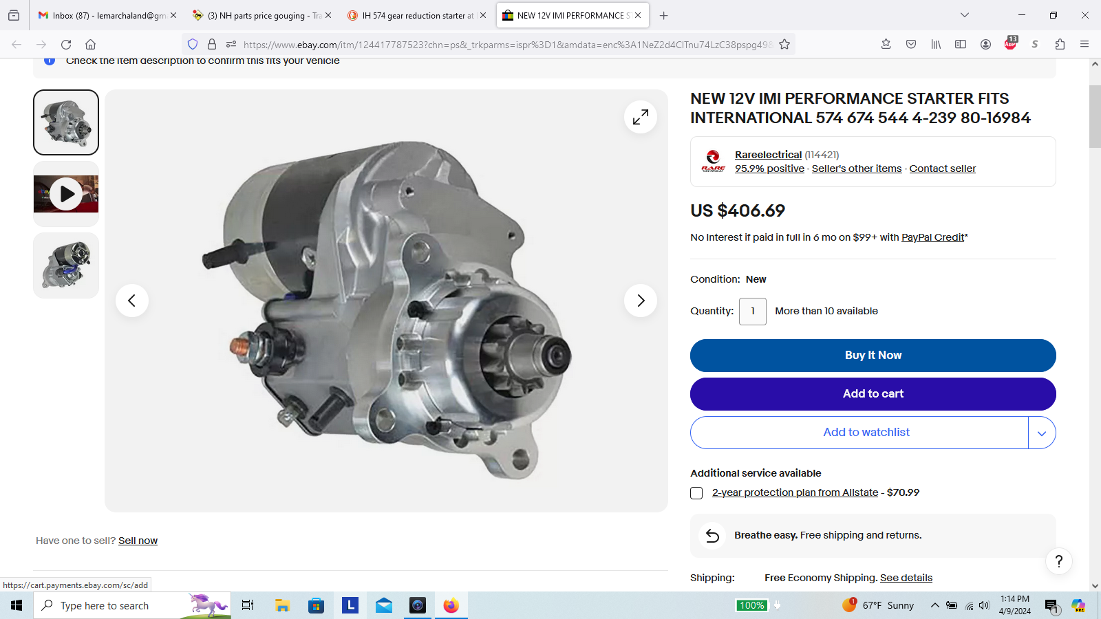

You have to choose between dealer new, after market new, dealer aftermarket, dealer rebuilt, after market rebuilt, E-Bay Amazon Walmart dot com "new" and the prices will be all over the board.
I just replaced the starter on my IH 574;
new dealer $650
reman dealer $380
Those are Delco direct drive units
After markets from $450 to $129
with some gear reduction units for as low as $130 which was what I had put on her 3-4 years ago.
I ended up with a new gear reduction unit from,
instead of a much less expensive one I had purchased earlier,
So much of the time it comes down to how much are you willing to spend and what quality do you want.
