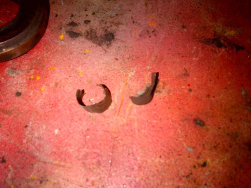

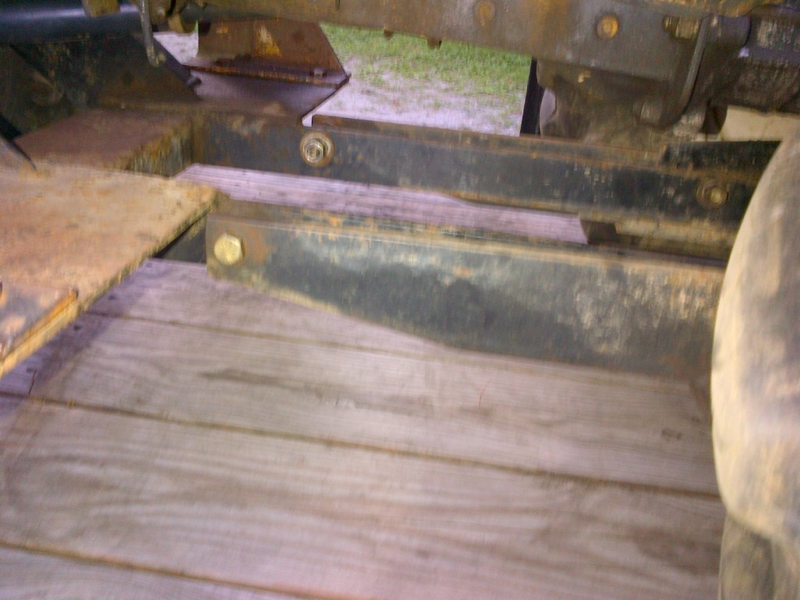

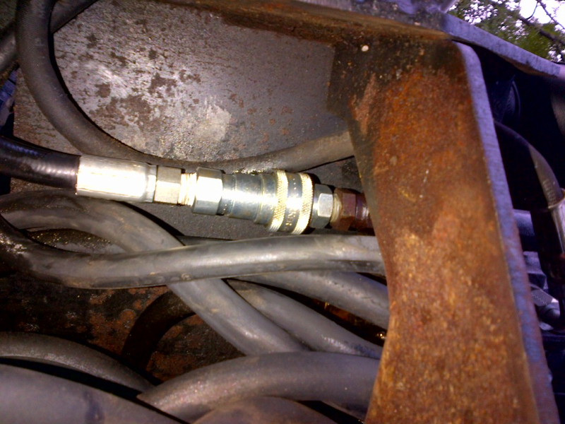

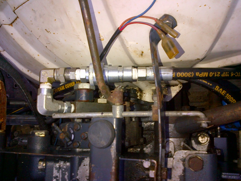

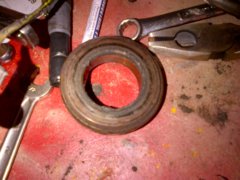

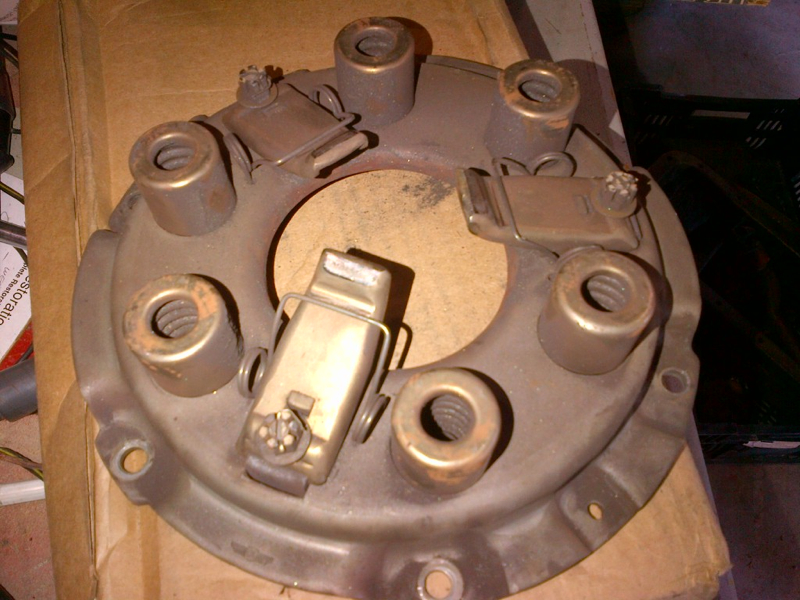

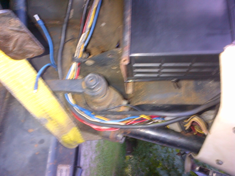

Arrived at Jim's place at 5 tonight. Jim took the time to go thru each piece of the repair in depth with me. Then he gave me some training in coupling and decoupling the backhoe. I am thrilled with the clutch performance now. Jim did a great job and I highly recommend him to anyone. As for my repairs, in addition to the new pressure plate and center bearing, he actually had my friction plate rebuilt locally. Last part to arrive was the pilot bearing, theirs a photo attached which shows what was left of mine. Other photos show the new hydraulic disconnects and the under frame bolts that need to be removed to drop the backhoe. Couldn't be simpler now. Mitch you won't be disappointed. Thanks again to Jim for the recommendation.
Forgot to mention the rewire for the burnt wiring I had, and he also replaced my missing charge light as well!

Glad your please.
I personaly like Jim and his work,
but allways afraid when giving recomendations.
Like I said his shops not much to look at,
but I instanly trusted him.
He's gotta be getting real good at these Iseki/Bolens TX's now.
Funny the only good part on myclutch was the bearing
Yours bearing was toast.
Jim also had my disk re-lined.
He tried 2 "new" friction plates one so called OEM
and said they were both junk and choose not to use them.
Showed me one of the "new" ones it was a really poor casting
where it slides on the shaft.
