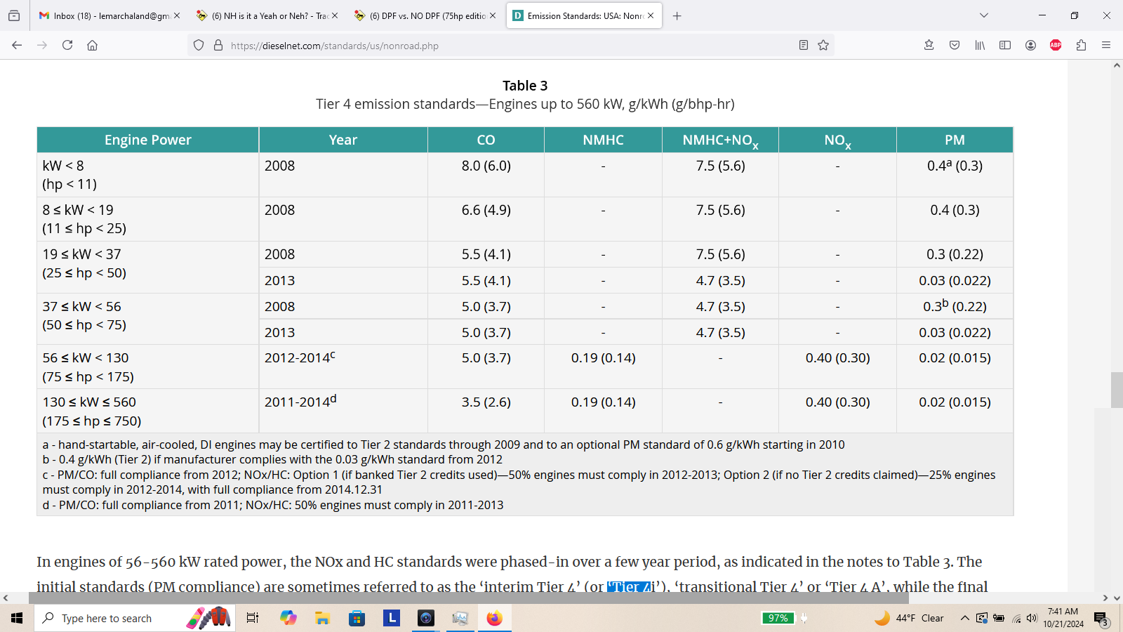

If buying used, buy something older than 2012 to avoid emissions. I would avoid 2015. As some makes were still figuring out emissions then. Just my opinion.

The NH's are good tractors as are the CIH or CNH,
I'd be tempted to go a bit older then 2015 because of the emission requirements and their complexities.
So a pre 2012 or 2014 depending upon the hp.would be the age I'd be looking at.
