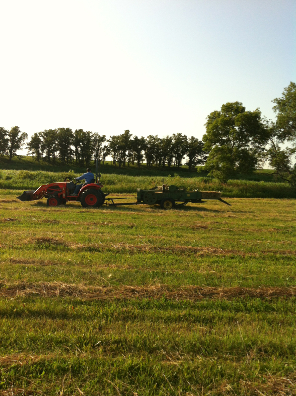

Just finished ~120 small squares with a Kioti CK25HST and JD24T. Left the FEL to add overall weight (3700 lbs) and ran in Low gear. The 20hp PTO worked well- ground was flat and didn't have any major rocking motion. If Zz says it will work- you'll be fine!

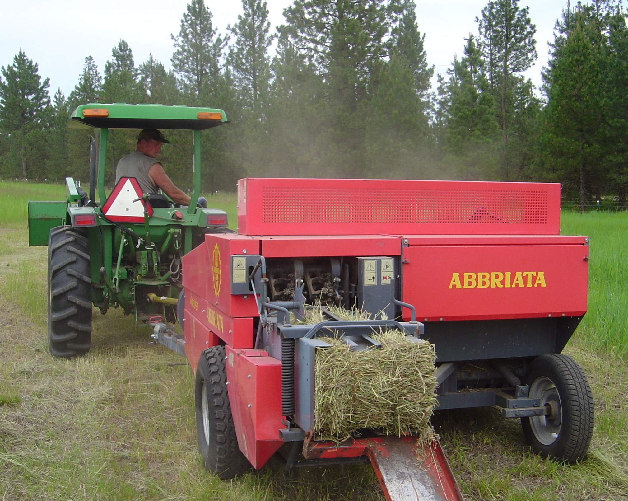

did you ever pick up this baler? I have a mahindra 4025 4wd and found a good deal on a used NH 282 baler with a NH 438 cutter and 256 rake and was wondering if my tractor could handle it.
   / NH 282 baler #13
DSC03293.jpg here is my set-up,,, Abrietta baler..only requires around 20 pto..I pulled it with my 28hp JD 870. I do 50 acres per yr.
