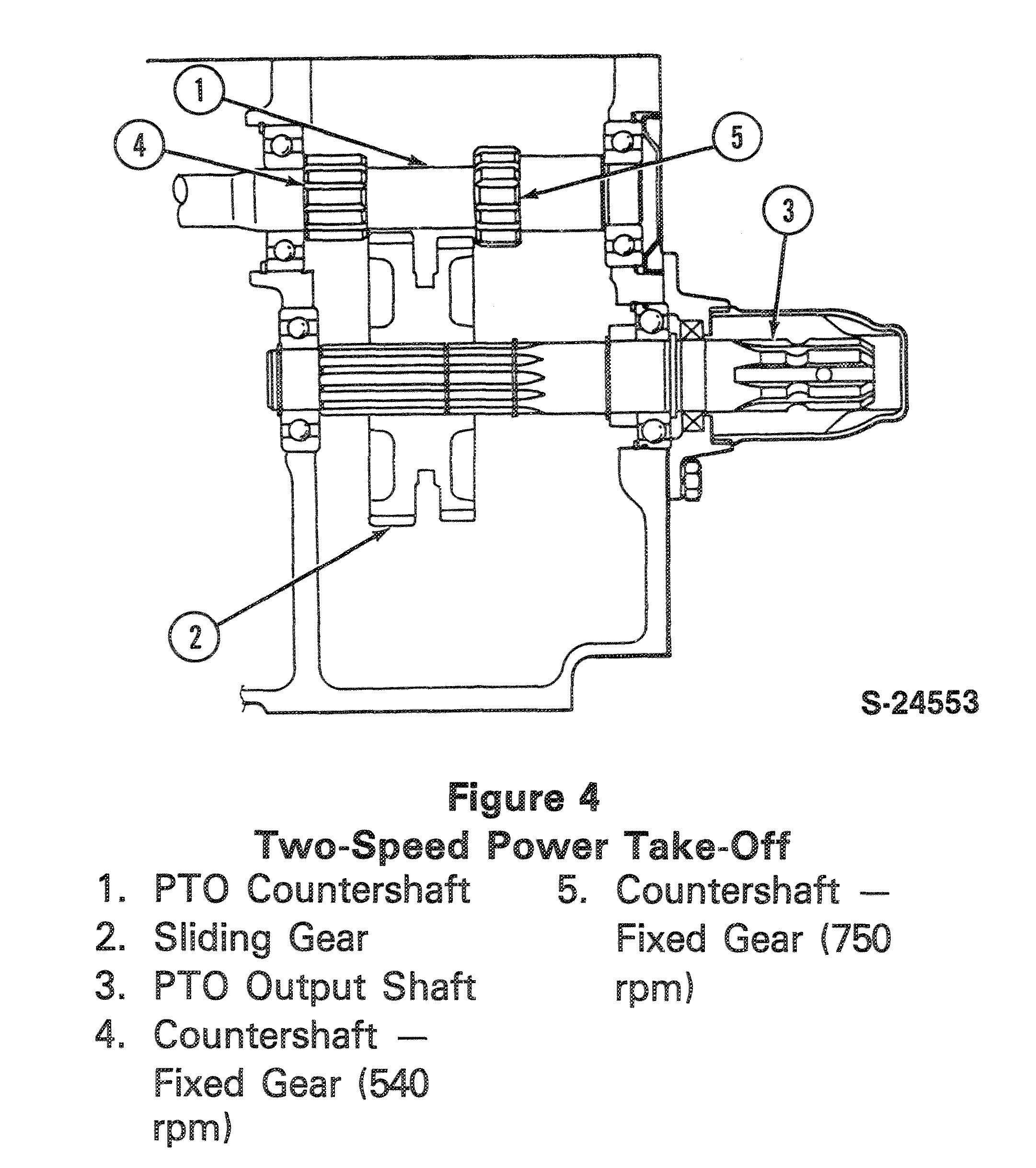

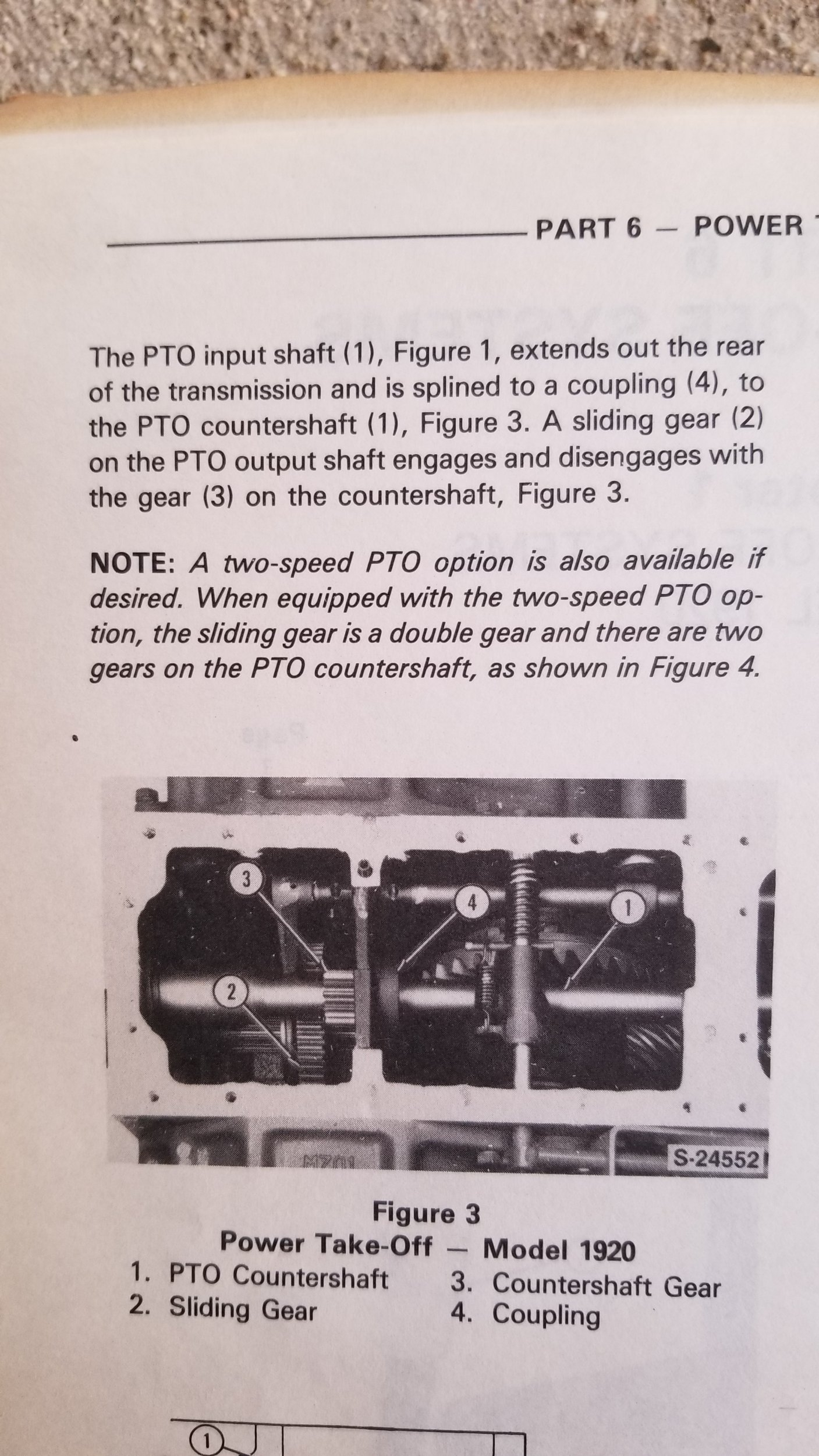

The repair manual for the 1920 (page 319) states that some models have an optional two-speed PTO but the owner/operator's manual makes no mention of this.
How can I determine if my tractor has this optional two-speed PTO and how is it controlled?
Here is the text from the repair manual:
From figure 4, it looks like the Sliding Gear(2) would move in two directions with Neutral being in the middle.
My tractor appears to only two positions for the PTO level so maybe it does not have this option.

I would imagine that was not a common option as there are few 3pt implements designed for 1k RPM that will run on that small of a tractor. But from the mechanism diagram, your PTO lever that actuates that sliding gear would have to have three positions with the center neutral. Since you just told us there's only two positions I would make the assumption that you don't have the two speed option

US 1920s did not have a two speed PTO. Those that have two speeds are 540 and 750 rpm. There is usually a lever on the side of the rear case that allows the sliding collar to shift from one to the other.

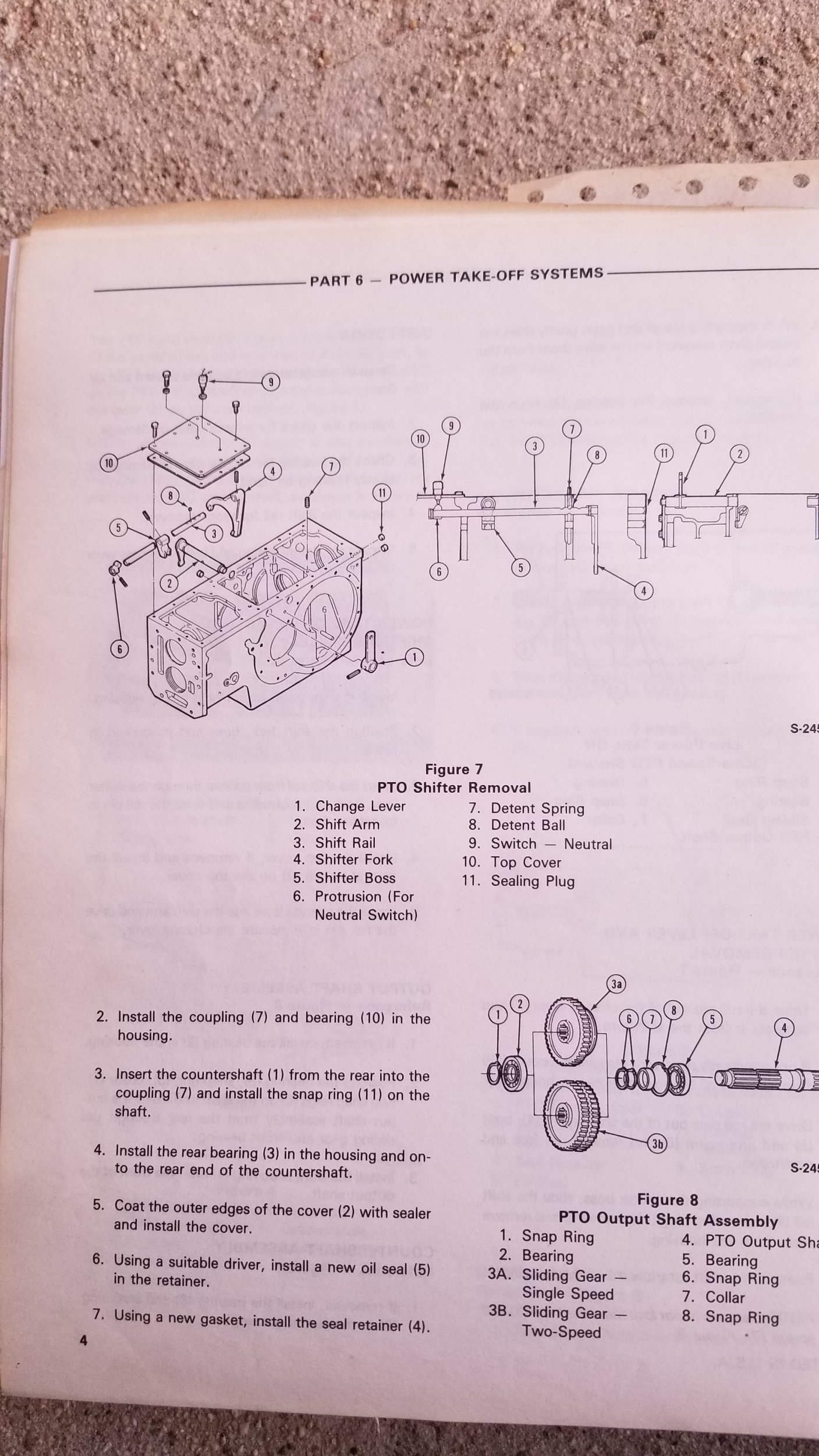

I still am not sure about the small erange of no movement you are talking about, but the lever popping out and the grinding makes some sense.
The detent spring on the PTO shift rail is not as strong or the gears that engage the PTO are really worn allowing it to slip out. This could also be why it grinds.
