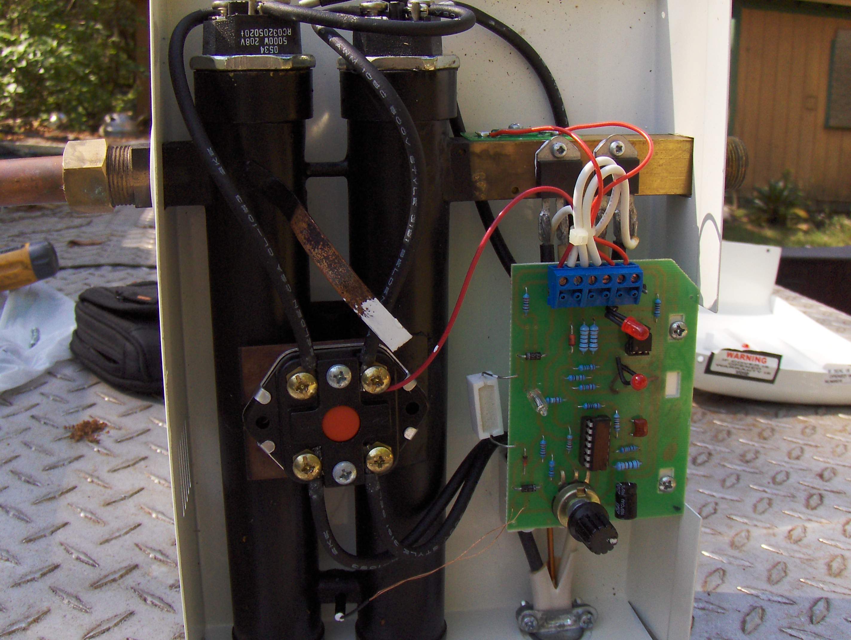

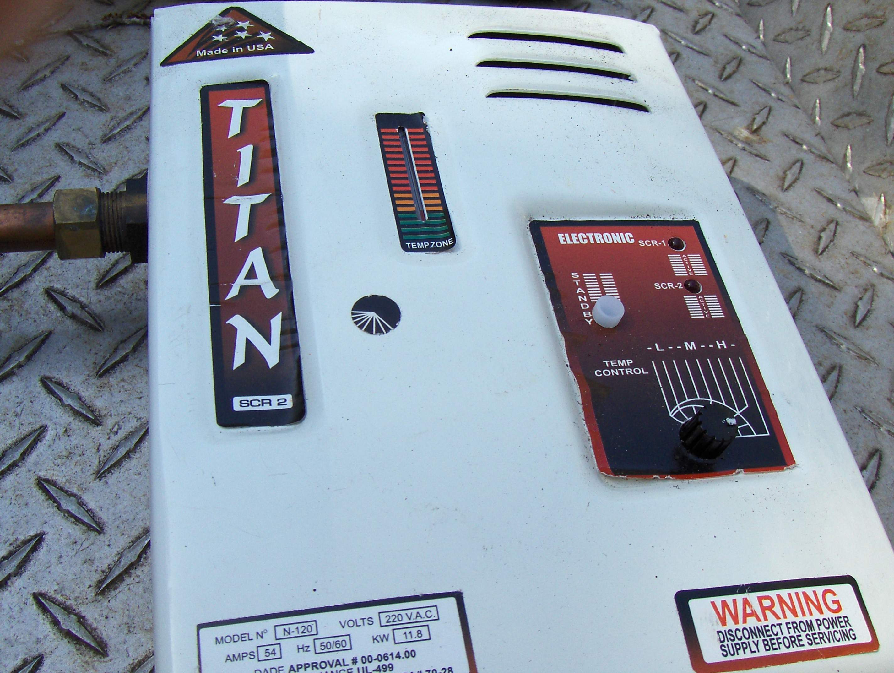

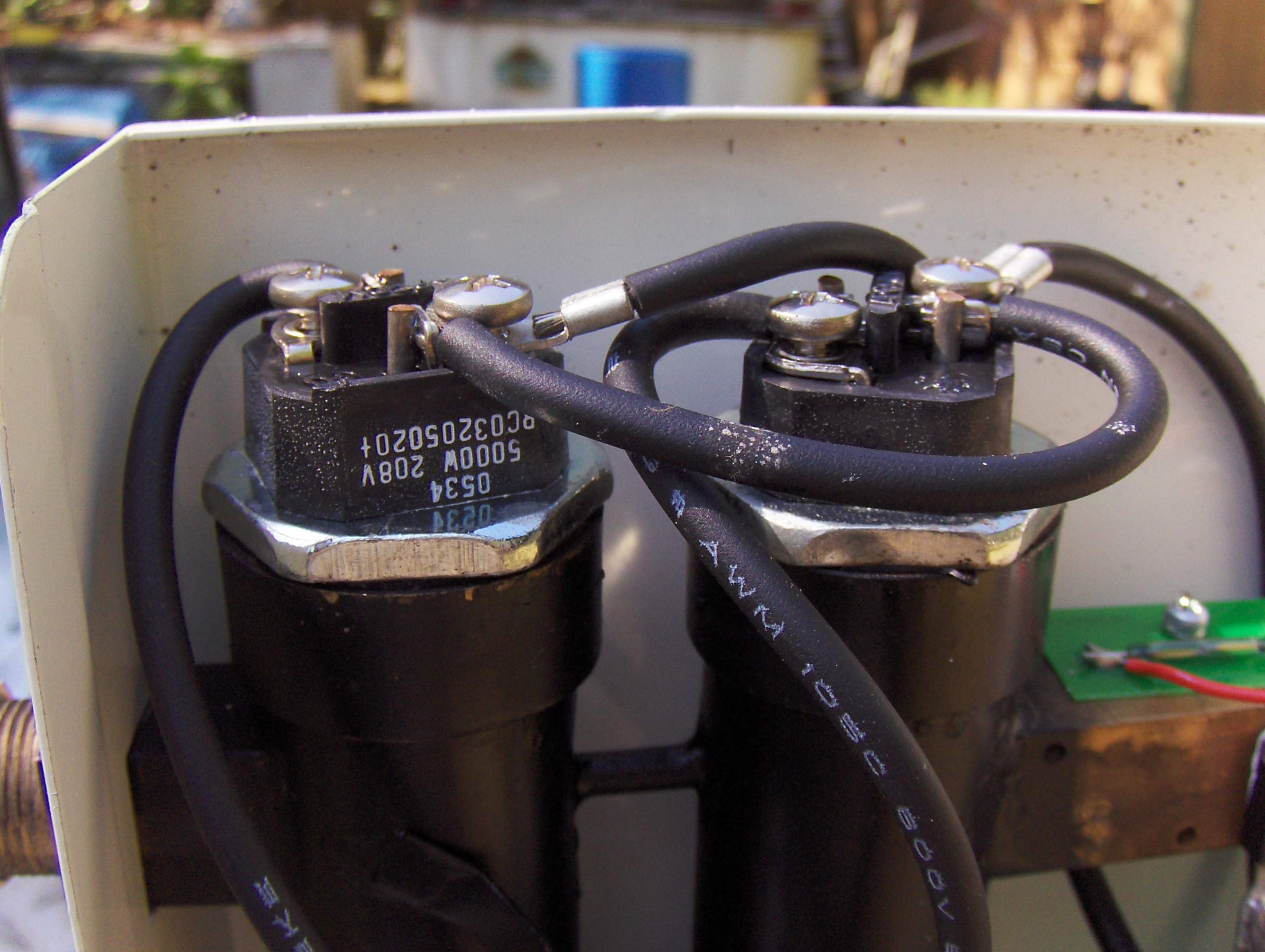

   / NG on demand water heater #26
These are some picture of one of the electric hot water heaters.
There is a 5000w heating element inside each tube, which are in series. There are some SCR to control the voltage to the elements. There are temperature sensors inside the unit and also a knob to regulate the heat.

great pictures: thanks: i tought a NG on demand water heater was a waste of money, until i priced a new NG 40gallon water heater: kinda put things into a new light. spend a couple hundred more and get a unit with a longer warranty and cheaper to operate.
