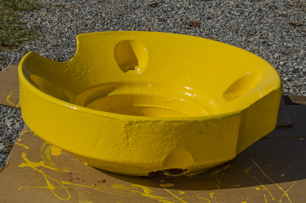

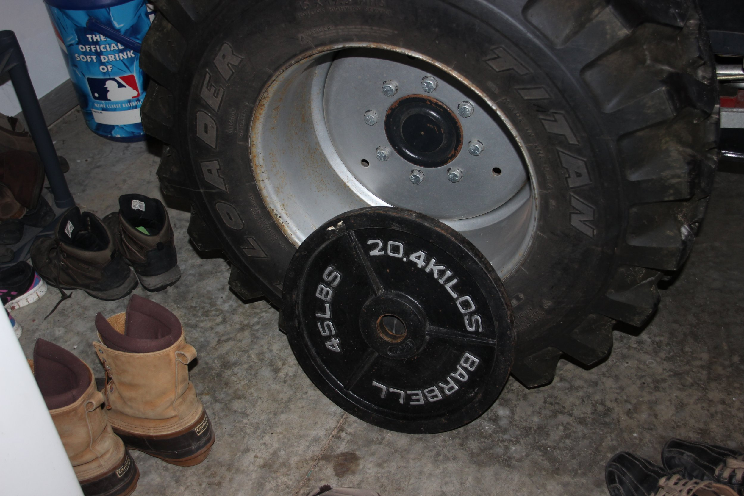

I'm going to make rear wheel weight adaptors for my tractor. I'm using bar bell weights to adapt the A Farmall weights. I had these A Farmall rear weights on my 234 IH, and the bolt pattern is now different on my 2008 Farmall 35.

I assume the adapter will be bolted in both directions? Ie barbell weight bolts to your wheel, and then new weights bolt to the barbell weight?
I ask because if you were to adapt from your wheel to the barbell center hole, you'd be 90% of the way there to just keep sliding on more barbell weights! But you probably cant trade tractor wheel weights for more barbell weights. Im all about using what you have. :)

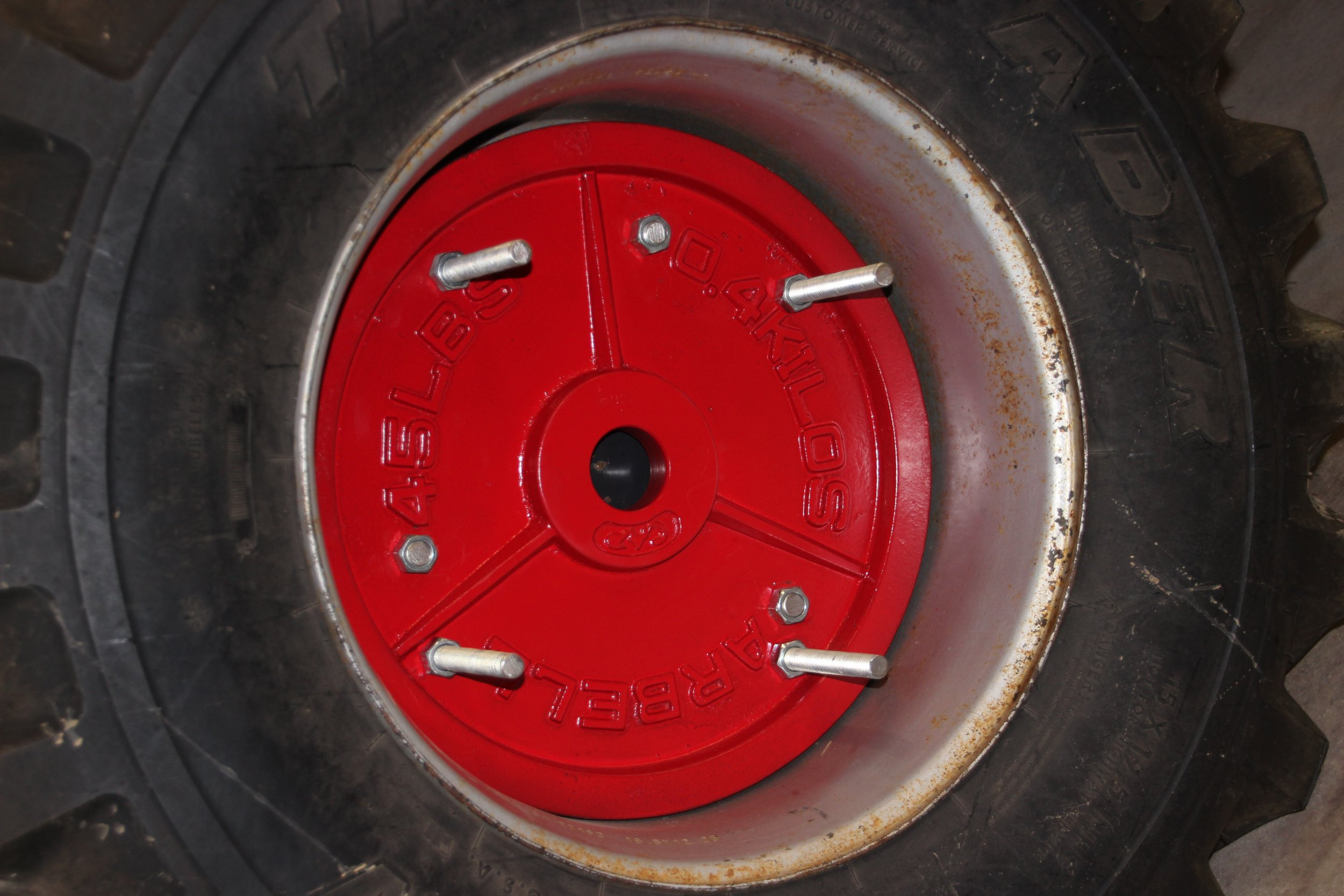

Is the pattern different? or,, is the quantity of holes different?
I wanted to add Farmall weights to the JD855,,
both had four holes, but, on different bolt diameters.
I simply took lengths of threaded rod, and bolted the weights to the wheels.
The threaded rod is at an angle,
we simply tightened each rod a little until the weight was centered on the wheel.
The weights were installed in 2016, so, they have been on for almost 6 years,, no problems.
They have even been taken off, and replaced twice due to tire issues, and they went right back on.
If you have the wrong quantity of holes, drilling a hole or two might be a solution.

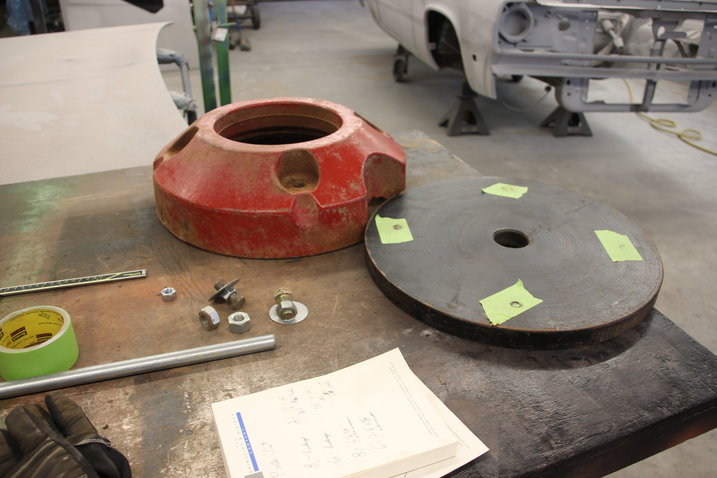

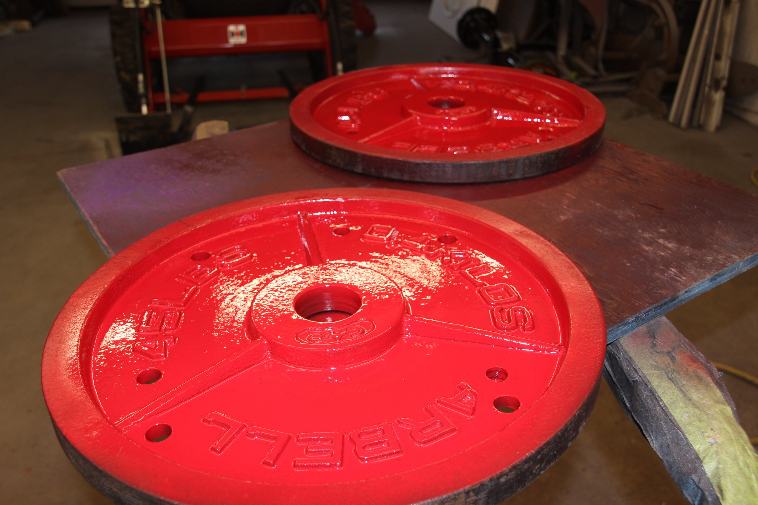

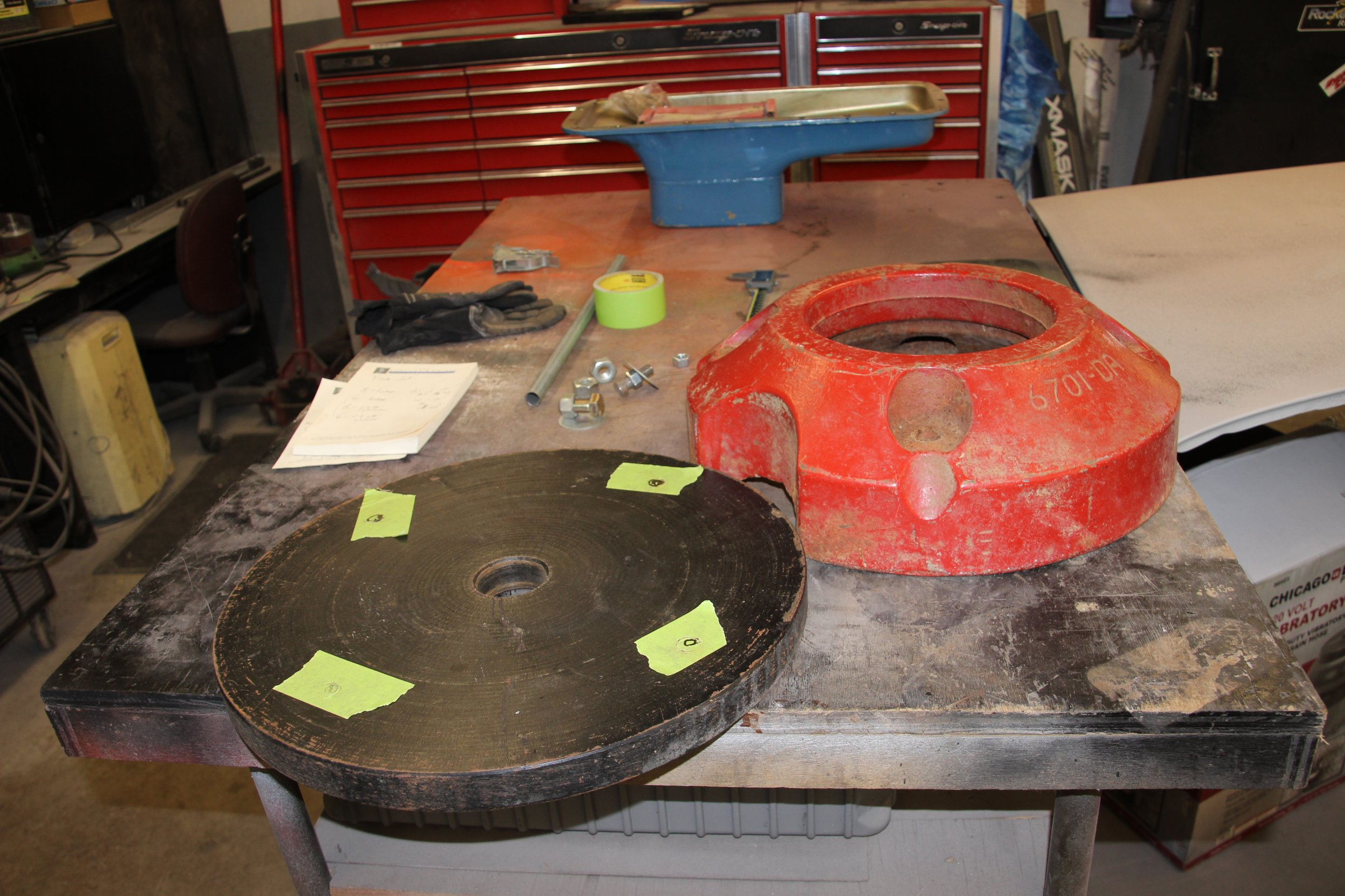

I had a bit of time to get this under way. here is a weight I'm going to use, and the Barbell weight marked. BB weight will be drilled for both (4) bolt OE Farmall weight pattern and the (3) bolt OE tractor wheel pattern. acting as the adaptor. these weights were adapted to my older 234. and I used plywood. it broke. I want it done better this time around. local steel supply quoted almost $400.00 for the 2 pcs from them. 3/4" steel. I think these cast BB weights will work well here!
will update as I go.

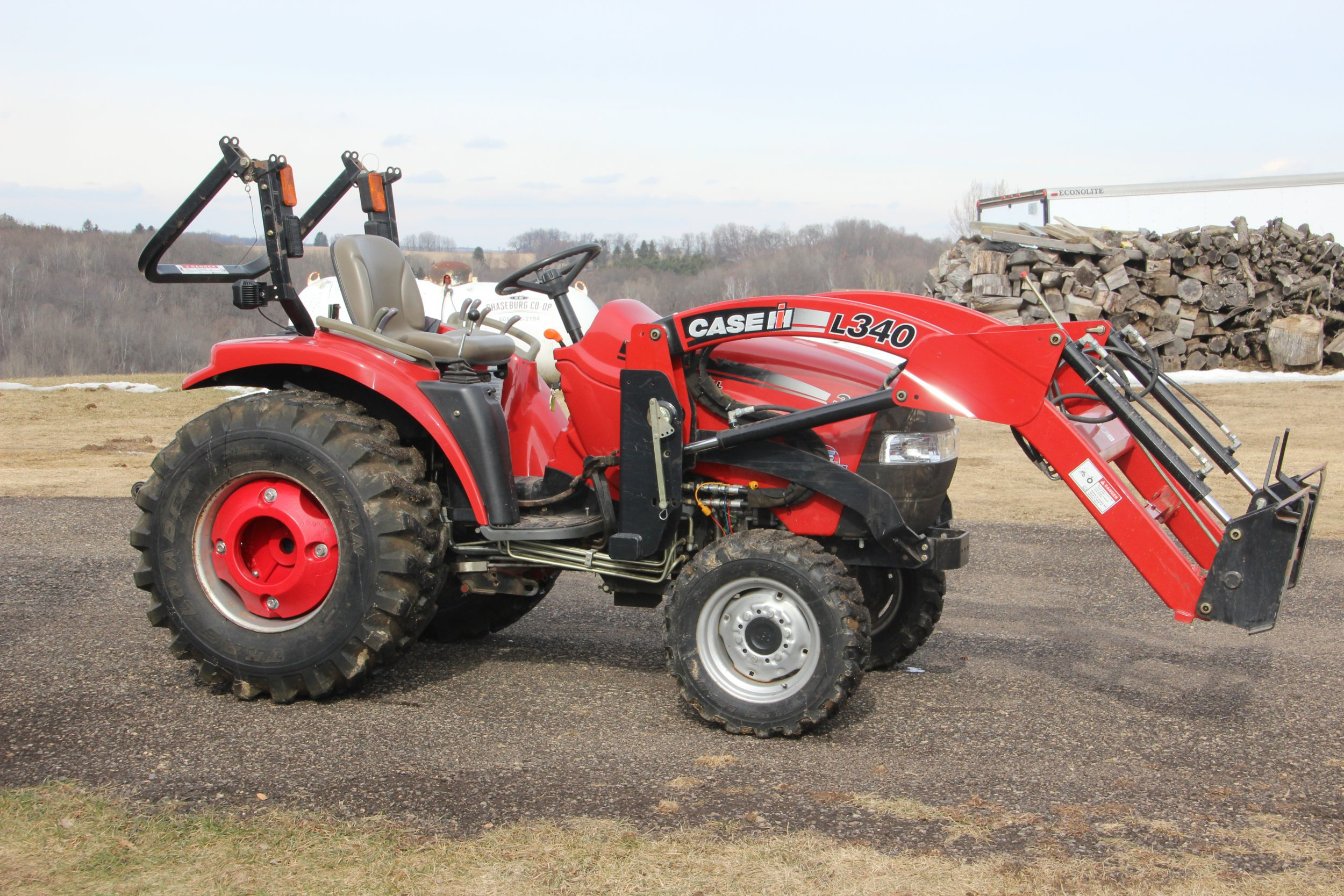

Finally made time to finish this weight project. I will need the ballast this spring. turned out nice. the weights are family farm items. they were given to me from my late Dad. he would get a kick out of this use. there is no liquid ballast in these tires. I don't want any as I mow with this tractor as well. east to pop them off when I mow.

Looks nice! Not sure what you meant about tire fill because whether the weight is in the tire or on the rim it still pushes down on the contact patch by the same number of lbs. If you mean either/or but not both then yeah, i understand not wanting to overdo it and make a problem where there was none before.
