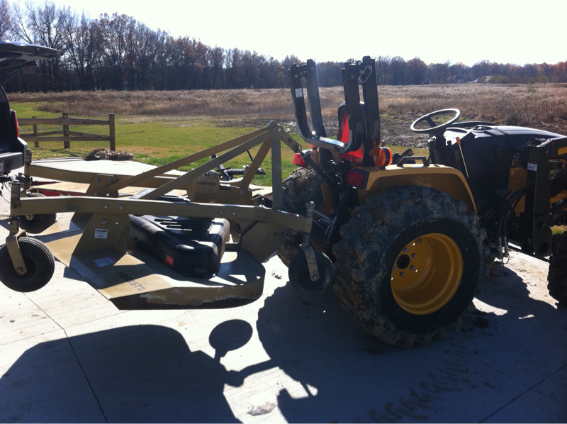

Just bought a landpride fdr2572 for my cub. The mower weighs 718 lbs and I was impressed with the liftin power of the 2900. It pulled it up no prob. Can't wait to mow with it today!

We still have 50 degrees. One last mow if the season. Trust me- 6' rear blade is at the ready for the snow!
I got the mower used- couldn't pass up the deal
