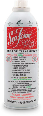

Excellent comments so far, and I don't have much to add EXCEPT that it may be worthwhile to run some Sea Foam through your crank case before you change the oil. 1 ounce of SF per quart of oil, run the engine for 30 minutes, drain and refill with a good quality oil.
Sea Foam has several products, Which one do you use?

   / Newbie with a couple questions. #14
The original Sea Foam Motor Treatment is what I've always used. Good in the gas tank or the oil case.
