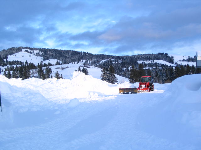

Mine in the pictures above is 45 horse. We are talking snow here not blasted rock. What you run out of is traction not horse power (assuming the attachment is matched to machine). Loaded tires and some good chains that are right for the underlying road surface and you should have no trouble. The ones I have on here are great but would not be good on a paved road.

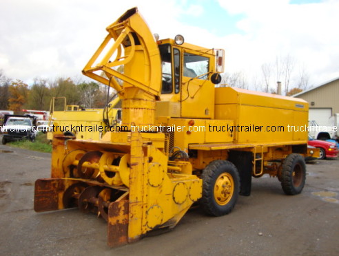

If you're not convinced that a 3/4ton will do the job, and the budget is big enough for a 150hp tractor, why not use this?
SICARD 5150 SNOW BLOWER FOR SALE IN NY NEW YORK. 1977 SICARD 5150. USED SICARD 5150.
This is a screw, not a nail - use a screwdriver, not a hammer. You asked on a tractor board, so everyone's leaning towards tractor. But the reason you see huge 8' blowers on large ag tractors in the upper midwest is because the farm already *has* a large ag tractor. This OP's starting from a clean slate - why not get the right tool?
