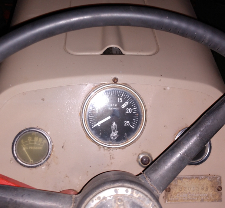

Does your tractor have a tachometer in the dash?
The hourmeter should be in the lower center of it.
   / Newbie Tractor Owner Gets An Old Diesel Tractor, recommendations for engine oil
#9
“Should” is such a pesky word. . .
