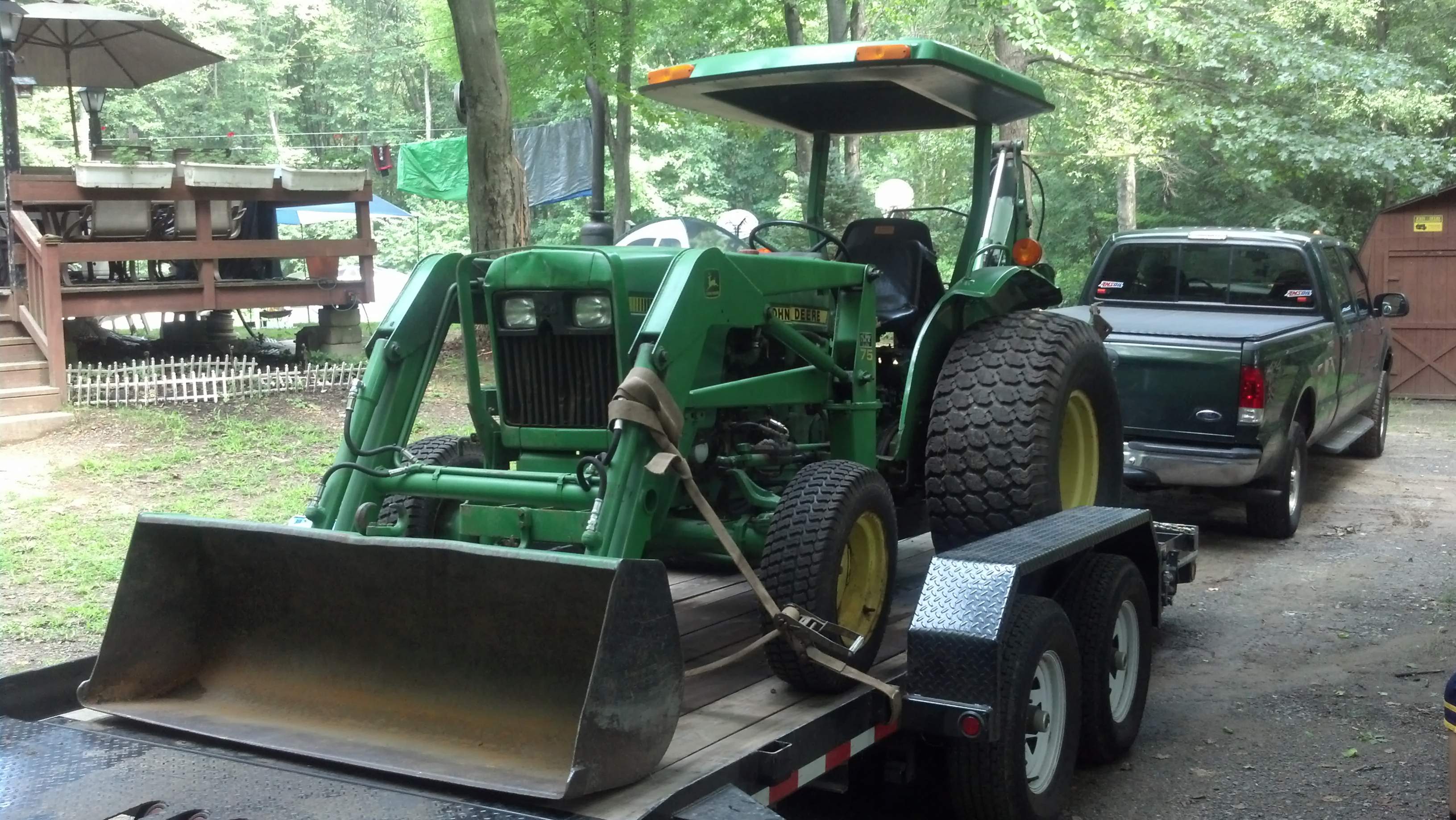

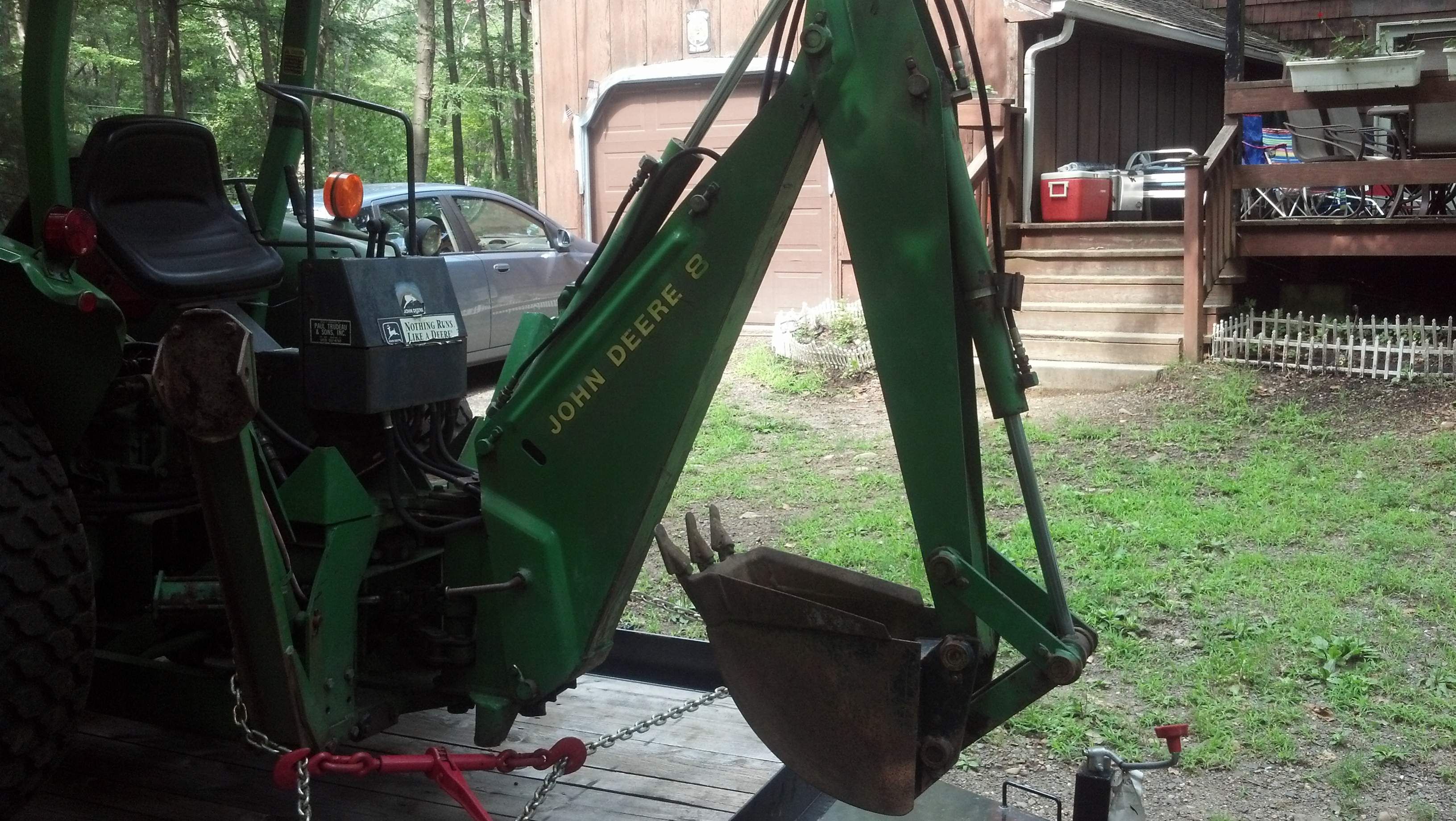

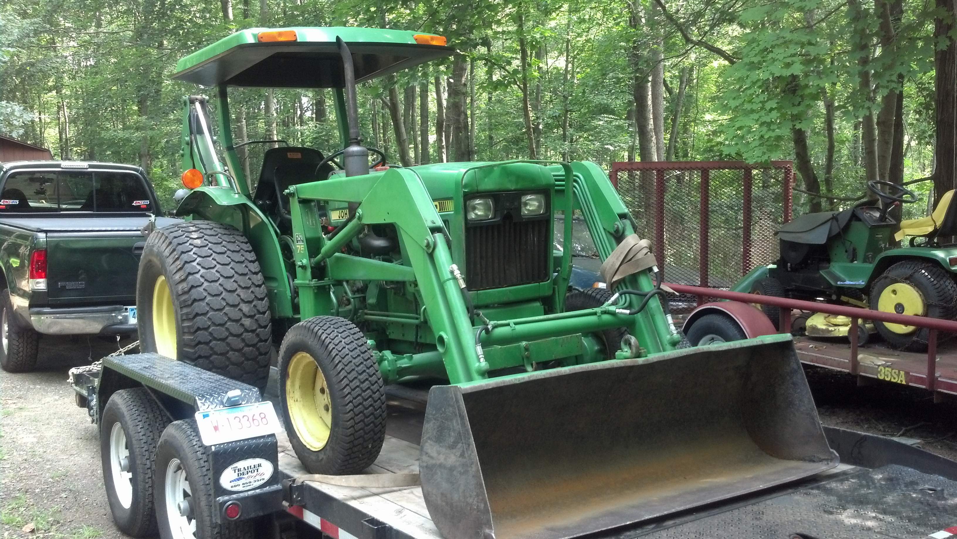

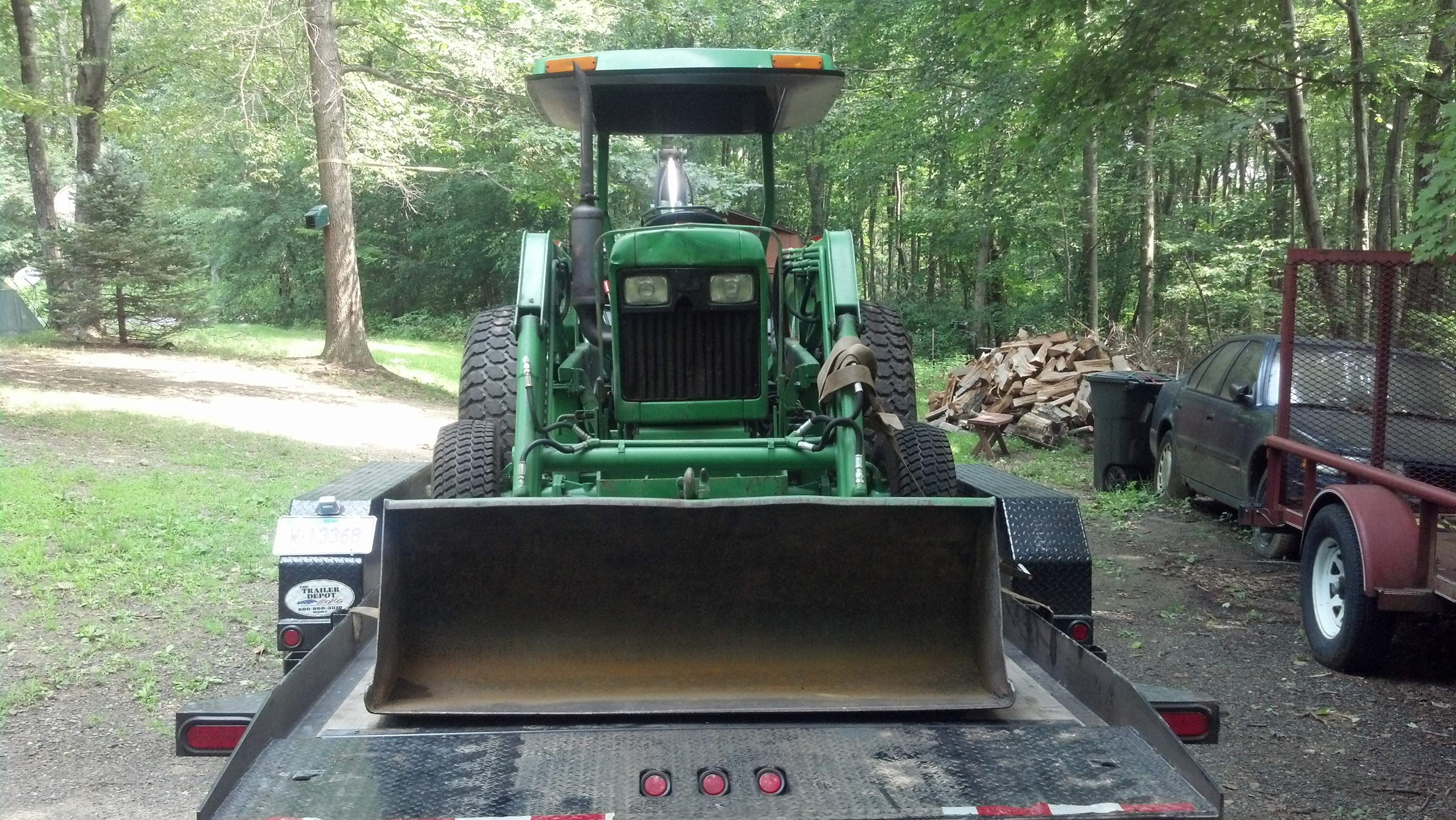

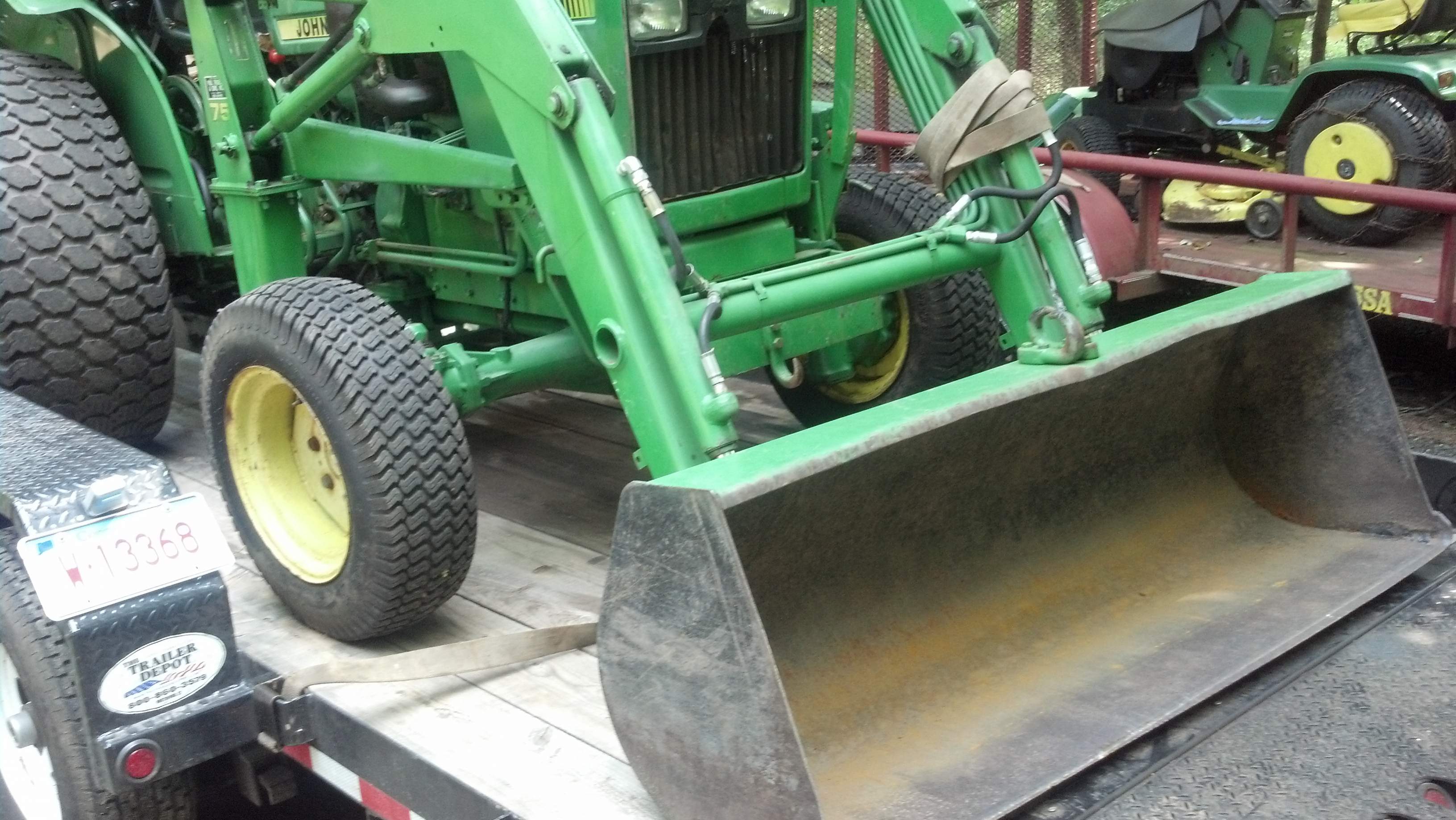

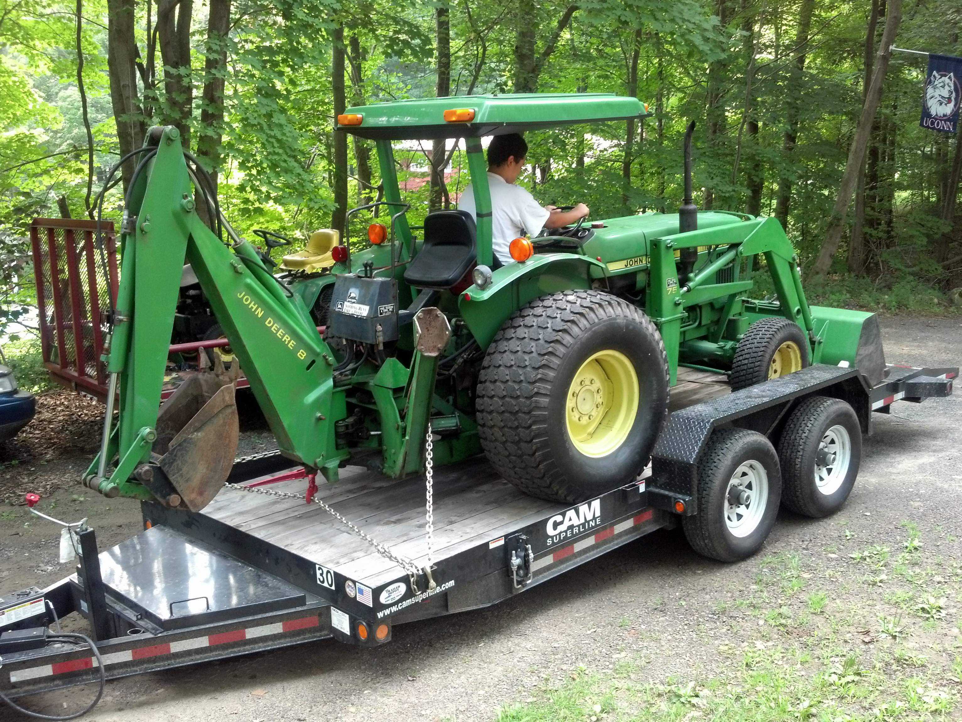

I just picked up this beauty for $8,500 on Friday.
1988 JD 1050 / 2000 HRS / LOADER / BACKHOE
I don't think I did too bad...<G>
