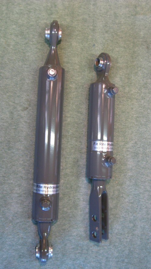

Contact Brian at fit rite hydraulics for all things hydraulic top and tilt, he's the master and a member here.
   / Newbie Question - 3 Point Hitch Top Link #13
Thanks All! I'll switch it to the top attachment point and see if I notice any difference. I've been using the box blade to level out ground, both pushing and pulling (with and without the scarifiers when pulling), adjusting the length of the top link for each operation. I've also had to do some leveling cross-slope, using the adjustable lift arm to set it at the angles I need to get a level area on the cross slope. REALLY WISH I had the hydraulic adjustable lift arm (Side Link), but it's apparently not compatible when you have the backhoe subframe.
I would like to clear up the Top & Tilt thought that they can not be used in conjunction with the back hoe sub frame on the Kubota tractors of various models. This is what the dealers tell you, because the Kubota factory T&T sets can not be used with their backhoe sub frame.
The Fit Rite T&T set fits fine with no known issues.
I have sold several sets to people with backhoes on their MX series tractors and no complaints so far. :thumbsup:
The original reasoning for the 3 top link pin holes is as earlier described, draft control sensitivity.
The other reasoning for having multiple top link pin locations, even for those that do not have draft control is the implement lifting arc or lack there of changes depending on which pin location is used.
Normally the top pin location lifts the implement basically level. This is typically where you want the top link located for grading purposes.
Another thing to know about is that the lower the pin location, the higher the implement can be lifted. The lowest pin location provides the greatest amount of arc, thus more lift height of the implement. ;)
