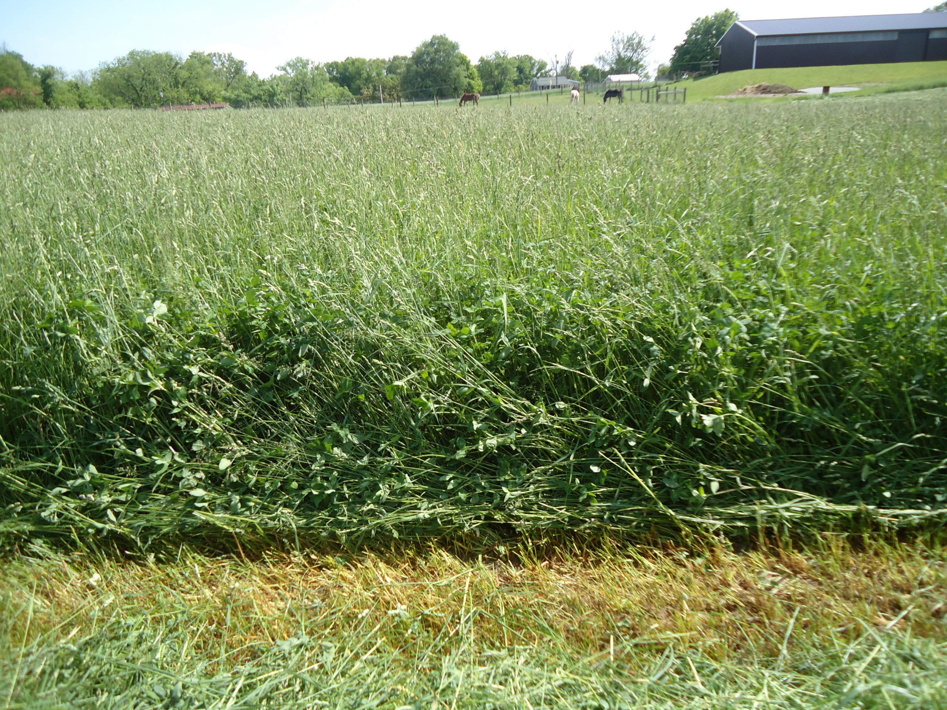

You don't say what all tools you have for making hay. If you don't have a tedder, I might suggest getting one. They can be a real life saver, especially for horse hay. You most definitely want it dry.
I cut mine Thursday, and it is very heavy. A mix of Rye Grass, Red Clover, Alfalfa, Blue Grass, and supposed to be some Tuukka Timothy in there. Clover is just starting to bloom, Rye & Bluegrass is headed out, & fine stemmed. Saw some bloom on the Alfalfa too. Got my 4 day window to make it, so cut it down. Ought to make some pretty decent hay
I tedded it yesterday morning when the dew was still on. It dried pretty decent, but will check here in a bit, and see what it looks like. May hit it again, before the dew is completely off, if it needs turned over. Then again tomorrow before raking. Humidity has dropped to 45% here the last two afternoons, with 10+ mph winds. Great hay drying weather for around here.
A fellow I worked with custom baled hay. He told me his secret to tedding hay, is to do it when the dew is still on. Hay is still pretty tough, and it will not knock the leaves off. You will get some loss the day of baling, but not like waiting until later in the day.
I'll be spending the day hitching tools up & gone over. Lots handier having a tractor & tool for each job..!!

Looks like some Hemp Dogbane in there but if you can get it cut before it seeds then you can get rid of it and a lot of the other weeds.
