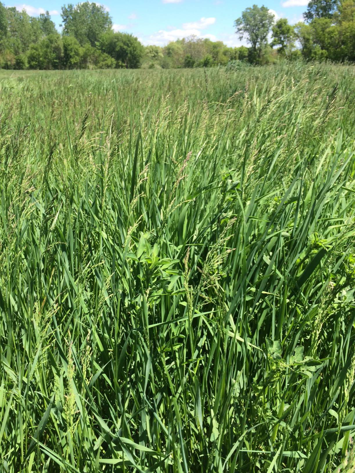

Here are some pictures of the hay today. Does this look ready to cut?
Let's hope not because my farmer with the Haybine will not be here for at least a week, weather permitting.

It's a balancing act for horse hay here. If the hay is too mature and plants have a hard stem the horses will waste it. If cut too young and tender the yield will be a lot less. Wasted again. Typically around here the first cutting is as tender as can be and the dew down for quick drying. It's a little early here for first cutting although I have seen a few folks mowing hay. Too much dew at night to cure the hay well and some possible mold. Not to mention a barn fire. A good hay guy knows these things. Your pictures appear to me that your hay is more than ready if your weather will let it cure.
