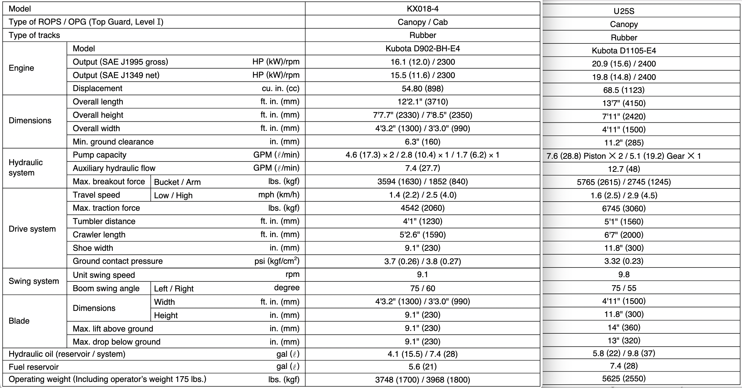

So I got some pricing back from the Kubota dealer.
The KX033 is well out of my price range, so I've been trying to decide between the U25 and the KX018.
I was leaning towards the KX018, as I don't need the zero-tail swing, and I was expecting the KX018 to be considerably cheaper than the U25, but they are actually about the same price (in fact, the KX018 is a couple of grand more expensive than the U25!).
This seems strange to me, as the U25 is 1400 pound (700kg) heavier, 8" wider, has 1400 pound (700kg) more breakout force, and 7 inches more ground clearance when compared to the KX018. So it sounds like the U25 will be much better at doing the kinds of things I want to do, yet is at a similar price point to the KX018.
So does this make the U25 a no-brainer then? I don't like the U is set a bit higher (more tippy), and the zero-swing compromises the power compared to an equivalent conventional tail swing, but in this case I am compelled to choose the U. Given the extra weight and width it would have to be more stable on slopes regardless.
Am I missing anything?

Thanks WVH and jjeff, you make some sensible points.
I actually asked the dealer about the similar pricing and he came back with a very vague answer too, it seemed he really didn't know.
@jjeff and others, here's a complete comparison of the two:

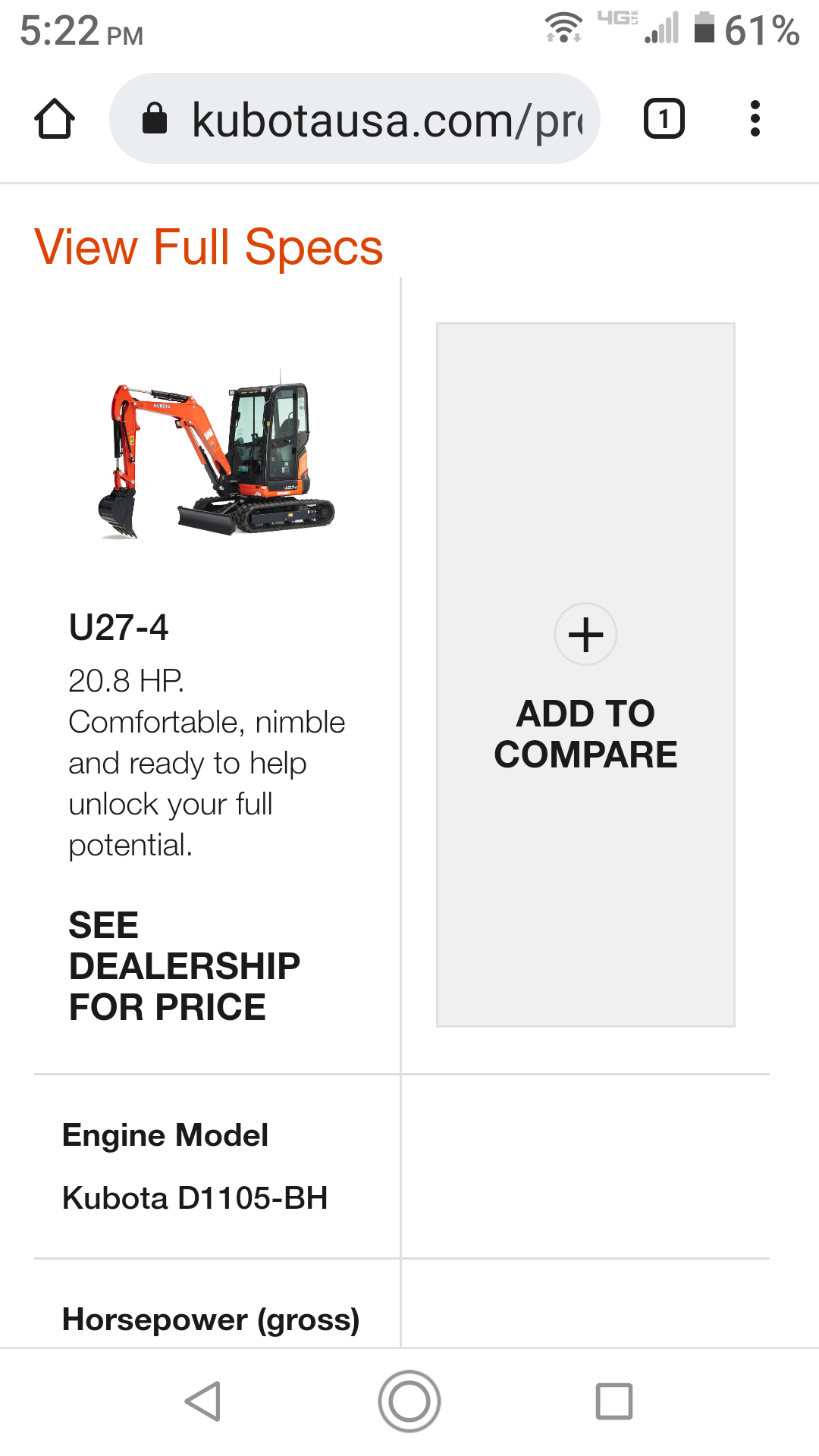

The big difference is weight and hydraulic flow between the 2, the u25 has more of everything 😂, why it's less I have no clue. Did you get a quote on the U27-4? I was quoted on the U25, U27 and the comparable kx series several years ago wasn't much difference in price between the minimal swing u models. If I didn't want higher auxiliary flow and still wanted new for a non commercial setting I probably would have settled for the new nortrac mini just for trenching and cutting a hill side they also have a lot of accessories. you can buy 2 nortracs and all the accessories you can ever want or need for the price of 1 Kubota or deer bone stock. With minimal tail swing on a JD 26 G I can lift and swing 1400 lbs if I'm aware and careful plus on jds anyway I can get a bigger counterweight if I feel I needed it which I don't, it would just reduce tail swing clearance it's bolted on with 2 bolts I believe. imo minis have a low center of gravity decent counter weight and using the blade helps a lot for stability when booming out even on the sides imo. If it was me choosing I'd get the u 25 or 27 model. Good luck.
