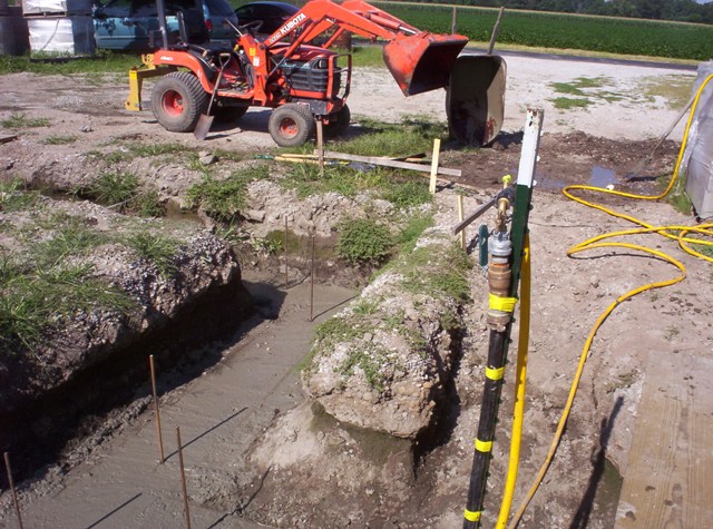

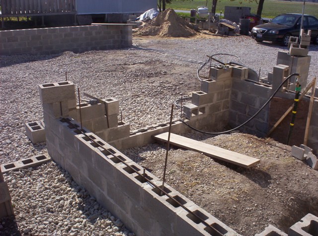

I think you answered your own question with your confidence level. Having said that can be done? - sure can. Do your homework and read up on local building codes and permits. I was fortunate in that there are very few regulations were I live. I built my 28X40 from below ground and up. Do alot of reading on some threads here. I bought an optical transit tripod and stick to make everything level. Be sure of your skill level when using a transit. Having fun is also a must.:)

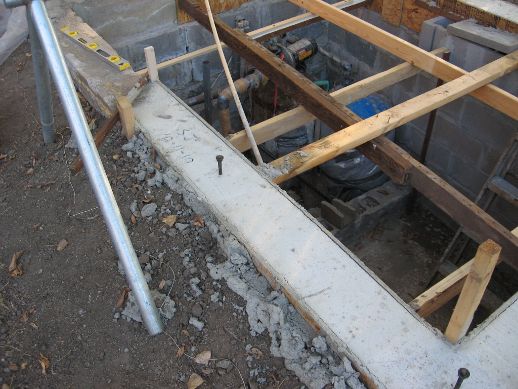

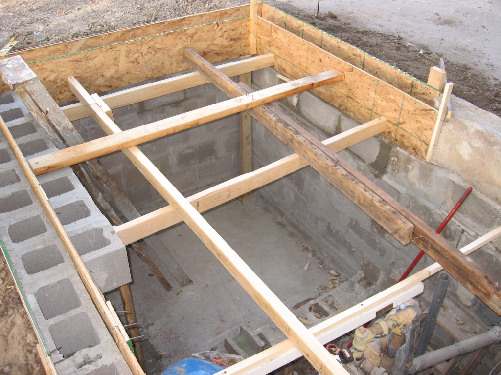

Here is a couple pics of a block wall/footing I did last year.
I had the cement truck dump grout in my bucket of my tractor and then carried it to the forms and carefully dumped into the forms it worked just fine.
The footing was level as can be even though the blocks were an inch off here and there is what I was talking about. hth :thumbsup:
