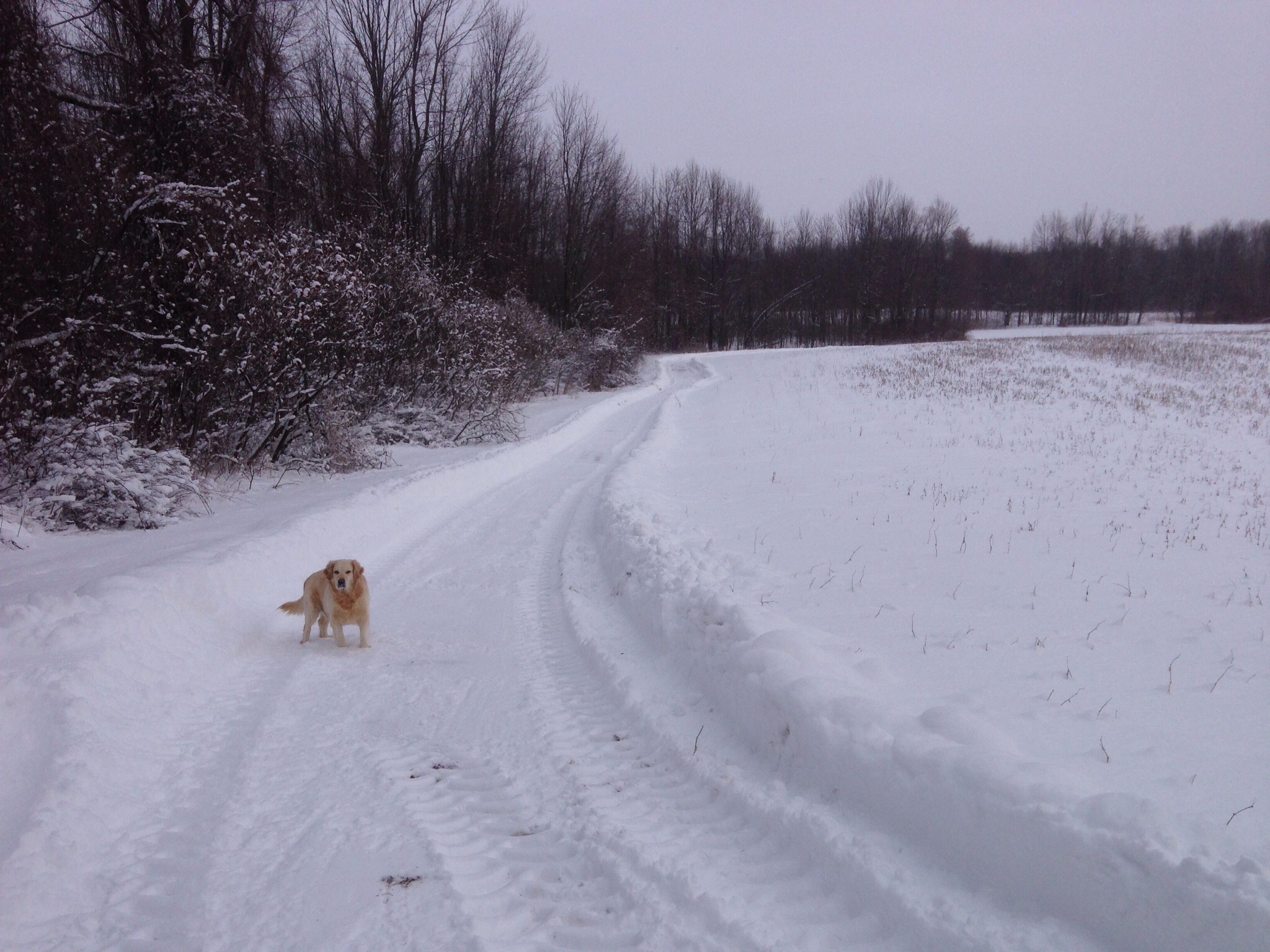

Also you need a snow plow. I go "off road" a lot in the winter and navigating 3 feet of snow on a regular basis will get you one thing for sure, and that's stuck. I plow miles of trails in the winter. Did I mention you should really get a cab? ��

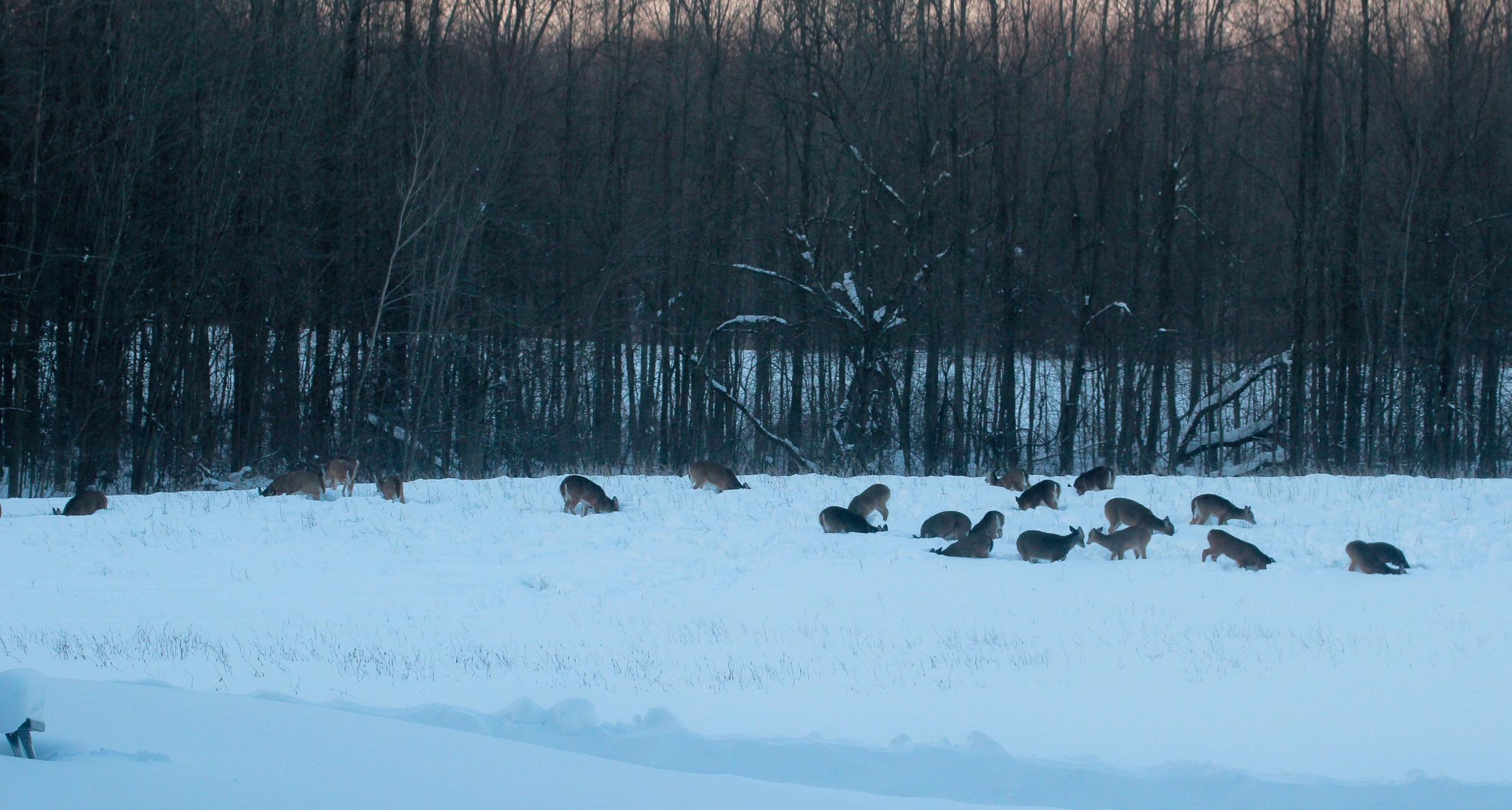

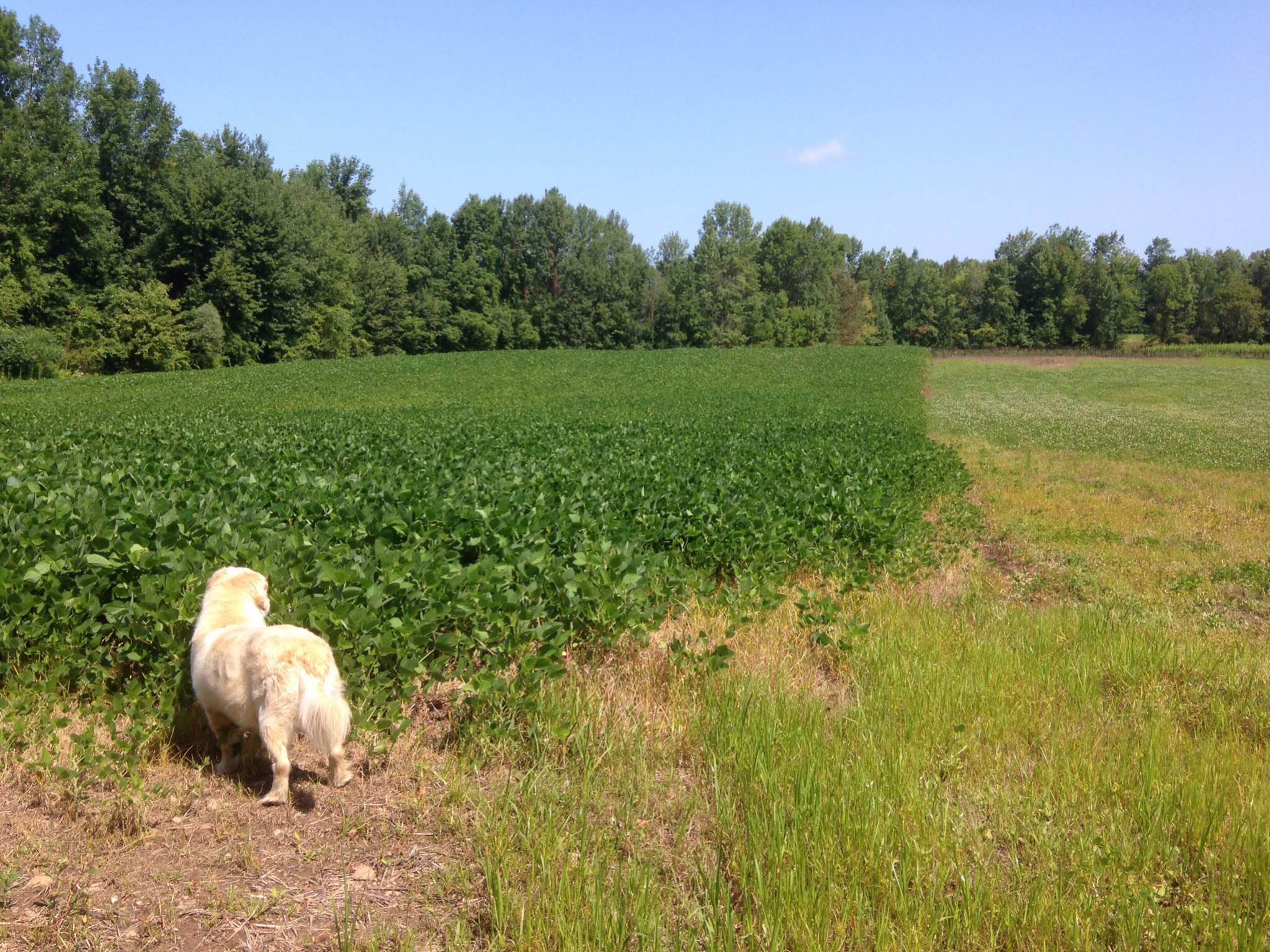

I plant about 20 acres of food plots a year, corn, soybeans, turnips, clover etc. Here is that same food plot I plow to in the above picture in the summer and about a month ago with 20+ deer in it.
Plowing, discing, and spraying round-up can be a dusty and hot plus who really wants to be breathing round-up? Who would want the comfort of an air conditioned filtered cab and who wants to make a three mile trip home in a downpour? Turn on the wipers and stereo and ride home with a huge grin on your face but turn down the air conditioning, it's getting a little chilly in here......
