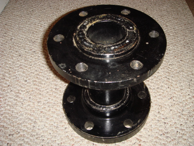

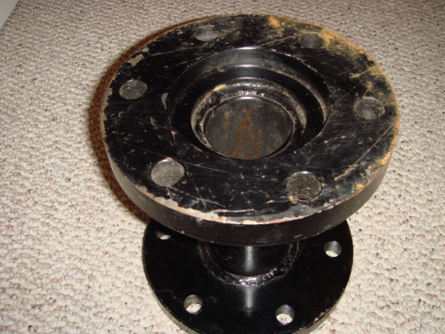

YM240D hub extensions:
Flanges are 6.855 across, .867 thick.
Hub is 6.905 wide, outside to outside (including flanges). Accuracy .001
Axle side hub is drilled, other threaded for lug nuts.
Axle side hub recessed to accomodate axle flange 3.716 x .564 deep.
Flange for rim, 3.721 x .289 high.
Inside diam of pipe 2.108
Outside diam of pipe 2.740
In my original parts book, this is part of the 'adjustable rear system' with a reference to it as a 'extension, rear shaft'. This leads me to believe that they were originally meant to increase wheel width rather than serve for dual rim setups.

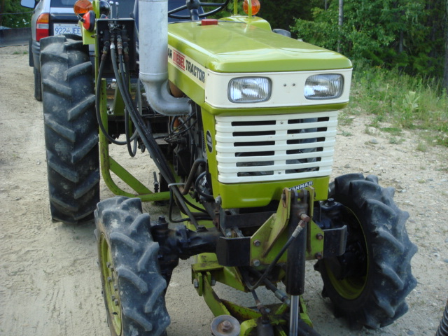

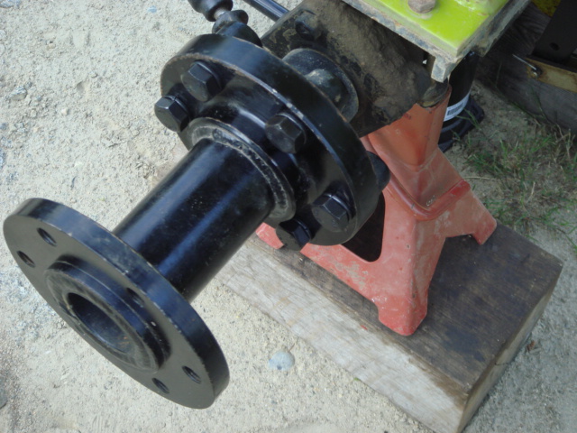

/ Newbee's first post: Duals for 2310D #18
I added the spacers on to my 240D. My rear tire width is now 5 feet outside to outside. It gives a nice stable look to the tractor, certainly better than original.
Added a few pictures for anyone who might be interested.

/ Newbee's first post: Duals for 2310D #19
Your 240D looks good! Thanks for posting the photos.
Here's another way to get 5 ft width. My 240 is 2wd so I don't need to worry about front/rear tire ratios, and it came with separate rim/disc rear wheel assemblies. A previous owner had put on 12.4x24 tires on the proper 11 inch rims, apparently off a Kubota. Overall width is right at 5 ft. The big tires carry more water ballast which is helpful for a 2wd.
http://www.tractorbynet.com/forums/...240-ym2000-pictures-842567-img_6482-ropsr.jpg
