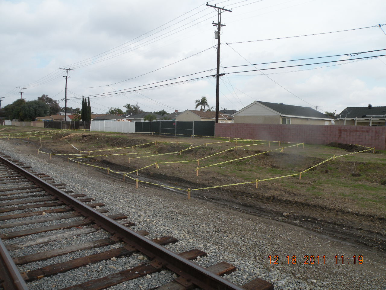

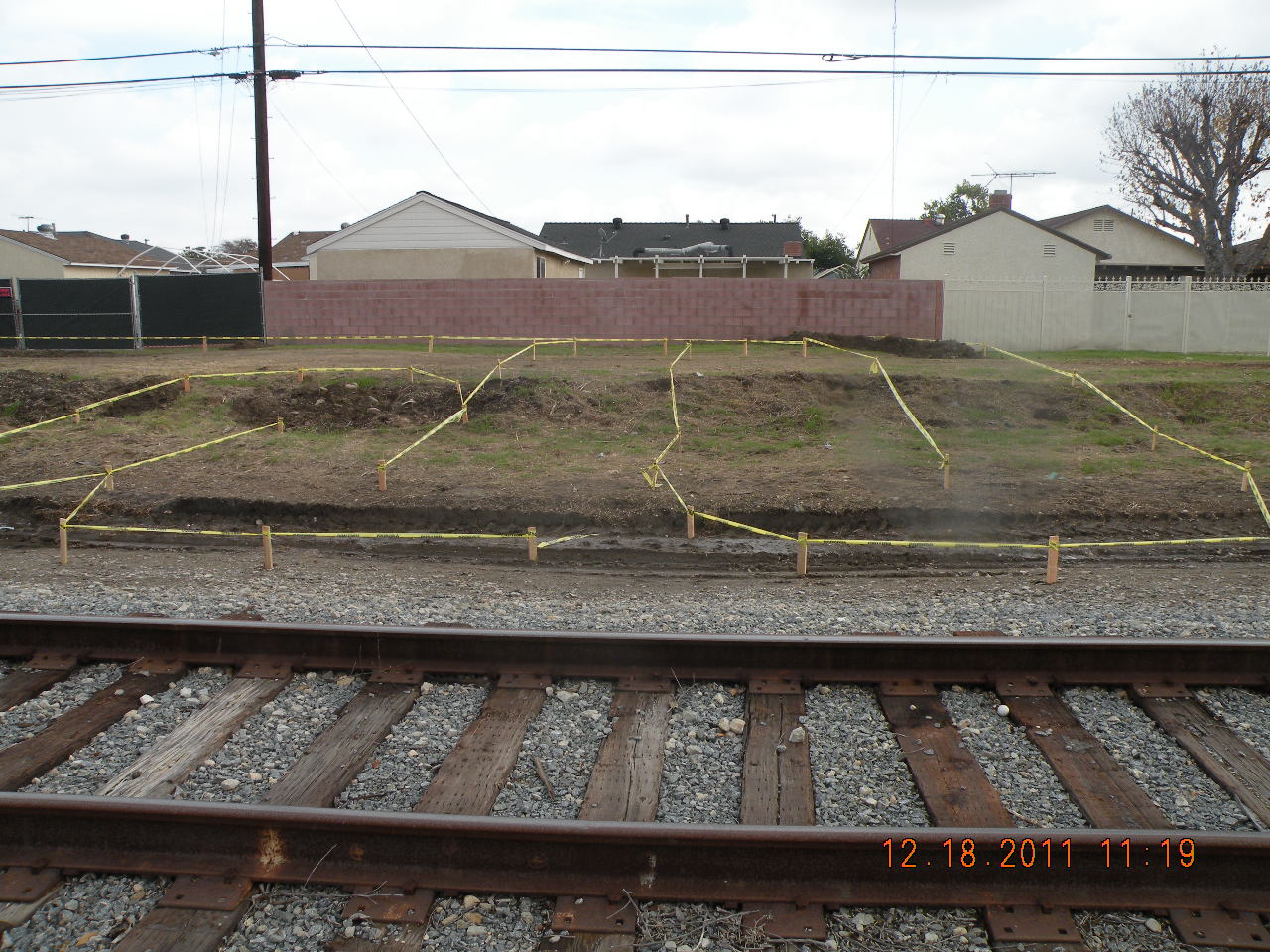

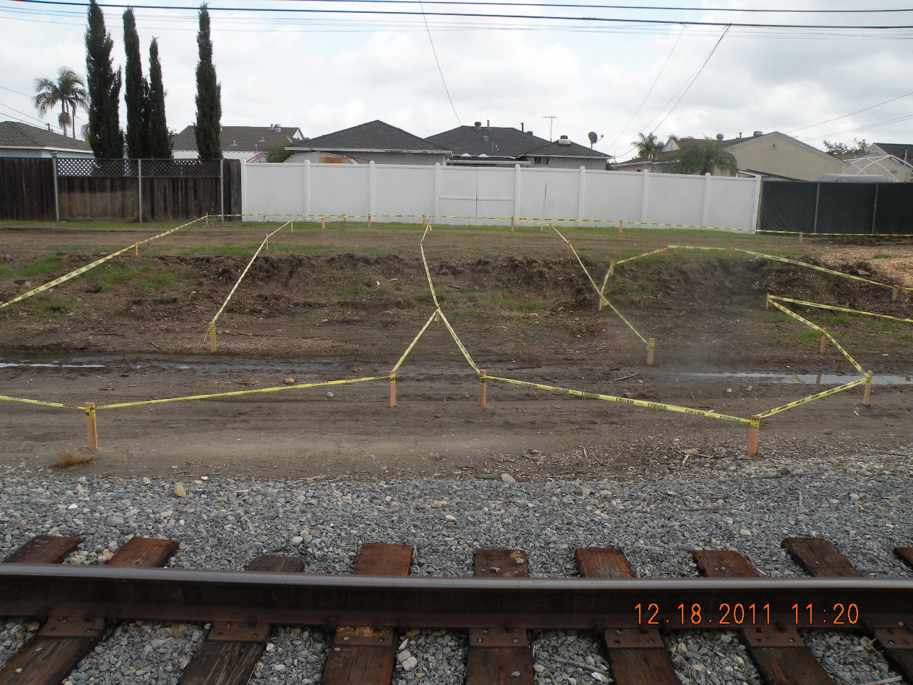

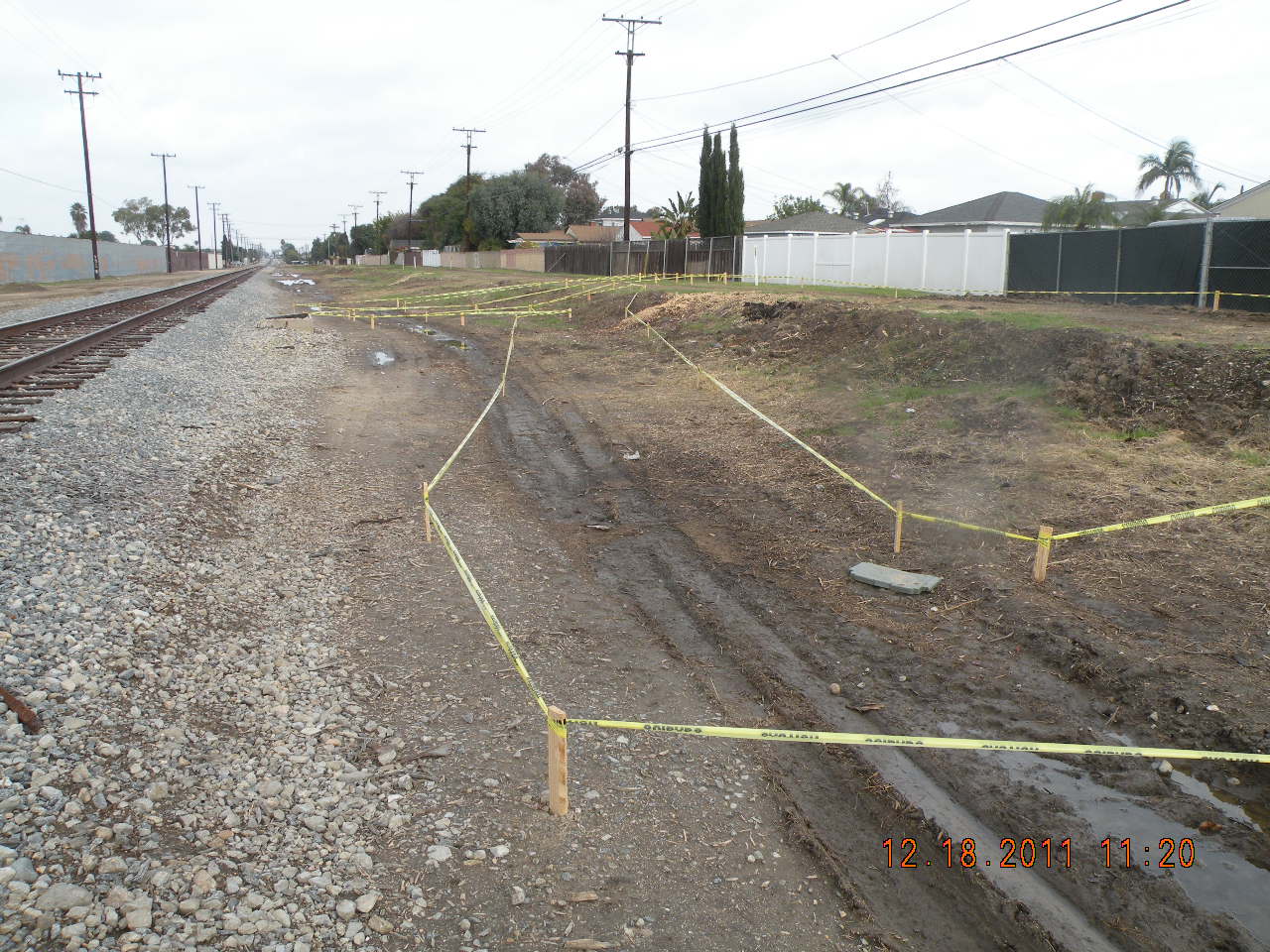

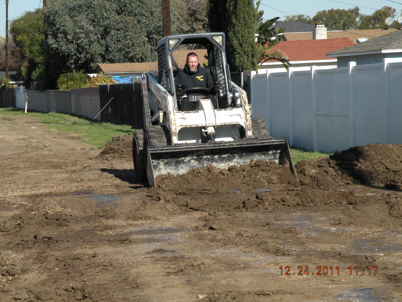

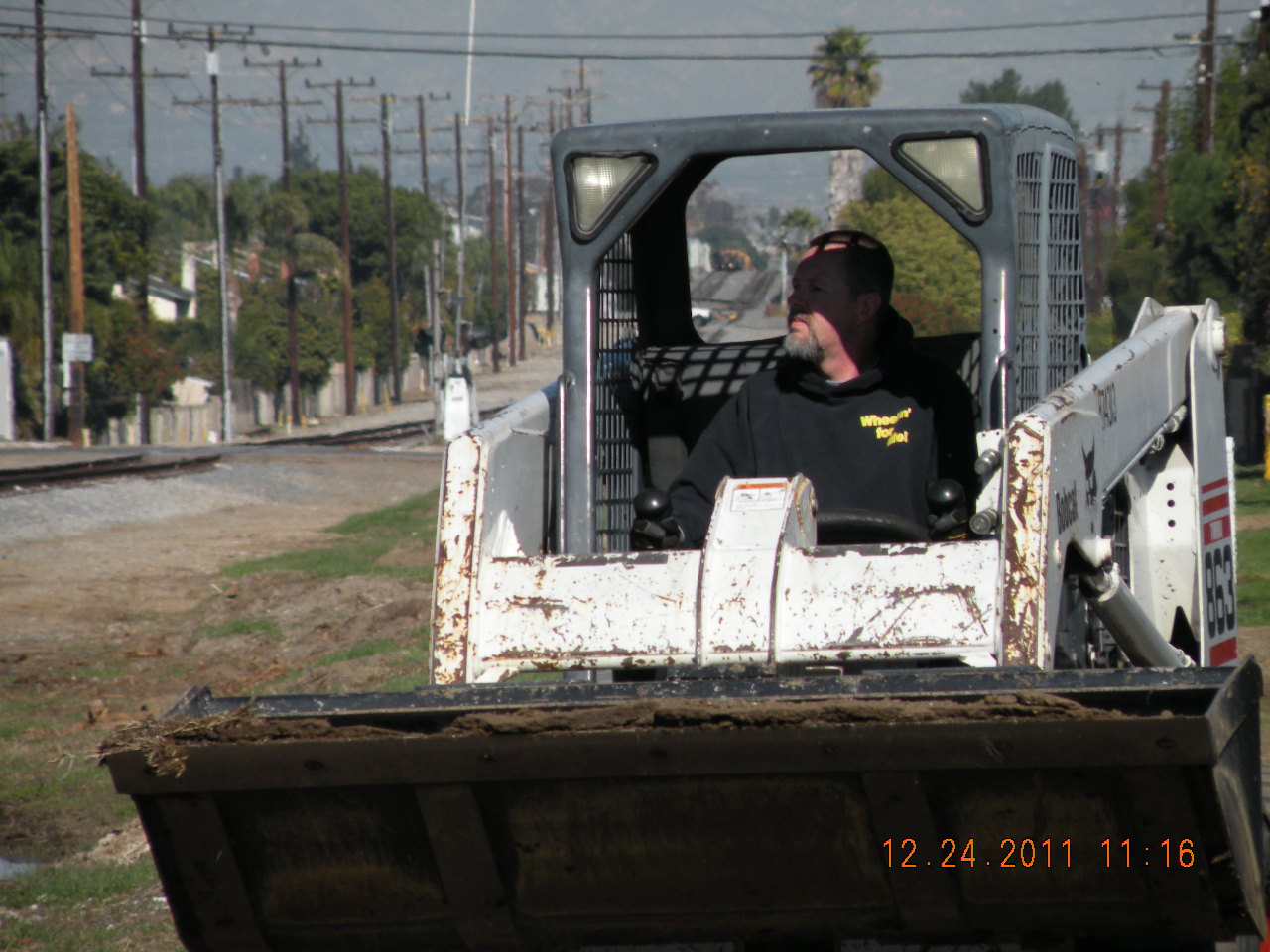

Here is the track layout. Will have 11 turns, main straight is 150ft long. Will have four jumps, or two sets of doubles @ 20 ft span jump to jump. I staked the track layout, and caution taped it off so I could see how the path went for gradding, digging and building, will only be dirt when I'm done. Track is from the far end of the White fence in the first pic to the far end of the pink brick wall, lots are 50' wide so track is 150' long X about 50 to 60 ft wide. Anywere from 7500 sq ft to 9k sq ft of track area.
From the fence out all the home owners still own 26' out past the fence line. I'm building down into the rail road area too, I know I know, will probably get in trouble for it but whatever, will run it till I do. The 26' area is an easement. There is oil pipeline underneath, company has the right to dig without notice I believe, But I own the land, I pay taxex on it.
I have the right to build gardens, horse shoe pits, whatever, just no structures. I will leave a lane 8' to 10' wide for other neighbors, and pipeline service trucks to drive down. Most neighbors do not use this access dirt road. Hardly ever see anyone drive down it, especially when it's been raining, gets rutted and really muddy. Perfect for a dirt bike, off roader like myself to play in the dirt in :D.

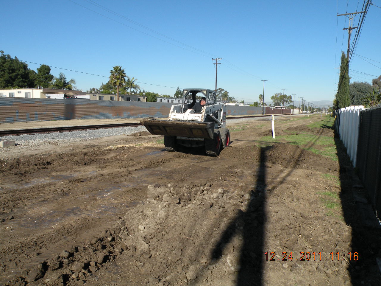

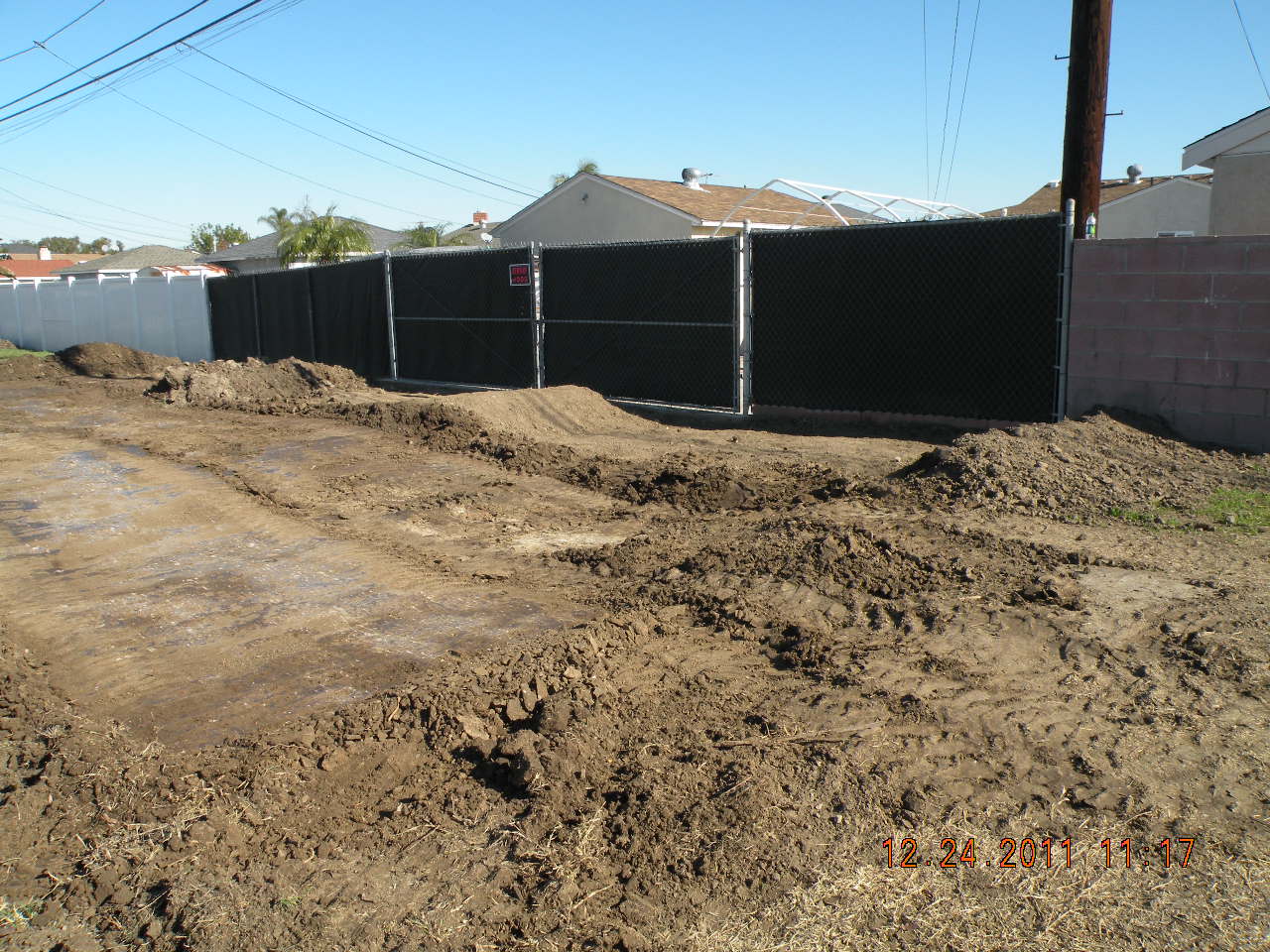

Few more pics. Played with the cat for about four hours so far. have time left to use it still. Have five friends with RC trucks coming Monday to help build the rest of the track.
