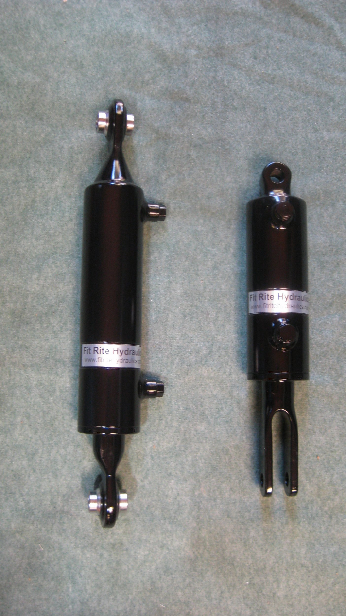

Get the 3rd rear remote kit I don't know if I would want any of the 3 rear remotes to be detent type, but most definitly not 2 detent valves. Unless LS has spring return to center detent valves, I defiantly would not want more than one, and that would be to supply the backhoe. If they now offer a float featured rear remote valve, that is different, they did not use to.
If you are primarily doing dirt work, you are going to want a full top & tilt set for the 3pt hitch. You will need to be able to angle the grading implements to both the left & right sides. You do not want to be doing that manually for any length of time. Like more than once. :rolleyes: :unsure:

  • Top and Tilt Kit - I have seen those and think it would be super cool. I would really like to get this if I can make it work. My concerns would be;
    • first is cost. I had planned on doing the hydraulic top link because it is probably really easy to add the cylinder and just connect it to a rear port. I expect the hydraulic top link adds a ton of value for very little investment when using a rear blade.
      • If the top and tilt kit is only a few hundred dollars more, like it appears in the link you shared, I think it would be very worth it. It appears that installing it would be easy. Is that right or am I missing something?
    • Second concern is the backhoe. When I was considering a MF machine I read on their backhoe spec sheet that the backhoe mount can't be installed along with a top and tilt kit. I don't know why they said it isn't compatible, but I just assumed that it wouldn't becompatible with the mount for any manufacturers backhoes?? If so, that would kind of be a show stopper for me. I don't want to have to remove the backhoe mount every time I want to use the grading equipment...
    • I had just planned to get off the machine and adjust the tilt by hand when needed, but it sounds from your statement that it might be a lot more work than I am thinking it would be...
    • Any ideas on how to work out if I can fit a top and tilt with the backhoe mount? I'm just going to say now that my dealer won't know one way of the other. Maybe he can call LS and get that info??
